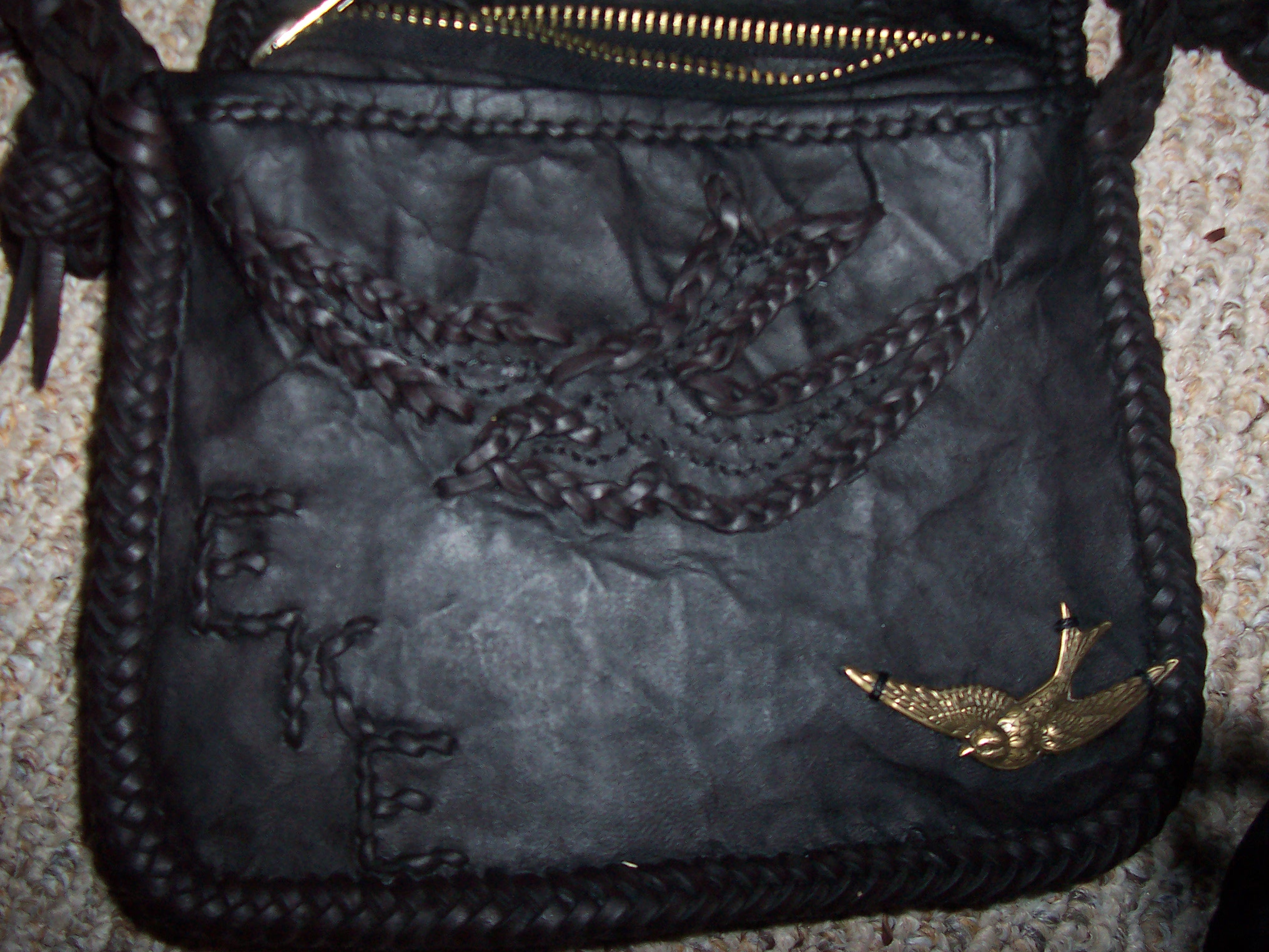

  4. []there is even a knife i made in the back. with braiding like this there are no limits if you can draw it you can braid it into leather have fun

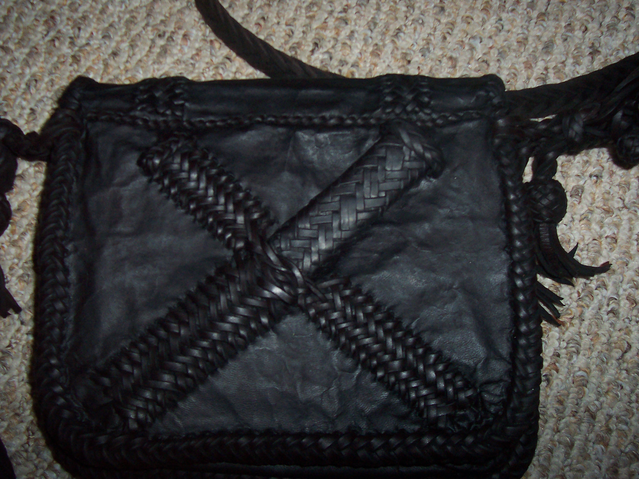

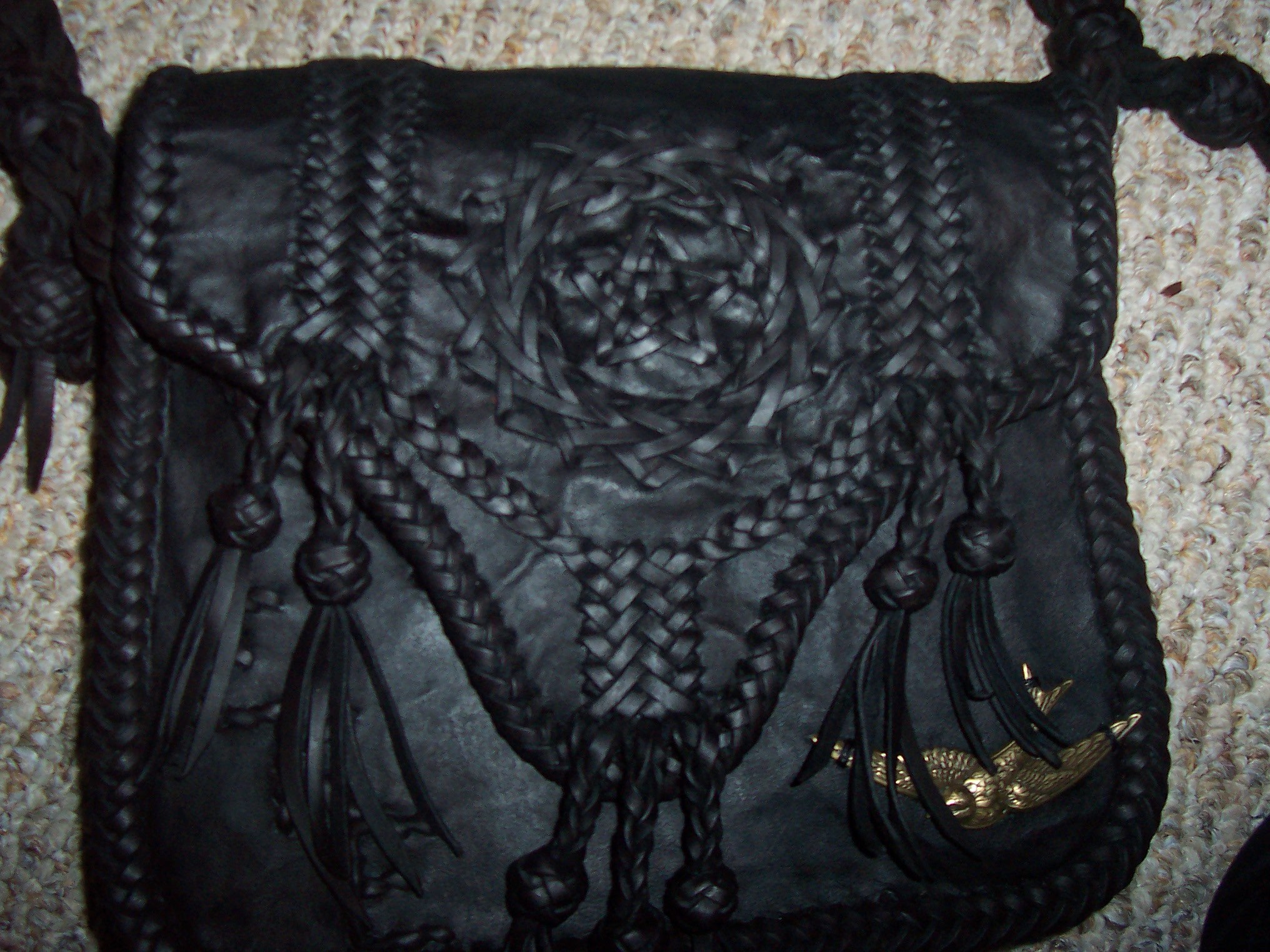

  5. here is a purse i made my girfriend. it has some stars and appliques might get u started anderson leather does a lot of the same kinda work u might check out there web site bj
