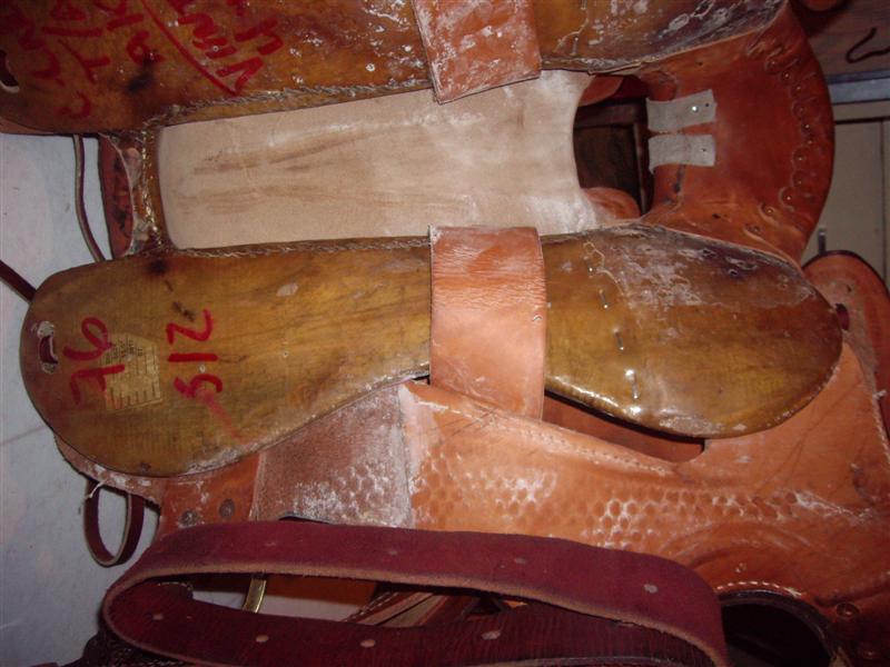

With you saying that and looking again at the pictures it makes sense about the stirrup leathers, the indent on the skirts is very noticeable. When I fit this on the horses I'll try with stirrups in and with them out and see what kind of difference there is. The front rigging is right where the skirt has a half moon cut out on it, on the tree you can see where the rigging is still attached to the tree. Thanks for now though very helpful! Kronic
Hi Rod and Denise I didn't know you were on here. I know a couple of guys that get trees from you and really like your work. The tree does have a cut out for the stirrup leathers, mind you it might not be enough. I don't think it would be the strings coming through, the area that is affected at the back is in front of this. I am going to take everything you mentioned into account and keep a close eye on those. I'm going to have to wait until the horses start loosing some winter hair though, with the cold winter we've had the coats are pretty thick right now. Kronic

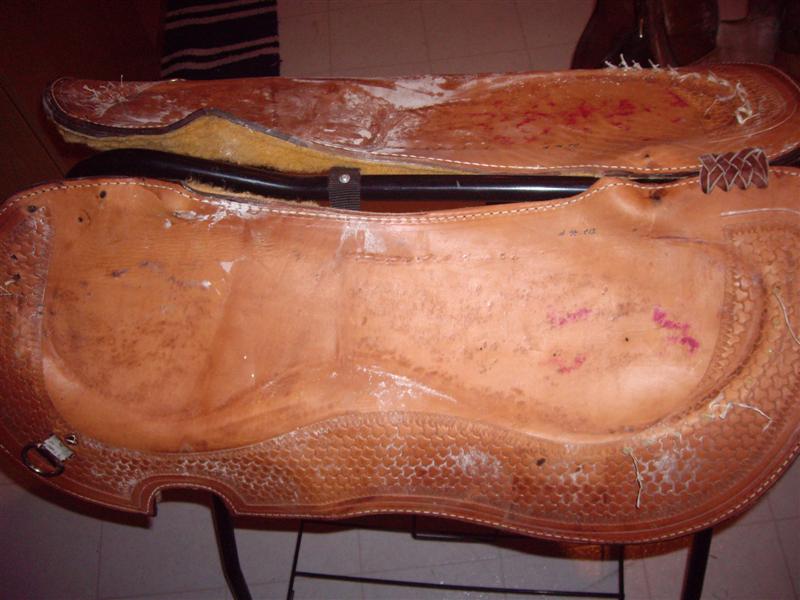

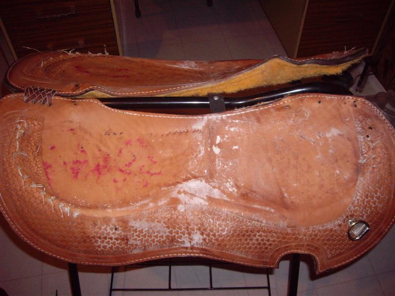

]Here are some pics of the tree from the under side: At the front of the paddle on the bottom of the tree there is about a 1-1-1/2" spot where there is a high pressure/rub area. The white stuff is just baby powder from trying to keep the saddle a little quieter. Kronic
So I purchased a saddle from a shop here in Alberta, it is a Texas Saddle Co. brand, built not to badly built. I did have to make a few modifications to it already. But after using it last summer a lot I noticed there are some hotspots that appear not matter which horse I put it one. The broader horses aren't as bad but the younger ones get heated up pretty good. The hotspots are right on the withers on each side and also at the rear of the tree just in front of the kidneys. Also when I pull the cinch tight the rear of the saddle lifts up a lot from the horses back. So I have so far torn into the under side of my saddle and have the bare tree to work with. Once it starts getting warmer and our horses lose the winter coat I'll fit the saddle and do the blocking as required. I'll try and post pics later. Kronic
