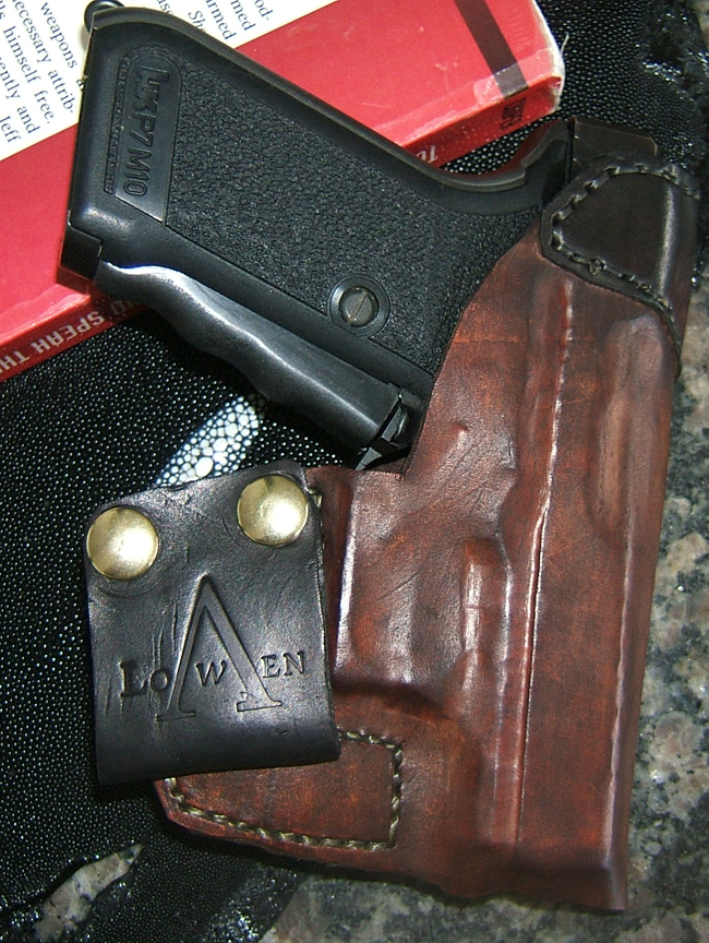

  12. Heres a pic of a holster I made with fiebings cordovan color. If your looking for a color reference there you go. I did a blend with black so the cordovan is obviously the red portion.
