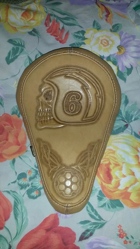

  11. thanks :D not finished so no color
  12. with seam
  13. last seat for honda :D

  21. what do you think?
