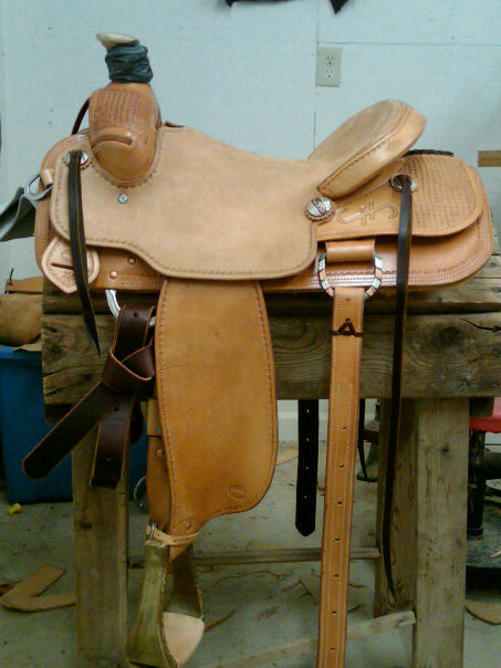

New To The Forum And Looking For Feedback-
roperdad replied to roperdad's topic in Saddle & Tack Maker Gallery
Keith- Thank you for your timely respone. Greater attentinon to detail and patience will cure a couple of the problems with my work you have pointed out. There are a couple comments I'd like clarification on, if you would indulge me? In order: 1) By "longer" do you mean horizontally? By "deeper" vertically? 2) I see that clearly now that you have pointed it out and I've looked at pictures of other's work. 3) Should I shape them more wet to cure that? 4) Noted and cured for next time. 5) Ditto #4 6) I struggle badly with the cantle binding. I lack confidence here. Any suggestions you may have would be greatly appreciated. 7) Ditto #4 8) Patience and attention to detail, huh? Not my strong suits. But I can do that. 9) A wood block and sandpaper? By more round do you mean a larger radius corner, or will using the block and smoothing the transitions be enough? 10) I always panic that the leather is going to dry out before I finish. Sounds like I need to experiment here with how dry I can tool the leather. And again, patience and attention to detail. The first time I read your post, I wondered if I should put my tools up for sale. Then I re-read them and compared our work to other's and can see why you bring out the points you do. I have a tree on the table. You've helped me raise the bar I have to clear for the next one. I'm going to print this off and tack it over my bench. roo4u- Your suggestion about looking at the pic's of others is dead on. Having done that I see what you mean by balance and proportion. Thanks to you both. Clay -
I really do like looking at your saddles. They have the 'look' I strive to achieve. Useful and classy at the same time. The Will James tree is favorite of mine, but I can't get many people to stretch past the Assoc/Mod Assoc stuff up here. We slip in a Wade here and there, but the swell forks are bread and butter in the Norther Plains. I notice most of your saddles have the exposed leathers... Personal preference? If so, tell me why? I've not ridden one and haven't been asked to make one, but we all so things for a reason- Thanks, Clay
Hello to all- I just found this forum in the last couple of days and really enjoy what I've seen here so far. My Dad and I have made quite a few saddles now as a hobby/part-time job. Seeing the work and reading the critiques offered has been very enlightening for me. I'd appreciate you eyeballing what I've put up here and being honest. I've seen some honest criticism on here, and really appreciate the courage it takes to both offer and learn from it. Functionally I know our work is solid. I'm now working on the aesthetic side of it. Trips to the Sheridan Leather Show and seeing Mr. Seidel's work, along with Don Butler, King's, etc... always offers a humbling and challenging experience. I'm proud to say many of our saddles are ridden daily in WY, MT and SD by working cowboys. That is my goal and the best compliment we can receive. Now I want to make them look better doing it! Thanks in advance for your thoughts, suggestions and criticism- Clay
