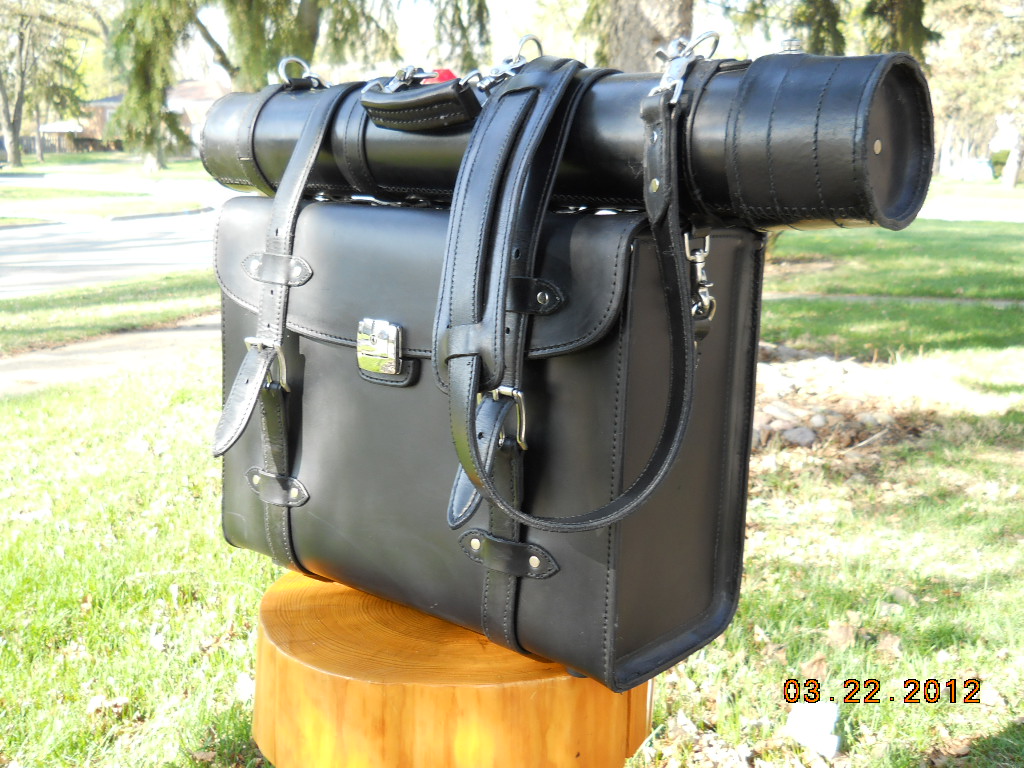

Ever Made A Lawyer's Briefcase?
wnkleather replied to ramrod's topic in Satchels, Luggage and Briefcases
LDPE is from McMaster Carr, a big supply house. It's only 5mi from me so I can pick up - not sure about shipping $. Lining is 1.5oz pig suede. I call bag a 'Carry All' because I made an 'office liner' to fit inside. When I'm done with work I lift out office = empty bag. Drop in 'range liner' - holds 6 handguns, magazines, ammo, glasses, earmuffs, etc. Done at range, pull range liner and drop in insulated waterproof 'cooler liner' and go party. Monday morning drop in office liner. Liners add weight but I'm mot carrying bag for any distance. When I get old I'll put wheels on it. Make sure your d-rings and hangers are STRONG. If you don't have one get a copy of 'The Art of Making Leather Cases' Vol 2. FULL of ideas how to not waste time and leather. I've also shamelessly stolen ideas from many excellent bag makers on this forum - thanks to all. I admit bag is larger than most require - damn near a suitcase - but if I can't carry my office on my bike, boss won't let me ride to work!! -

I could not find a frame for the size I was making so I bought a 4'x8' sheet of .060" (1/16") low density polyethylene (ldpe) for $35. It is great for thermoforming. I WARMED a piece of the size I needed for bag and molded around wood form. Practice on some small pieces - 175 deg F is good. Glue and sew between bag and liner - an awesome stiffener - makes 6oz bridle like 12oz skirting. My design may differ because I needed to account for rain as I use bag as mobile office complete w/laptop and strap it to my motorcycle. I also need to carry blueprints hence the 'roll bag' on top. Bag is 8"W x 20" L x 14"H. All the hardware is stainless or nickle/brass.
