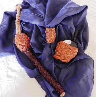

The 16 strand u2 o2 u2 o2 is to the point where the core has tapered down in size. It looks bad now that the core is smaller. I tried tucking in the back 4 strands (2 on left, 2 on right) leaving a 12 strand with an o2 u2 o2 seq. and it looked bad in back. Would someone tell me how to transition to fewer strands from a 16 strand. My core is about 1/2 the size it was. When I started the circ. was 1.25". I'm working on a quirt. Thanks.
This makes perfect sense. The 16 strand braid is working out very well. I've just gotten to the part where the core tapers down in size, but I've not reduced the strands. It still looks good. I've not found a way to bury strands in the core and still have it look good. Should I just continue all the way w/16 strands? Thank you for the tips.
OK, I'm going to bury the extra strands in the core. I stuck every other strand in the core and continued with u2 o2 (8 strands), but it looked really bad at the transition. Whats the best sequence/way to taper down? Thanks.
Sorry if I missed this explanation posted somewhere. Could somebody tell me how to taper down a braid on 16 strand quirt? When the core gets reduced to 1/2 size do I reduce my braid by 1/2 (every other strand) and have those "whiskers" sticking out? I'm not sure what they're called. Or, should I just continue braid w/all strands. Thank you.
Yes, I was using Grant's formula. Going to try 1.5X. Thank you for that tip.

I'm building a quirt and trying to figure out how many/what size strands to go with. I've got a ton of 1/8" roo. The core circumference is 1.25" so if I went with 1/8" lace, I figured that would be 15 strand braid. If I go with that, what is the sequence? I've not braided more than 8 strands. The other option is cut wider lace to make 8 strands work. Please let me know what you think. Also if someone could tell me how to do 15 strand braid that would be helpful. Thank you.
Does anyone have tips for getting a round braid even all the way around? I'm working on a quirt and the back is "spread out" more than the front. When I was practicing the braid was more even. Not sure what I'm doing wrong now that I'm building something. It's an 8-strand.
