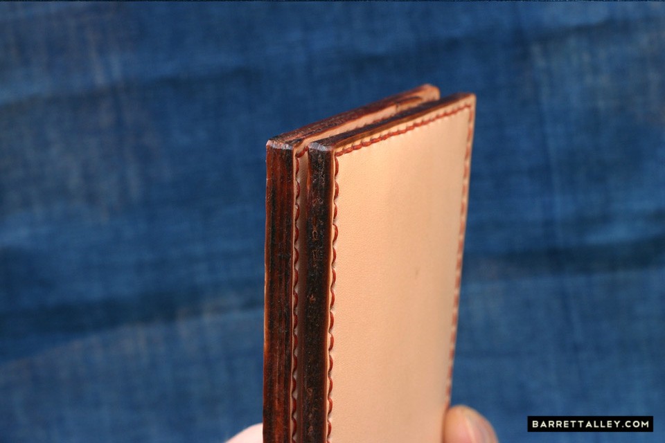

I know this is an often covered topic here, but how do you reckon this guy gets these edges so dark? His site just says edged with beeswax, but I've never gotten my edges to look like that with just beeswax (or ever for that matter). If you look closely, his edges are that dark even on the single layer pieces that look to be only around 4 oz thick (which is tough to do since it gets floppy). My only guess is that he's got some edging machine like the Fantastic Edge Burnisher or the Weaver one but I've never used one or even really seen good pictures of what these machines do so I'm not sure. I feel like I've got the whole stitching part down fairly well and edge finishing is my next frontier to perfect. Thoughts? His site, just for due credit: http://barrettalley.com/devilish-wallet-natural-leather.html
