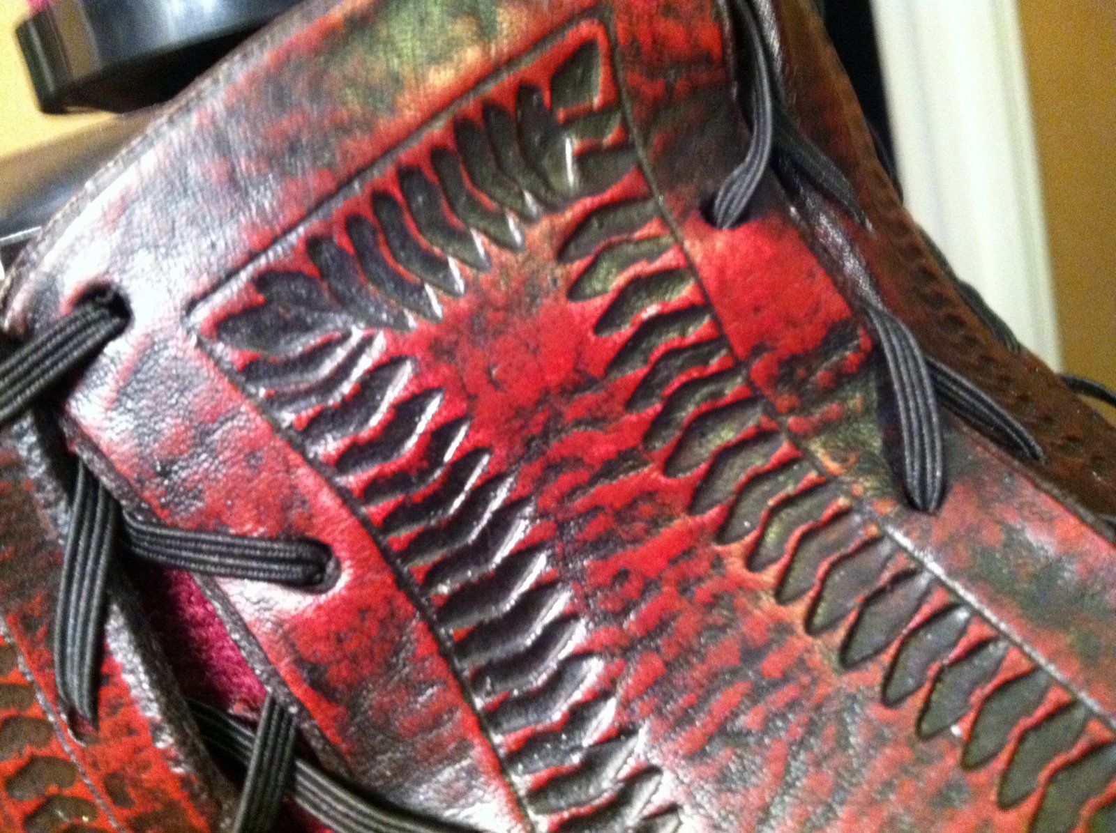

I need something more stable than the traditional Fiebing's paste when it comes to moisture/water. I've looked online and can't find anything yet. I've tried all sorts of various antique's but they are all water based and not stable enough. Is there any such product? I have a lady over in New Zealand who makes costumes for TV shows and she uses an oil based antique and she can use that as the final layer and water just beads off the product. Thanks, Alicia

I have a leather corset I bought that I am trying to replicate. It was moulded in beeswax and I'm trying to figure out the technique that was used. I have the base red color matched very close (angelus paint), and I know that black antique finish was used as well (not fiebing's, this corset was made in new zealand and they dont use fiebings). My fiebings antique finish is not very compatible with the beeswax/parrafin. If left in the wax too long it starts to float off the leather. When I buff the leather afterwards to remove scratches, the antique is somewhat rubbed off. Should I try acrylic resolene as a sealant before I dip onto the wax? Here is what I'm trying to replicate: http://i628.photobucket.com/albums/uu8/Odahia/007.jpg http://i628.photobucket.com/albums/uu8/Odahia/010.jpg http://i628.photobucket.com/albums/uu8/Odahia/011.jpg Here is my first attempt dipping in beeswax: http://i628.photobucket.com/albums/uu8/Odahia/009.jpg http://i628.photobucket.com/albums/uu8/Odahia/008.jpg I pretty much have one shot to get it right. The wax must be hot enough to infuse the leather and make a thin surface layer. If it's too cold it wont infuse, and makes a thick surface layer which is a pain to remove and ruins the color. I used a rough washcloth to buff the scratches out and a soft tshirt to polish. I would like some advice on refining my technique to match the corset that I have, and what I could do to preserve the antique finish underneath. Thank you . Alicia

I've been trying to replicate some leather armor I have that was not made by me. It is red (looks tomato or brick red) with black antique finish but I'm assuming more products were used to achieve the look. The only dye that comes close to looking like the red is Eco Flo Cranberry red. The Fiebings red has too much pink. Same with the Oxblood. Also I can't get the antique finish to stay in the tooling. When I wipe the finish off with a cloth everything wipes off and doesn't accumulate in the tooling. My attempts are on the scrap leather, using EcoFlo cranberry red and Fiebings red dye, with both acrylic black leather stain and fiebings antique black finish. I have some red Pro Oil dye arriving in the mail soon which I'm going to try. It doesn't seem like the dye + finish was all that was used to create this look. I'm fairly new to leatherworking and don't have all the dyes and finishes I'd like because I'm not sure what to buy. If anyone could suggest any products or maybe even any suggestions on what to try/experiment to get this finish looking like the pictures that's be great! Thanks in advance.
