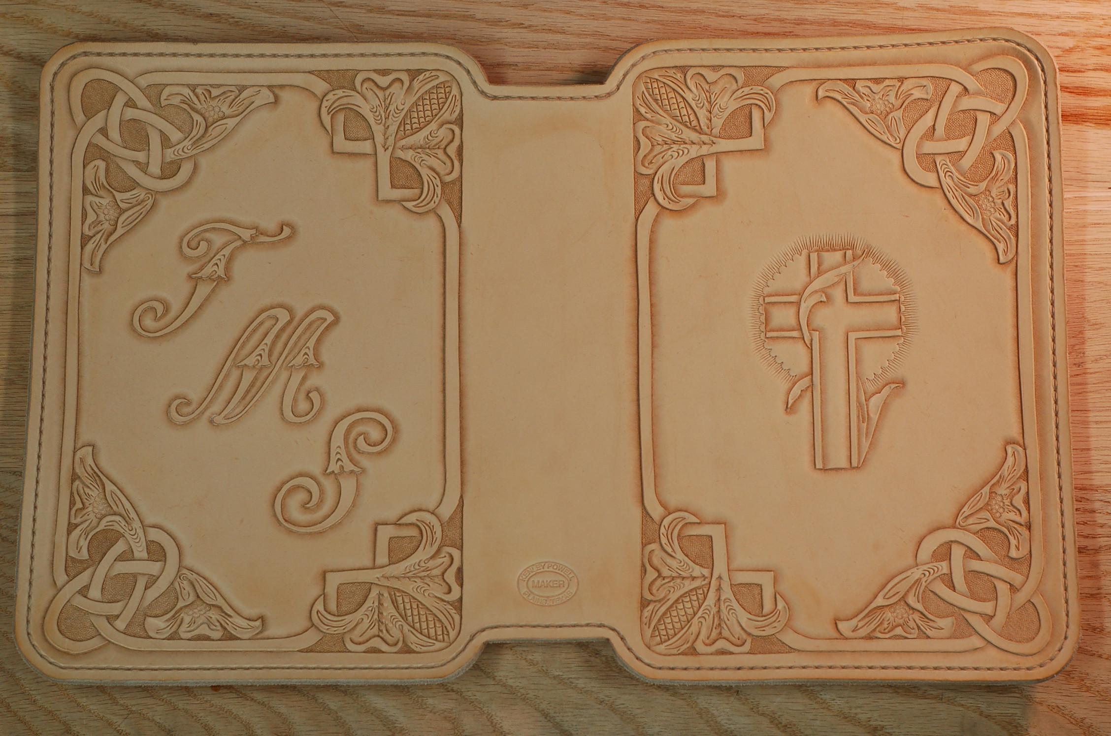

  3. This is a Bible cover I built this past Christmas. Maybe by Christmas this year I will have practiced more!! attachment=49764:DSC_0001.JPG]
