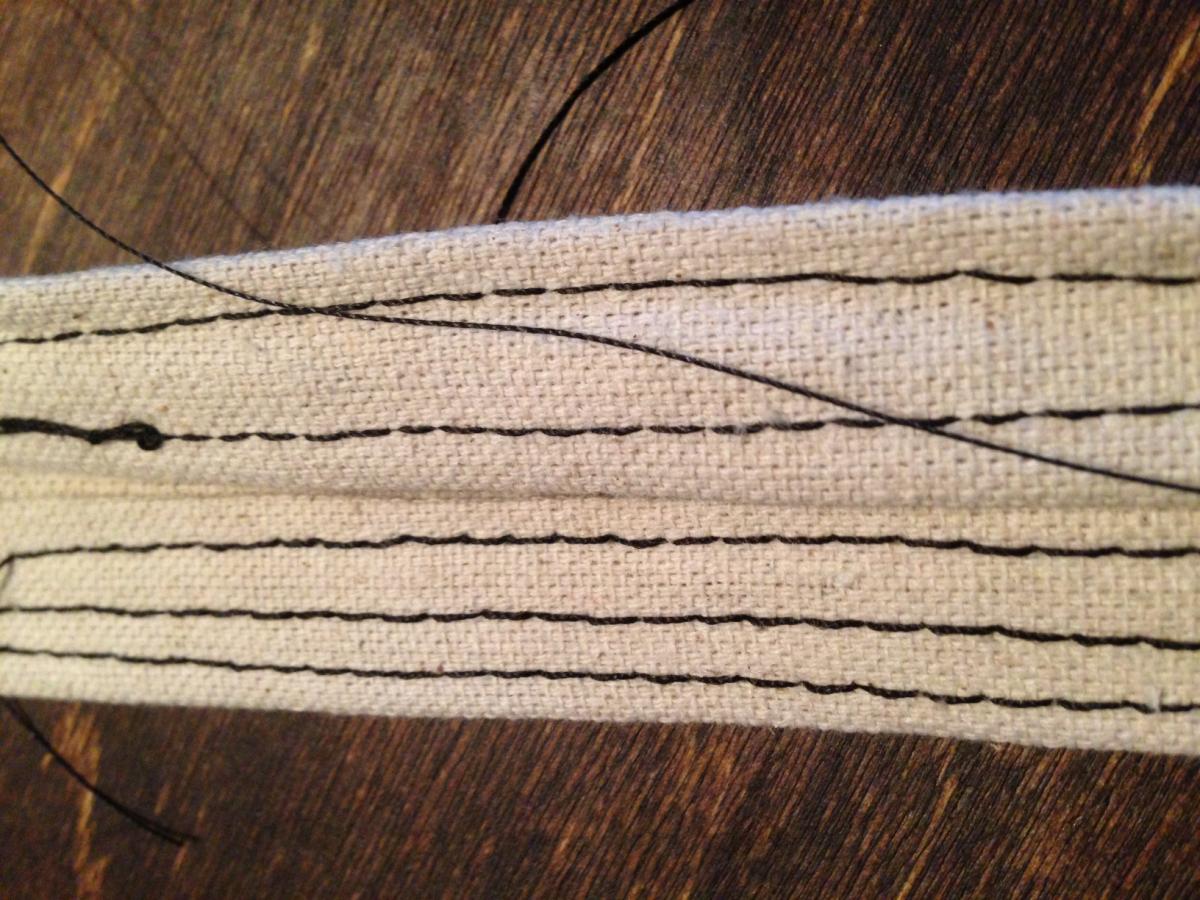

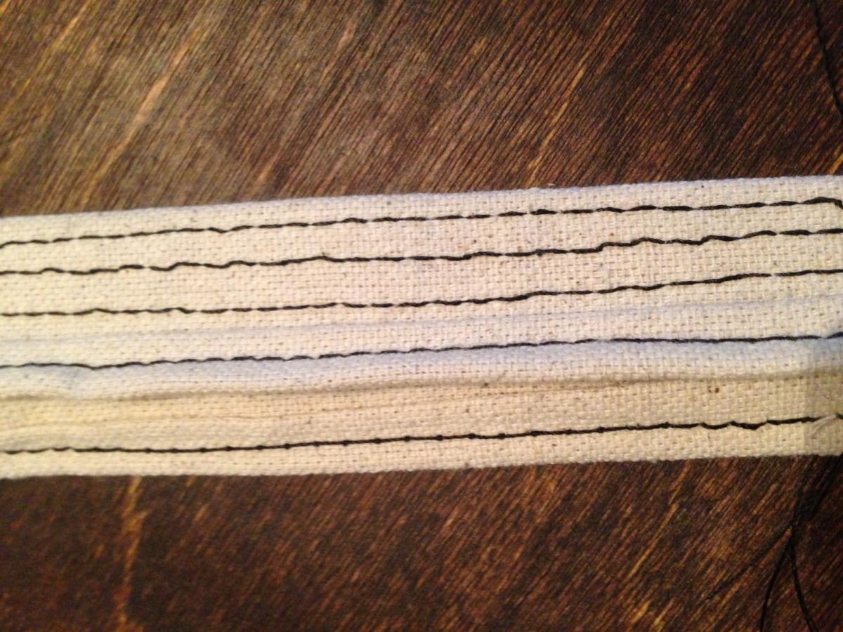

The stitching on my consew is a bit jumpy and looks a bit like a long line. My lower bobbin tension is as tight as it gets. I am also wondering if I need a longer stitch for heavy canvas and leather?

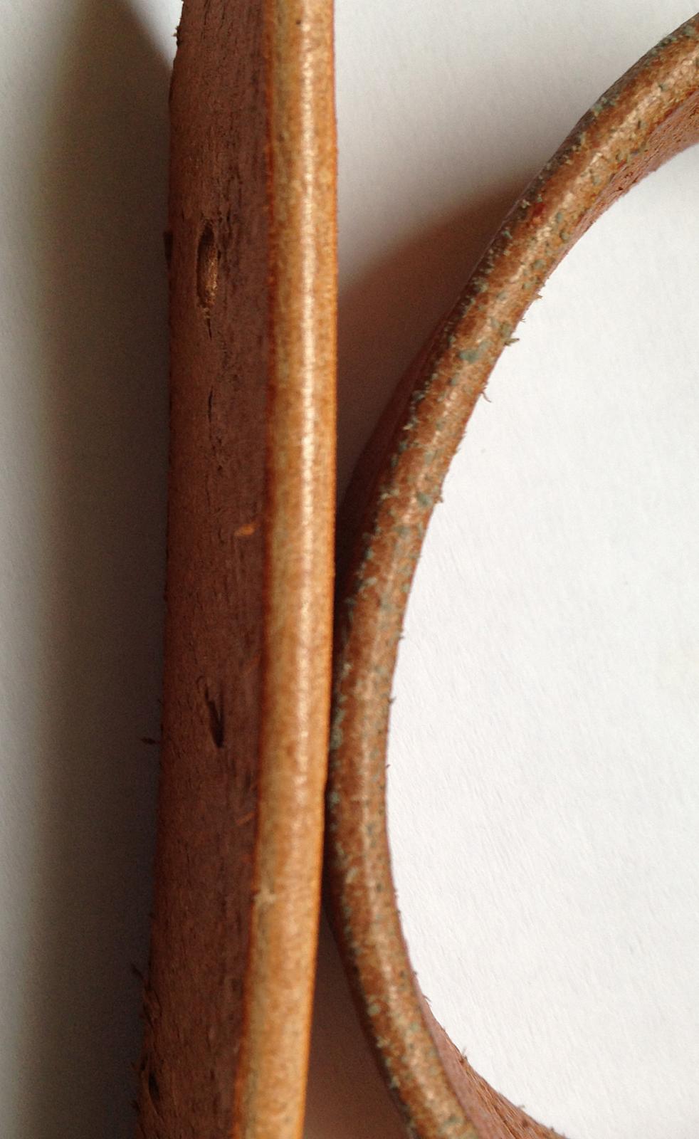

Bracelets and key rings. It's not exact as I don't have some of the tools he has. and I flip the sand and edging since i sand by hand. I have a dremel with the cocobolo burnisher i am using. and the polishing i do by hand. and I have used beeswax over paraffin. I am not looking for a super gloss edge like bob's but I would like it to stay smooth in wear and tear. I figure i am not burnishing enough or I need to lacquer it?
I have burnished the edges following the Bob Parks method, minus any dyeing or Neat lac. But as you can see from the photo the wear of the edges is just dreadful. It gets really dirty and frays. Is the Neat lac going to solve this? or is it Clear lac or Wyoshene now? What is this stuff? I always got the impression it was like a plastic coating so I didn't want to use. It seems alot of people are burnishing and not using this stuff or they don't speak of it, or am I not burnishing enough to hold the edge. any help is much appreciated.
