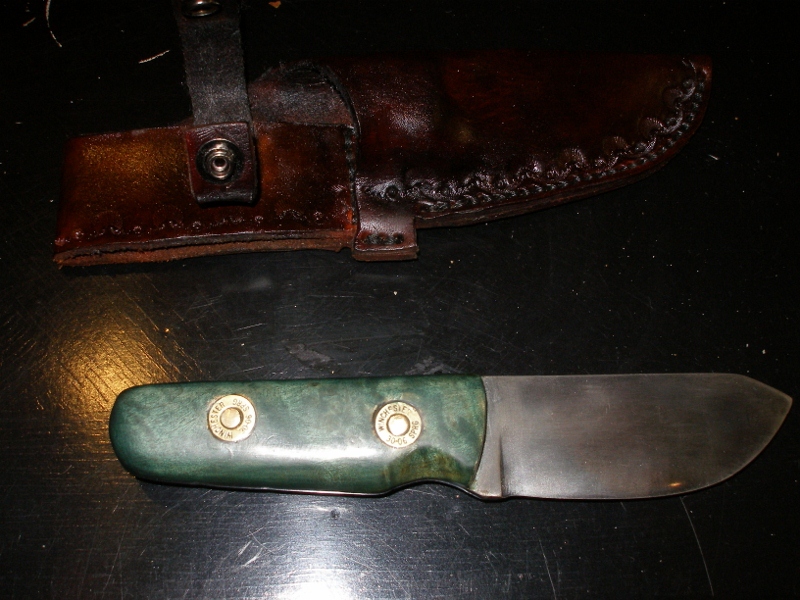

  7. Hey guys. This is a knife i made a few years ago. I wanted a new skinning knife and couldnt find one I liked, so I ended up making this one. I think it took almost 60 hours total. I used d2 tool steel and burl maple for the handle. I blued the blade and dyed the handle green to get the camo effect. The primers for the 30-06 round serve as the pins holding the handle on. The actual rounds are inlayed around the pins. Anyways the reason Im posting this is because it was the first time I did anything with leather. Since it was a custom knife I couldnt just get a sheath for it so I had to construct one. I wet molded it around the knife and did a simple tooling pattern. All in all Im pretty happy with it. Ive skinned a few deer with it so far and the sheath is still as good as the day i made it. Not pretty but funtional. Thanks for looking.....Dan
  8. Thanks for looking Mike. I agree with you. These things do tend to creep forward. Do you have any suggestions as a way to fix this? Thanks again...Dan

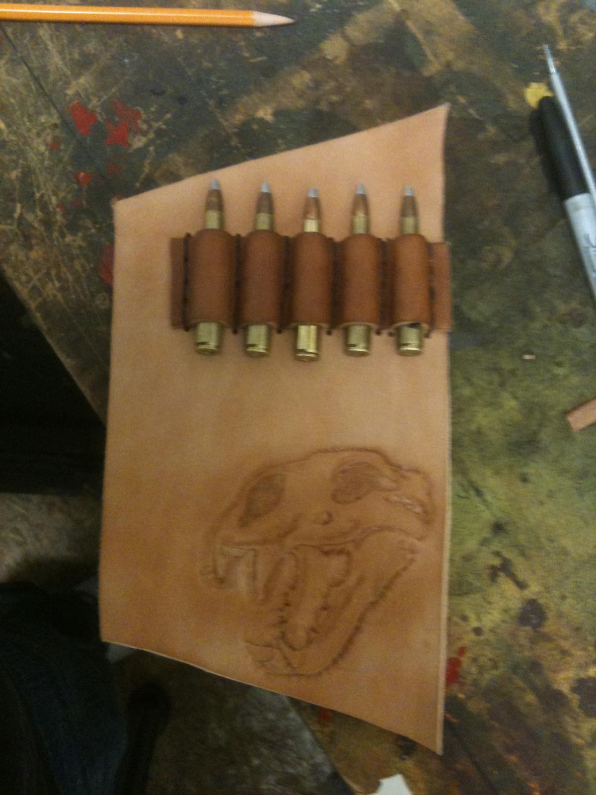

  11. Just wanted to put pics up of my buttstock shell holder. I wet formed and stiched the shell loops. Didnt do anything to the edge. The tooling is of a bear skull. let me know what you think.
