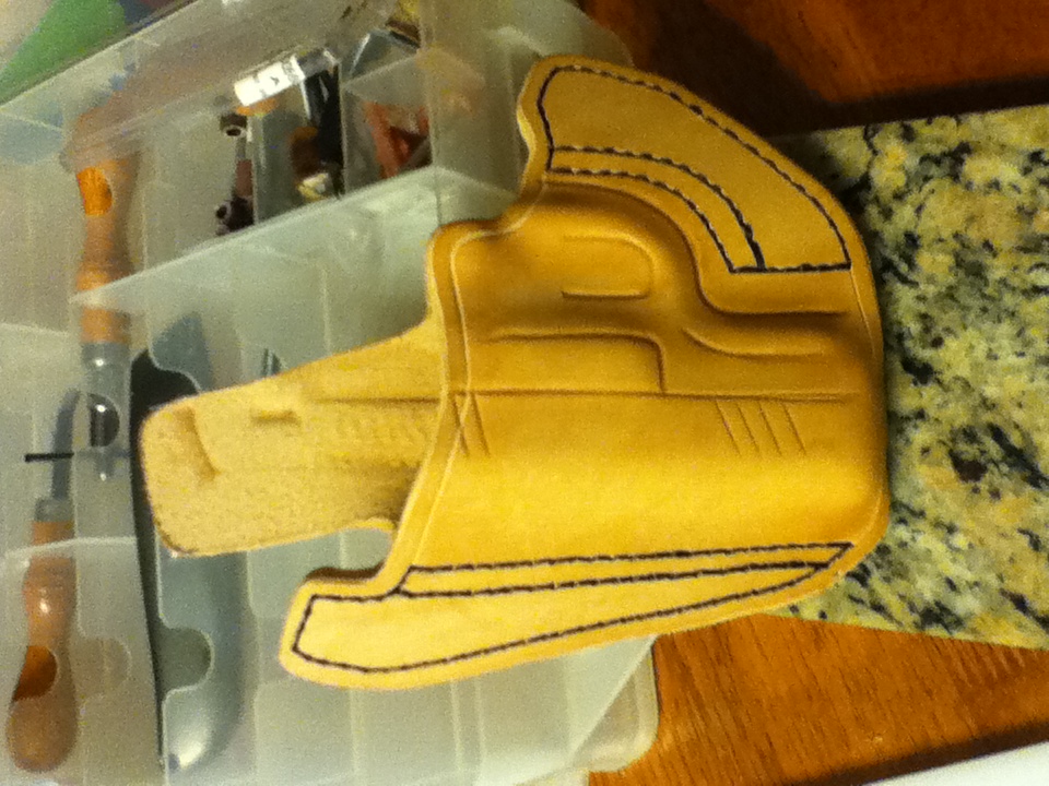

Hey Katsass, Thanks for the reply. I am actually using a stitch groover, and running over my grooves twice to get it a little deeper. I think you're on to something about the holes I've drilled being a bit too big. I think that's why the stitching looks raised, because the holes aren't holding the stitches tight. Right now I'm grooving the front, but not the backside, because I haven't been completely successful in getting the holes to line up perfectly on the back. If I'm going to continue drilling, I need to use my drill press to ensure straight holes. I've been thinking of trying out an Awl. I've not used one yet mainly because it seems like it is very time consuming. But, if it will make the holsters look better, it has to be worth it. Thanks for giving me a step by step on how to get it done, also. You've been a big help in both threads I've posted. Attached is a picture of the finished product, minus the top coat. Still waiting for the dye to dry. I used Eco Flo Dark Cocoa brown. It's way closer to black than brown. -
So, I started my second holster with proper tooling leather. (I made a few with Tandy farmer's bundle leather before I realized I was extremely wrong) I made myself some boning tools by cutting up one of those plastic cutting boards, and sanding down the edges into shapes I thought were useful. I used a Ruger SR40C for this holster. The particular firearm doesn't have particularly deep lines on it, so I decided to bone this one differently from my last, and it came out better than I expected. There are a few noticable boo-boo's, but overall I'm pleased. Also, the stitches don't look near as terrible as this picture shows them. I took this pic with my Ipod. But, my stitches aren't as clean as I want them to be, by a long shot. When I back stitch, it always looks bad in that area. I'm using artificial sinew, and I can't seem to get the backstitch to hold very tight. Should I be using something different? Also, what's the secret to getting extremely clean handstitched lines? There's something I'm missing. I've got thick skin, and critiques are why I posted this. I want to get better! Thanks guys. Also, I realize the firearm isn't molded very straight in the pocket. This little pistol is thicker than what I'm used to molding, so I gave it some extra room in the stitch lines, and I think I gave it a little too much wiggle room. I didn't notice when I began boning that the firearm was sitting a little crooked. If you'll look in the bottom right hand corner under the trigger guard area you'll see what I mean about my back-stitching looking rough.

Okay, got it dyed. I think it looks better. As katsass stated, I know the first picture made the stitching look rough. It's not as bad as it seemed. I do think it needs more stitching though. Looks pretty bare. dyed holster -

holsterHey guys. Been scouring through this forum for the past few months, learning a ton, and trying out alot of stuff too. I've been making holsters for about a month now, but I've been using cheap drum dyed leather from Hobby Lobby, and that stuff doesn't mold or tool. I went to Tandy yesterday and picked up some good leather. Caught a good sale and got a nearly 20 feet for 55 dollars. Anyhow, I sat down tonight, made a holster, and proceeded to actually mold and bone it. I learned alot during the process. Spent about 30 minutes molding and boning. Used the handle of my edge beveler, and a sharpie. What do you guys use to mold and bone, besides your fingers? I'm attaching a picture, and I'd like some honest critque. I realized I didn't stitch closely enough to the firearm, but I didn't realize it until I started to molding process. The firearm was very hard to get into the holster to begin with. I know in the picture the stitches don't look straight. Not sure what happened in the pic, but they are straight. Anyhow, enough with my rambling. Any advice and critque will be greatly appreciated!
