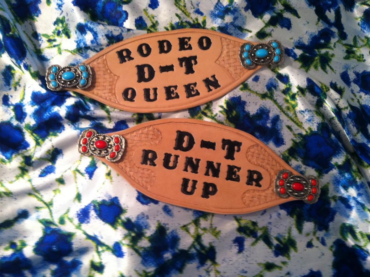

I started toying around in making bronc halter nosebands. The ones I have been making are just simple with only stamping. I was wondering what the best thing to line the back of the noseband is for when I want to add some bling. I was thinking latigo leather. Chad
