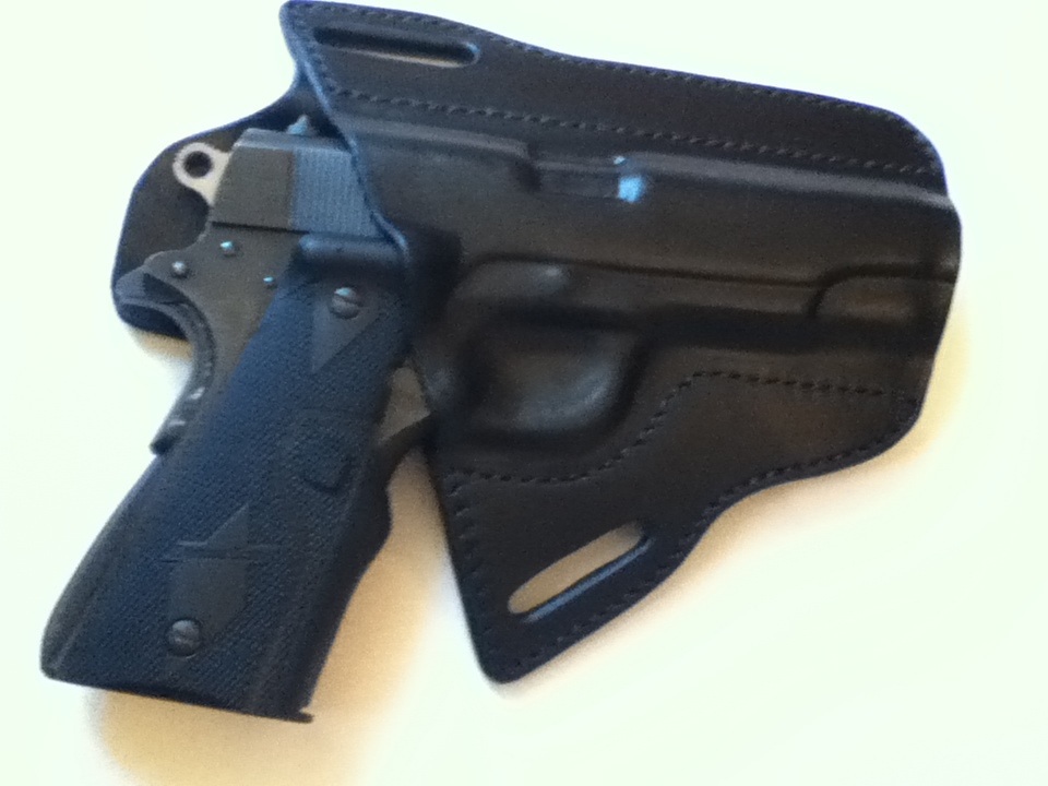

MStarmer, I believe I formed it with the safety off, but I really can't remember. Never thought about it, to be honest. I suppose it should be formed with the safety on, as one would carry it. Is the reinforcement piece for looks or function? What did you use to die the one pictured? -

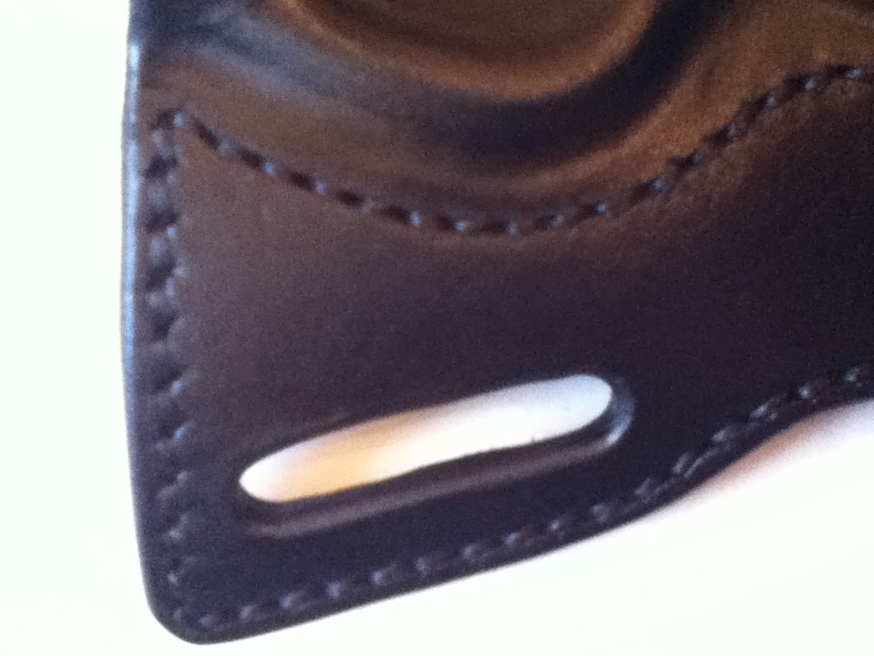

Thanks, but I think I can do better. I used a hole punch on each end, the an exacto knife to cut out the rest. Then tried to burnish the slot with a new burnisher chucked in my drill press, that I bought from one of the advertisers on this site. Katsass, you are not dissuading me in the least. I appreciate your honest criticism. I will take everyone's suggestions to heart. I'm working on new patterns already. And I'll go to bed tonight repeating my new mantra, "Do not cover the mag release, Do not cover the mag release, Do...not... cov....zzzzzzzzz. -

This is my first attempt at a scratch built holster. Did some experimenting. Drilled the stitching holes on the right side with a .060 drill. I see from other posts that this is too big. Left side with an awl. Need to improve my stitching and edge work, as well as the belt loops. Dip dyed after forming and stitching, several coats of neatsfoot oil then 50/05 water and resolene. What do ya think? Don't be shy. Can't hurt my feelings. Don't have any!!

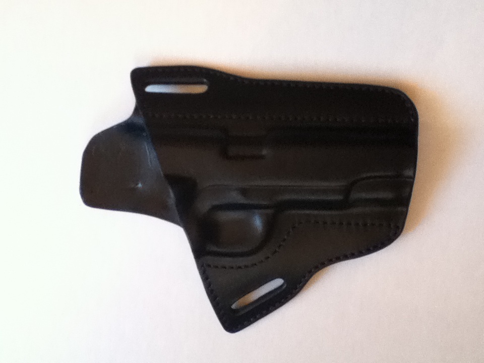

Here are some pics of the finished holster. Learned a lot. The next one will be better. I need to work on the stitching and the belt slots. Don't have a good pic of the edge, but it needs some improvement also. Comments and criticisms welcome. You are not going to hurt my feelings. Don't have any, so my wife tells me!!
Haven't forgotten. Computer problems. Doing this from an iPod. Damp sponge with stain has taken care of most of the white coloring/covering. I rubbed the snot out of it before hand with little effect. Several coats of neatsfoot oil have given it a nice black color. I was hopping the oil would have softened the leather up, but it is still stiff as cardboard. Any suggestions on how to soften it?
