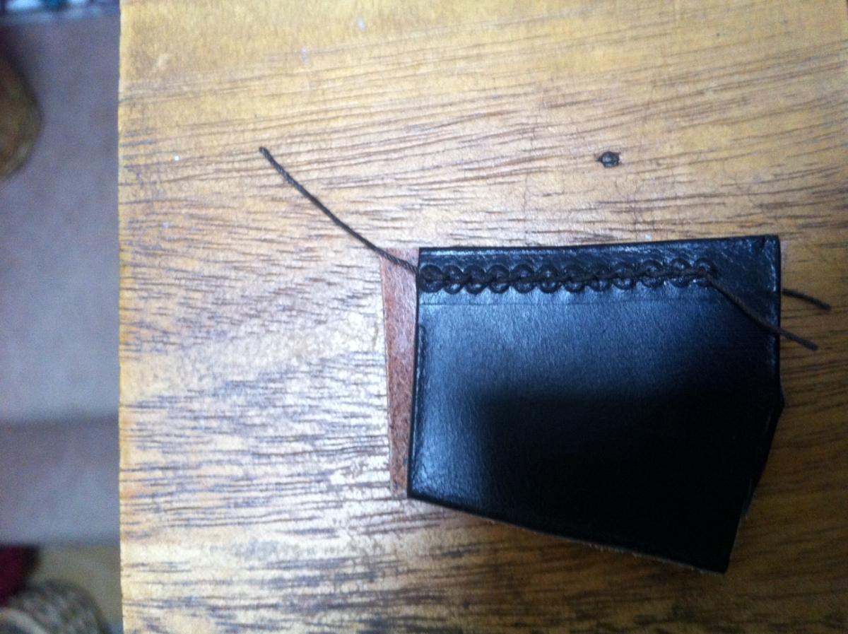

New Member

  1. Thanks, pcox. It is a size 22. I am using a size 30 bonded nylon thread (UK) I'm not sure what the conversion is, but I know that it is pretty thick and fits with the needle.
  2. Hi! The thread is size 30 and the needle is a 135x17, size 140. It is pretty dense leather (Bridle shoulder). I tried reducing the tension at the top and it worked a little. I'm going to see the engineer this weekend.
  3. I've tried hammering, but the marks are still there. the leather is very firm - bridle shoulder. This doesn't happen with chrome tan, only with semi-aniline finishes. I am using a 140 size needle. I will try to lighten the presser foot and report back. Thanks!
