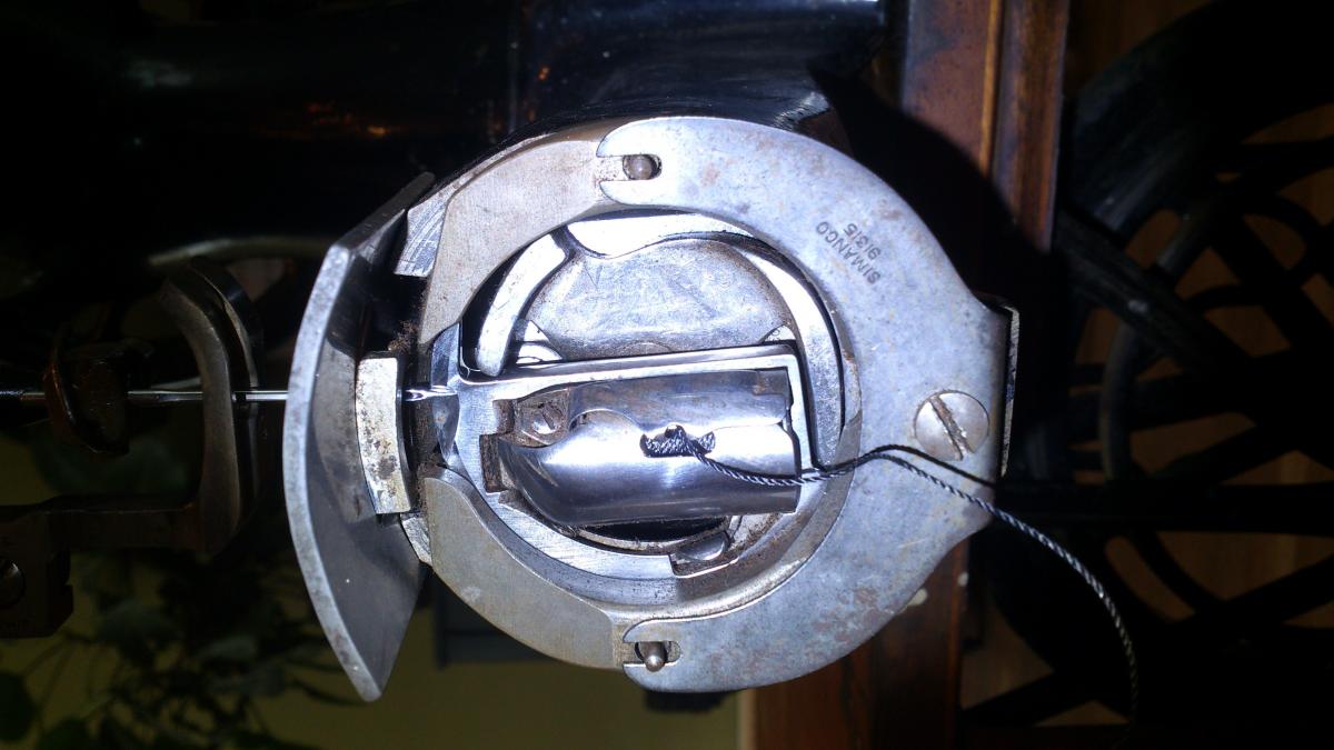

  5. Hi Jimi, Thanks for your reaction. About the needle: I would think this machine could handle the size, and larger? I've made some photo's, hope they help. In the first picture the needle is hitting a backplate. The second picture the needle is hitting the shuttle hook. Picture 3 shows the shuttle driver
  6. Hi, I have bought a singer 45k21 and the needle is scraping the shuttle frame causing the thread to brake after a few stitchings. Before it brakes it unravels. I am using a 200 needle with a 10 thread. Is this a easy to solve problem? With regards, Dennis
