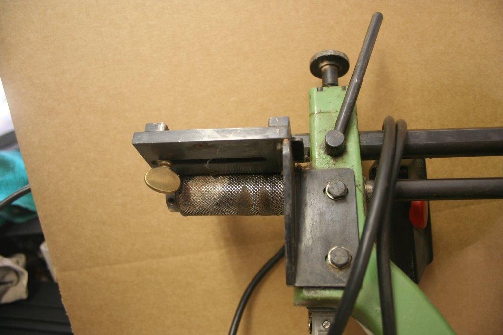

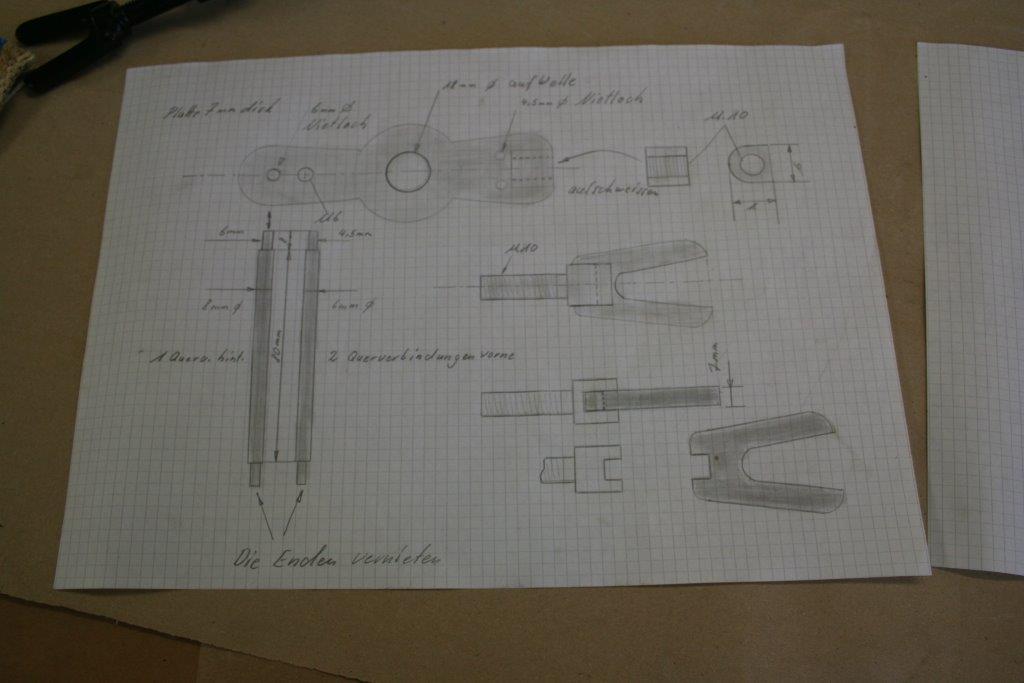

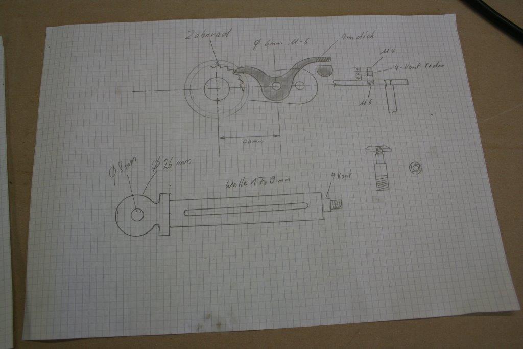

Hi Tor... I think I'll dea heating Creassers a part of a soldering iron use. See here ...... http://at.rs-online.com/web/p/lotkolben-zubehor/0662002/ To do this you can just a matching drilled hole in the shaft make and that part insert. Now you must regulate only its performance with a Dimer in the cable and already fas should work. Unfortunately the current you can from the wave out where it appears one of the best. Greeting Walter
Hi Tor... Can some with such a massive frame sure do. I'm just to make 2 of the machines. However I have not dealt even with the heating element, that comes later. I'm on the green machine. There that are inserted into the upper shaft heating cable, it of like with a soldering iron and is controlled in the heat of a Dimer. (Switch on the cable with red button) So 2 months these 2 things should be done. You give not a lot of work, but I also only occasionally have time to work. If you are waiting for something, then I will provide the data to the heating element you. I have here enough companies who can advise me there. I was now ready for the belt tensioner, see previous post, now I'll make the Creasser machines...(((-: Greeting Walter

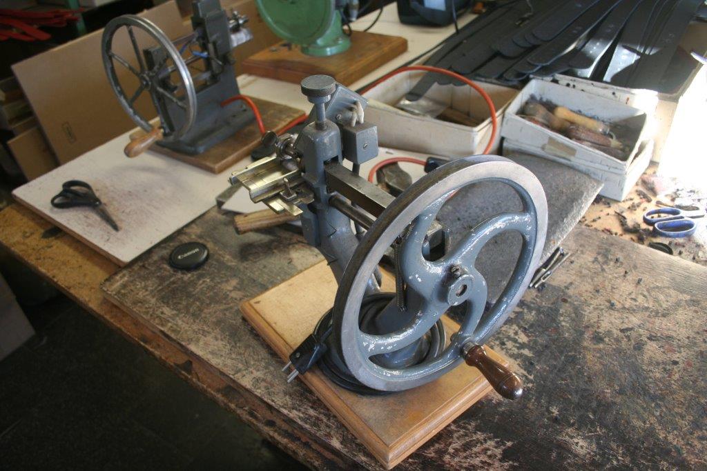

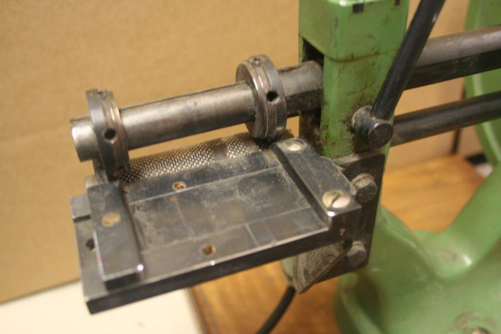

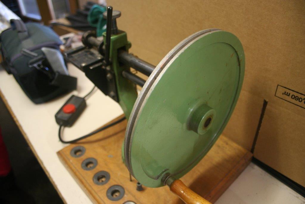

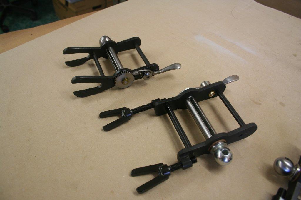

Hi leather craftsman... Here is what titled "Reifeln", or in English...Creassing. I went to a colleague today and used the opportunity these machines for you to shooting. Here a machine in green color, she once was mine, and I've sold them... Unfortunately...))-: ...vor about was 15 years. Well, in addition 2 models that are older, but there are all Swiss products seen here since the 1920 he years. The machine easily and very easy to use sin, also they have a heater for the roles above the lines into the leather press. Below is the transport roller, turn the upper rollers not at the turn of the crank. Now I'm just to build 2-3 of such machines. If a SADDLER for example driving lines to the coaching makes, then these devices are super convenient, easy and continuously in the width adjustable. Also, you can insert the 1 or 2 lines of course roles or draw wider / finer. At Weaver's are models that spread with the firm, the big heavy things Yes the old industry. I find the machines good and interesting, but they are not really good to use for the traditional Sattler. So it looks at you. Greeting Walter

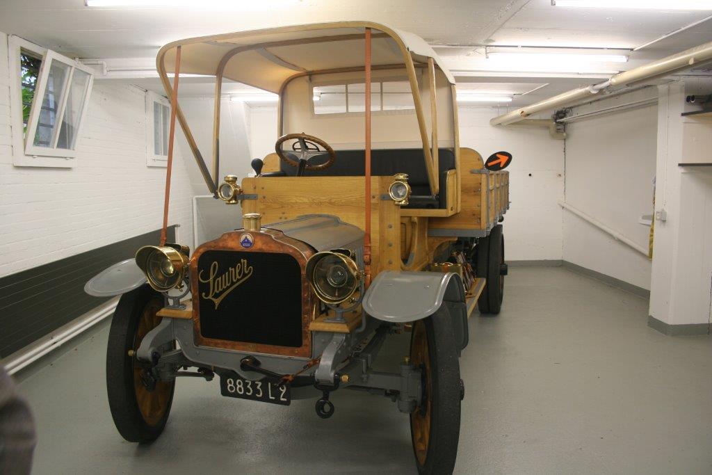

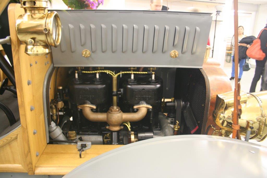

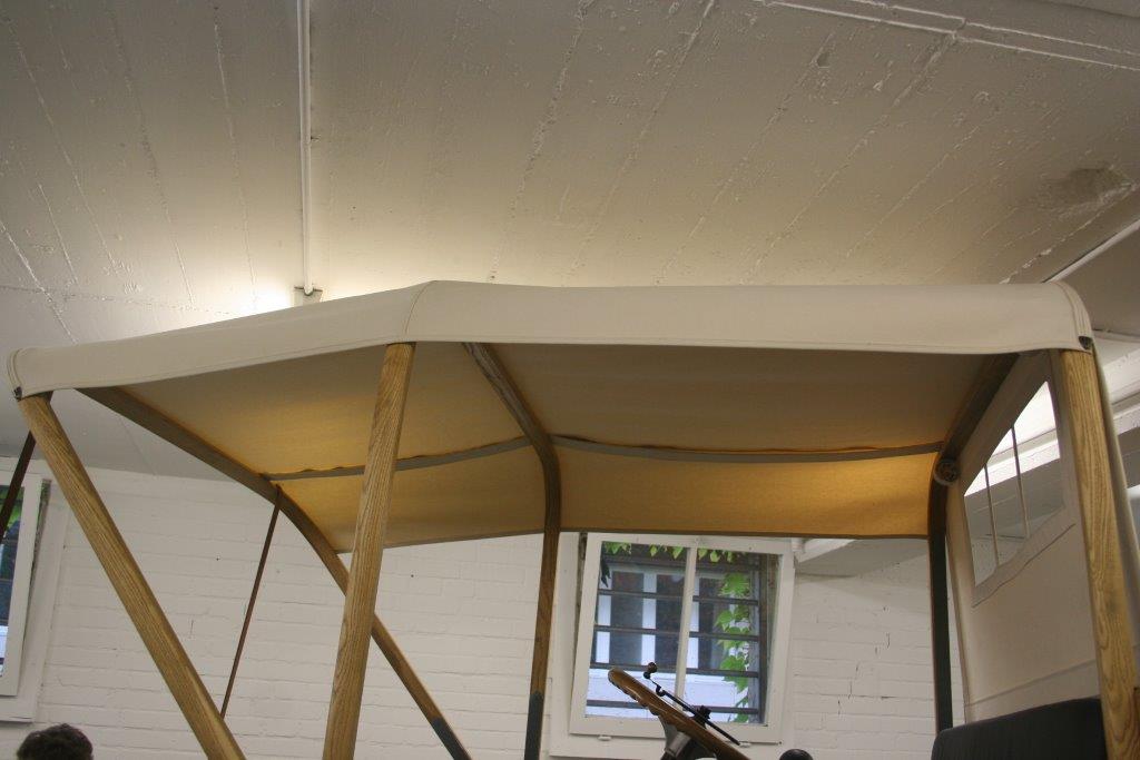

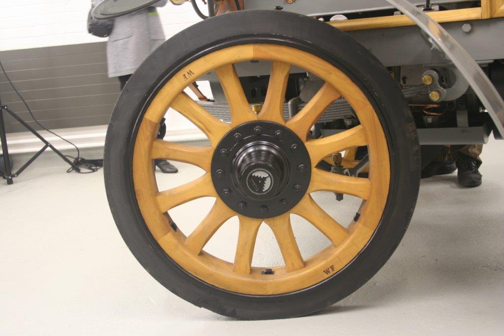

Hi leather craftsman... today I was at a small party to inaugurate this newly restored truck of the Swiss firm of Saurer from 1912. It was very nice there. You have extra beer bottles with the truck as Made label, to which also fit the invitation card, and it gave a lecture on the history of the company of Saurer. Even the tablecloths were specially printed with images. This car was waiting since 1977 on his restoration, but until 2003, it went off. Now after 8 years he has fought. In other words, the trailer that is still missing, ...aber will be ready years also in 1-2...((-: It took 8 years because it only took 5 years to make the Acacia wood for the spokes of the wheels dry. I worked only slightly on the vehicle, I did the belt works, and I was supposed to do the roof. I made but to the condition I the roof do, I can do very bad upholstery work on the car once again new. Because the car Sattler who first made it, which was a beginner. He has not understood the way of work dating from 1912, and also badly executed the work. Well, they wanted now must quickly finish the car after 8 years, for they now have a canvas roof that doesn't fit to the vehicle, and a lousy cushion on it. But there are now only a few people who can even recognize such defects. Well, anyway, I thought it is certainly quite interesting to see some pictures for you. The Wagner who made the wheels and the wooden structure of the car, who is a colleague of mine. He is an excellent professional man. He built the Gotthard mail coach to looking at the following link with his father, it was the first coach I've equipped the Sattler and it was also the first carriage leather tops you I made. https://www.Google.c...5&DPR=1#imgdii= _ http://www.gotthardp...h/index.php/de/ These mail coaches were used around the turn of the century to drive particularly the Gotthard with wealthy tourists over the Alpine passes. It was tourism, but because it was at that time already the Gotthard tunnel with the railway. Rich Englishman paid over 100 years ago but already good money, to marvel at the way the mountains of Switzerland. The car is rolling now for over 25 years and has withstood everything. Greeting Walter
