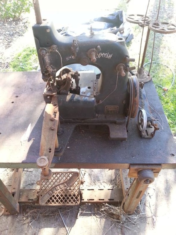

	Hello all, it is so rare to find a union machine in AU, that when I stumbled across this it caught my attention. My guess is thatnit might be a bag closure, as it looks to be in a rural setting. The owner is getting back to me with the model numbers, the plate can't be read in the photo he supplied. Regards, Tony
