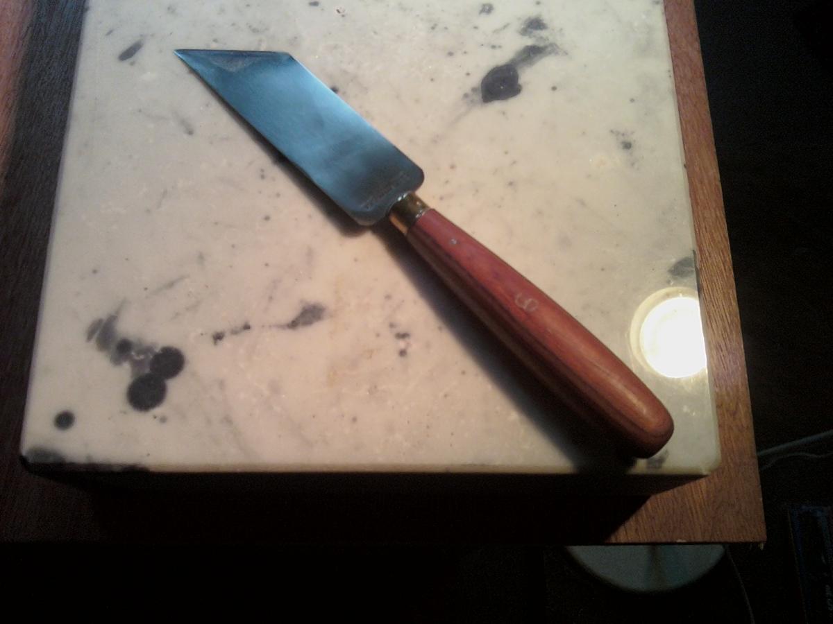

  3. In the photo is an Osborne skiving knife I just bought from http://www.handtools-uk.com/ In the photo the bevelled edge of the blade is uppermost. Here's the web page:- http://www.handtools-uk.com/p1586-skiving-knife-osborne-ref-469b-uk-right-hand-us-left The knife is described as :- Skiving Knife Osborne Ref 469B (UK Right Hand US Left). I live in the UK and I'm right handed. OK so what's the problem? You can see from the angle of the knife in my photo that it would be OK for me, as a right-handed person, to do some paring by pushing the knife away from me with the bevelled side uppermost. The problem is that on page 15 of my Al Stohlman book (http://www.amazon.com/Leathercraft-Tools-Al-Stohlman/dp/1892214903) Al is telling me that the bevelled edge should be underneath against the leather. The illustration in the Stohlman book shows a right-handed person holding the knife but the angle on the blade goes the opposite way to mine. I'm guessing his illustration shows the 469A version of the knife as opposed to my 469B version. (the difference between the 469A and 469B versions is shown here https://www.osborneleathertools.com/category.php?cid=5). If I was to use my knife with the bevelled side down then the blade would be at the wrong angle for me to pare leather by pushing the knife away from me. (The blade would be perpendicular to my body). My questions for the forum are:- 1) Does the bevelled edge really have to be on the underside? (My knife seems to cut well whether the bevel is up or down) 2) Does anyone know why the knife I've bought is called "Right Hand" in the UK and "Left Hand" in the US? The guy I spoke to at the UK store couldn't really explain this. 3) Can anyone verify that the knife I've bought is OK for a right-handed person to use? 4) Is all this "UK Right Hand US Left" stuff just complete bollocks?
