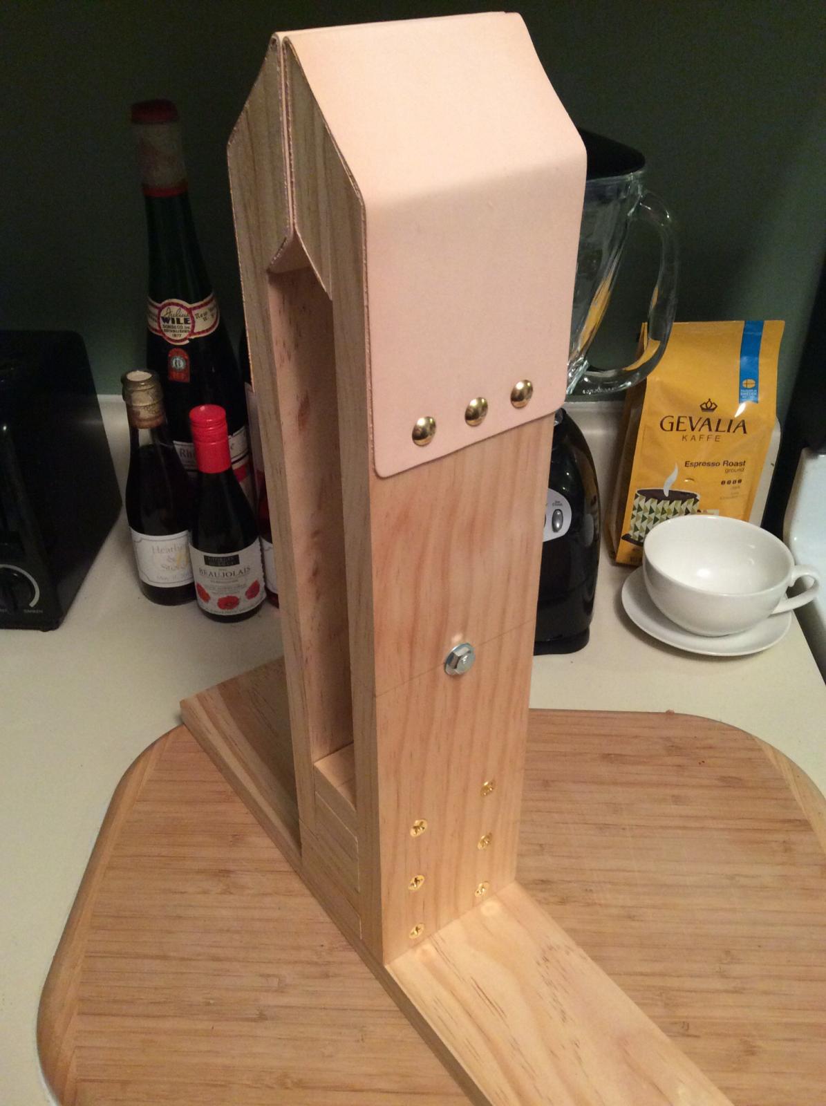

This is more of a sitting clamp than a pony or horse, but I just built two of these basically in my kitchen (other then using my mitre saw to cut the main pieces) Anyone skilled enough with a saw and some basic plans can design/build one. I'm proof! Trey

Thanks for all the replies, links, and insight guys! I apologize for not replying sooner to thank all of you, as I have been building my own pony! In fact, I figured that while I was at it, I might as well build two at the same time. To my surprise, they turned out quite well for being my first jab at it. I don't impress myself easy because I'm too critical of everything I do myself. I basically took some visual cues from certain ones that have been posted on here (and various other locales) and jumped right in. I'm in school part-time for electro-mechanical engineering and my mind quickly added a couple things that I thought would be really cool to have. The first thing, which was mentioned in a post somewhere on here, is a cam lever lock (which hasn't arrived from Rockler yet) that will help with quickly and easily help with adjusting the leather within the clamp. The second is building the base with layered pieces of 1" x 4" in order to allow for an adjustable center bolt to allow the clamp a swiveling effect. The only problem I seemed to have, was locating all completely matching brass hardware. Yes, I am THAT obsessive compulsive! Yes, I know it's a good trait, until it gets in my way ALL the time! Anyways, I'd like to hear everyone's thoughts on this. Thanks guys! Trey
