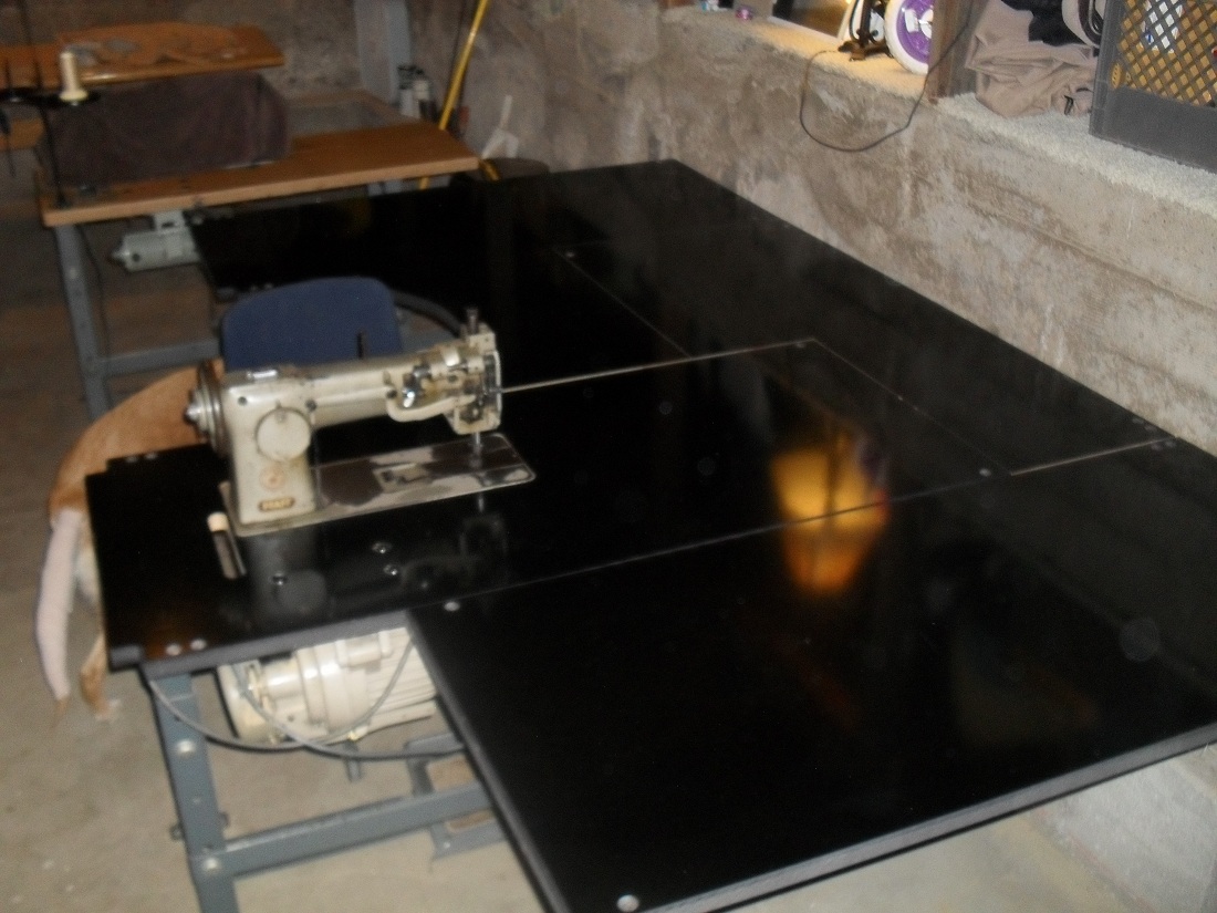

Well I did figure it all out. The one thing I thought wouldn't matter seems have been the culprit. That dang little take up spring. I loosened it just a little and "Snap", it fell right into place. I ran the machine in forward and reverse nonstop for about 4 feet at least, no frayed thread. I feel embarrassed, happy and relived all at the same time. I love these Pfaff Machines. I'm working on a complete restoration of an H4 model. I just wish they had the M bobbin like the Juki. Here's some pictures -
