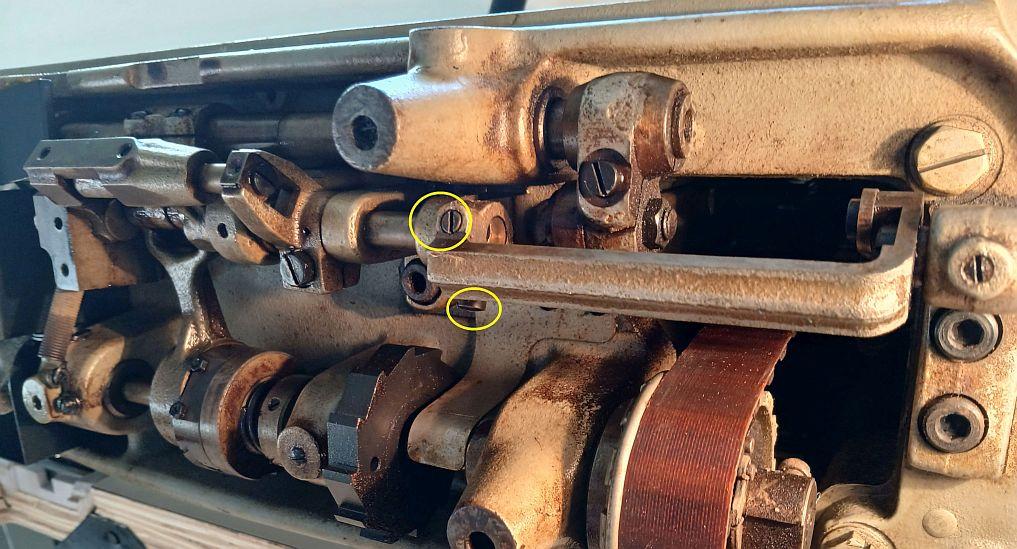

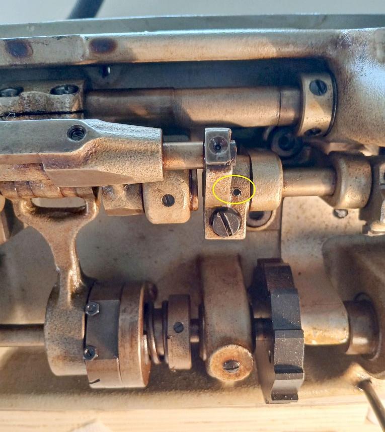

  14. Update: removing the roll pin allowed for adjustment of the stitch length forward and backward and the machine now reverses into the same holes, just as in UWE's video! SUCCESS!
