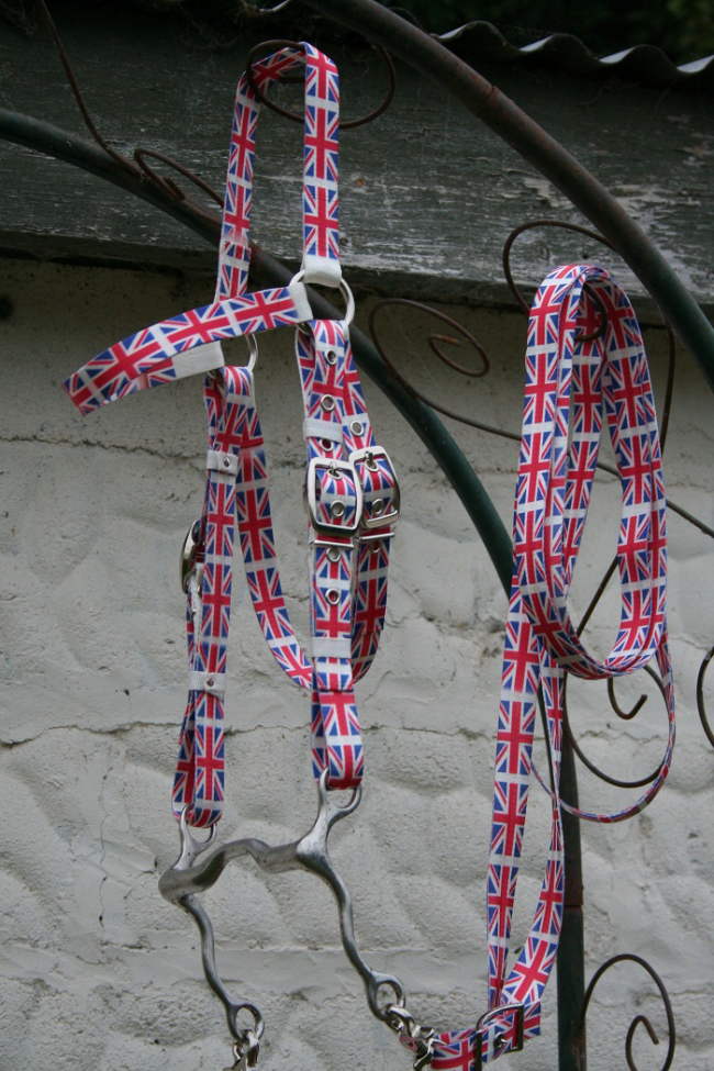

my 42-4 with the roller wheel sewed 8 layers of webbing ,she has a lot of grunt
