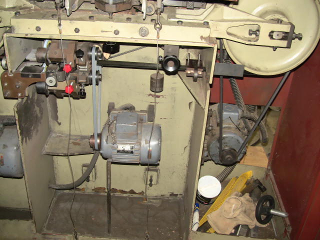

  8. We are asking $3500 for our used Camoga 411 splitter FOB Camas, WA. It is mechanically sound with all OEM parts. It will probably need a new top knife back guide. Machine pictures are available. The folks at Campbell Randall are quite familiar with this machine. You can ask for Dan Naegle at 361 293 7015. Ansur Saddlery Northwest, LLC 800 987 1545 don@ansursaddle.com
