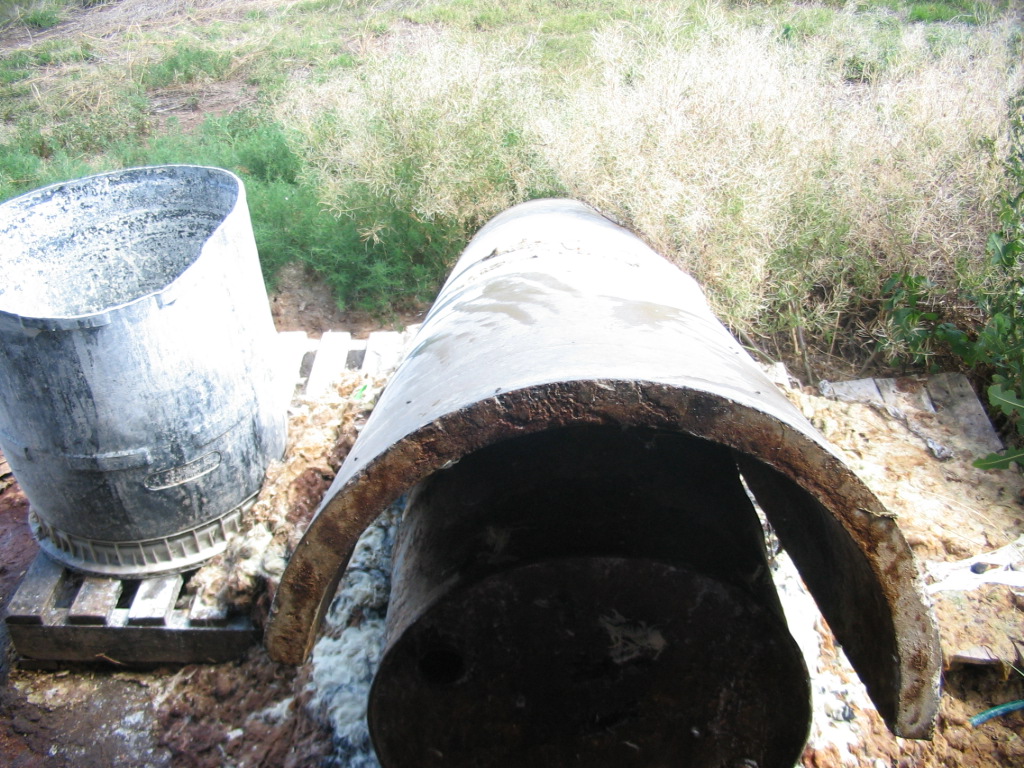

Hi All. Well the hides are ready to come out of the lime. By this the hair is starting to slip. Put the hide over your fleshing beam and push the hair off first than turn the hide over and flesh it. I use a fleshing knife that can be obtained from a hunting store or E-Bay. I also hold a water hose in one hand with one of the handles of the fleshing knife. This helps keep the knife clean and washes the hide at the same time. For a fleshing beam I use an old concrete water trough. Now that the hide has the hair and flesh taken off you will need to de-lime the hide. There are 3 ways to do this. Sulphuric Acid, Sulphate of Ammonia, and Vinegar. I will not go into the acid unless someone asks. Sulphate of Ammonia: Can be obtained from a garden store as it is a fertilizer. To 90L (20gal) of water add 2kg (4 lbs) of Sulphate of Ammonia. Handle the hide in this than leave for 24hrs. I use this for large hides or for a large number of small hides. After 24hrs the hide is washed and is ready to go to the next step. Vinegar: Can be obtained from a grocery store. I use white cleaning vinegar. To every 20L (4.4gal) of water add 2L (4liq pt) of vinegar. Handle the hide in this than leave it in this for 24hrs. I use this for 1 - 2 small hides. After 24hrs the hide is washed and is ready to go to the next step. Pickling: This step is not required but helps the tanning process go a little quicker. Most times I skip this stage and go to the next but if I only have a few small hides I will pickle them until I have 8 - 10 hides to tan. Pickled hides will keep for several months if kept moist and in a sealed container. To 90L (20gal) of water add 7kg (16lbs) of salt and 118mil (1/4liq. pt) of sulphuric acid. Work the hides in this and leave soke for 24hrs. Note: Always add the acid to water and NOT water to acid. Now I will tell you of another way to cut out all the hard work. Surch around for a tannery that deals in wet blue hides. Some tannery's will sell these hides too you and all the hair and flesh has bean taken off. Saddle tree makers use these hides so ask around it dose save alot of work.

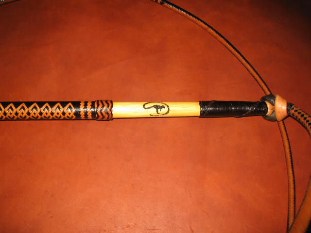

The Whip took around 15hrs work. I have done 24 strand whips and time has run out into 30 odd. It is hard to get money for time as anyone that dose fine time consuming work knows.

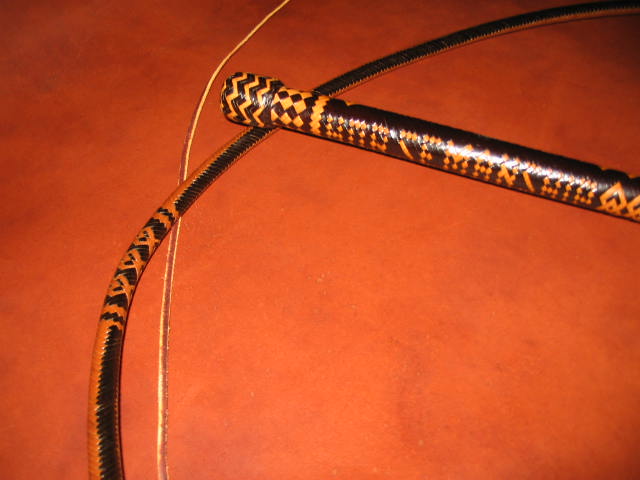

Hi as a new member i though I should show some of my work. Prob hard to see a two tone whip black and red 16 strand. The second photo is a set of reins and maching a bridle. Reins have a raw hide core and a 12plait overlay with whisky roo hide buttons.

Hi! I live on a dairy farm and I tan a lot of my own leather. This includes Raw Hide. I found Jersey cows make the best raw hide as the hide is fairly thin and even. I put the hide in Lime and water until the hair starts to slip (around 3-4 days) then on to a fleshing beam. I use an old concrete cattle trough turned upside down. I'm not overly fussed on getting all the flesh off as when the hide is on the drying rack and is dry I use a sander to take what flesh is left off. After all the hard work is done I then put the hide in water and vinegar for 24hrs. Than I put it on to a drying rack. I veg tan all my own roo hide but that is fairly indeath. I have been doing this for over 7 years now so if anyone has any Q please feel free to ask.
