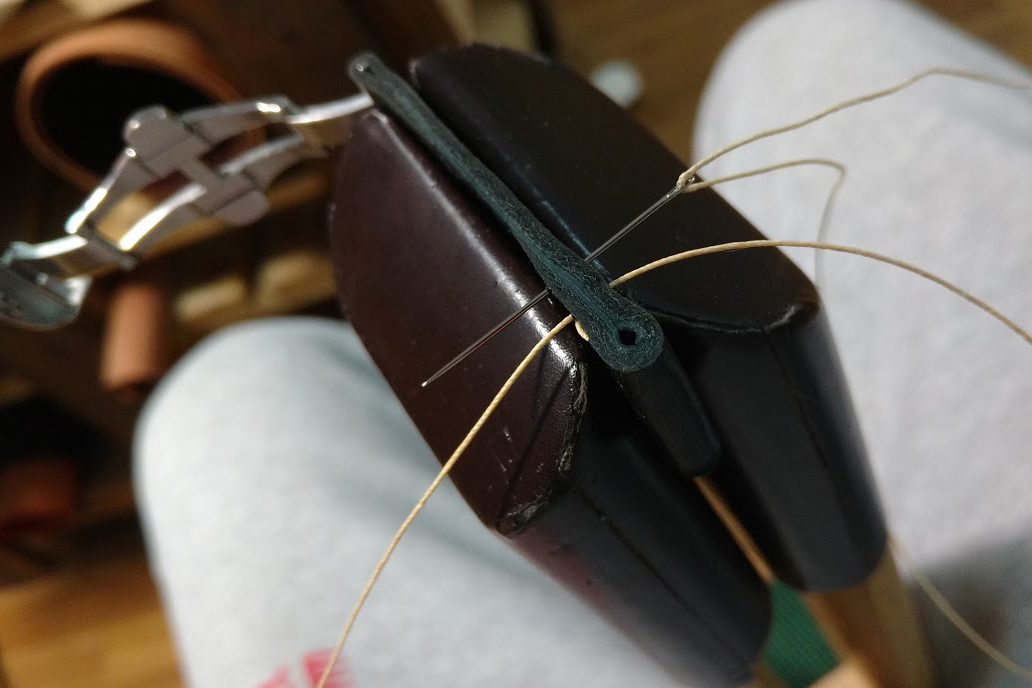

... The strap to the PANDORA hours of crocodile skin color with an interesting distressed gold ... Used plastic insert for tight abutment to the clock. The basis of vegetable tanned leather. Hand sewing saddle stitch waxed thread.

.. Complicated and more interesting on the project of manufacturing the strap to the watch Adriatica ... The most difficult to make a replacement rubber strap having complex forms of contiguity to the clock. It was decided to produce a polyurethane portion of the insert. The rest of the construction was made of leather. Base - leather vegetable tanned. Face layer - leather legs ostrich.
