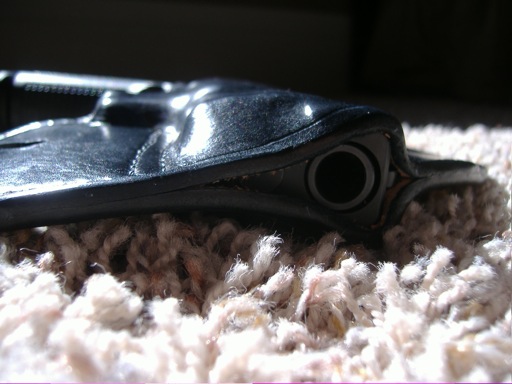

  2. Yeah, looks nice and clean. I think it's the best pocket holster I've seen to date. Hand stitched?

  6. So, I made some modifications to my design on this one, and came up with this. I think I will extend the sweat guard slightly higher, and will give attention to the throat re-enforcement to make sure it's more even all the way across.
  7. This is my first pancake design, and overall, I think it turned out well (it's my 2nd holster). I have already altered the pattern to allow for more trigger guard coverage, as this one is a tad low (mainly in the front). For the belt slots, I used a drill bit to make the holes at both ends, and used a verry sharp chisel to connect the edges. It resulted in a perfect striaght line, with no jagged inside edges. Cheers!
