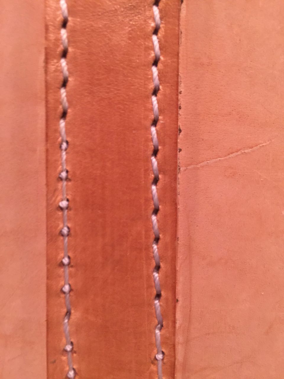

I have been busy with other projects, given the Christmas break provides opportunity for me to get a lot done. I did sew on it earlier this afternoon and oil ran all over the leather, but no matter--it was a sample piece. It is laying down very well and I plan to sew some books tomorrow. It could have been a combination of things, bad thread, a possible bur on the foot that would catch the fuzz on the thread, poor adjustments and in need of a more thorough oiling. I don't know which one or all. I do know that he completely re-routed my thread and it seems to run smoother. The more places you run it through, the more opportunity there is for problems. -

Update: The Asian group ended up going to Vietnam for the week so I missed them. However, Bob gave me the name of a local gentleman, Alexander, in the Dallas/Fort Worth area that took a look at the machine for me and spent a good amount of time working on it, and changing the routing of the thread and sanding the foot where the thread goes through. But in the end, he suggested I throw the thread away and left me a new spool. My thread had fuzzy areas on ocassion and you can't stop during a project and solve it. Needless to say, I am extremely grateful to Bob and Alexander. These machines might be made of steel and weigh a ton, but they are VERY sensitive. The threading of the machine is completely different than anything I have seen, and the thread is a very nice smooth consistency. While Alexader stitched just about every thickness you can imagine, I have not had time to put the machine through its paces yet. But Alexander's work was top-notch. In fact, that guy is a scientist when it comes to these machines. Shout out to Alexander in Dallas. Hell of a guy. Thank you. I'll post back shortly with comments and pictures. -

Sewing machine repair guy stopped by on his way to a client's house, and took a quick look at my machine and immediately stated the thread was of very poor quality; inconsistent and fraying (white), the black was far too stiff but should sew better than the white. He suggested throwing them both away and getting better thread before trying to make any adjustments to the machine. He plans to drop by on Friday to work the mechanics out with better thread. Any attempt at making any lasting adjustments with poor thread is a waste of time, in his opinion. Interestingly, the white thread looks better (when it works) than the black thread. But I've had problems with both. I'll update all on Friday or Saturday before rendering a final diagnosis. -

Yeah, you know I found a burr on the spool of thread that was causing some hang-ups. I could not tell how far down the line it was but cut it out anyway. A few minutes later while trying to test the unit after replacing the needle and bobbin, the thread ran out on me. So the end was closer than I thought. Sadly, the problem continues after trying every suggestion noted above. Four hours of working on it has yielded a variety of results that eventually ended me back at where I started. I am having a sewing machine specialist come out to the house next week. He used to work in the factories in China maintaining these machines so I imagine he'll make short work of it. I am convinced the bobbin is the problem. My wife owns a national children's clothing company with sewing facilities in Bangladesh, China and Vietnam, and more recently the US. The quality has become quite poor, and they knock everything off with cheaper materials and thread and sell it for change. They are basically fishing for ideas when they produce your products. Needless to say, the wife looked at it and told me your bobbin isn't working properly. So she's sending her guy out. I'll keep you posted... -

I have had this problem a few times, but am usually able to correct it, sometimes by myself and other times with Bob's help. This time, neither Bob nor I can figure it out and am losing confidence in the machine. Thread, needle and machine all acquired from Bob. I have adjusted and rethreaded at least a dozen times, lubricated, and cleaned the botton bobin area, checked the bobbin and tension etc. So, the machine has become a major nightmare. Edit: CB4500 Machine. Pic attached of the problem...
