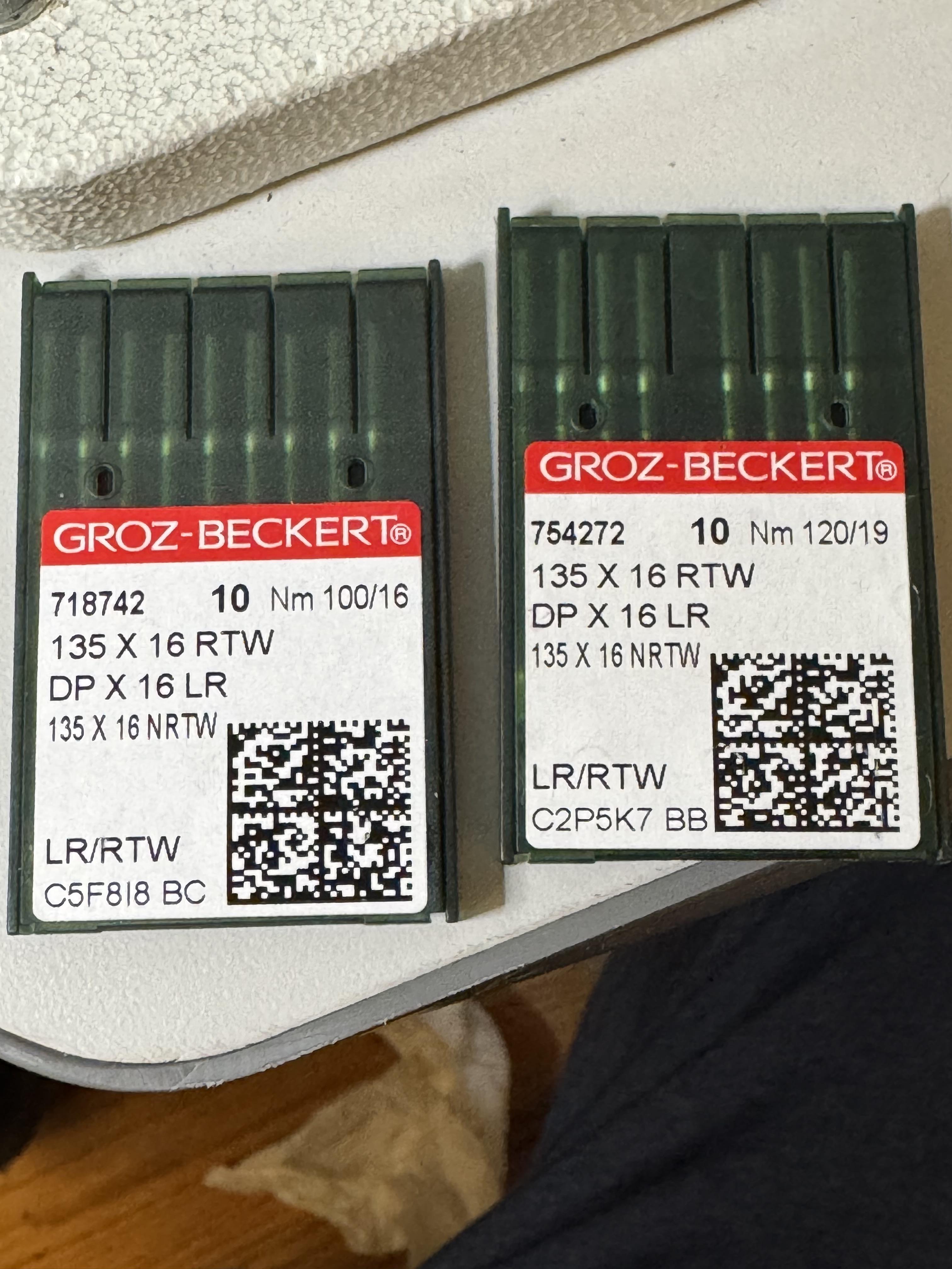

I am pretty sure it is all of the above. Do you know where i can buy needles? The only place i know is Amazon or Sailrite and they only have those points. -

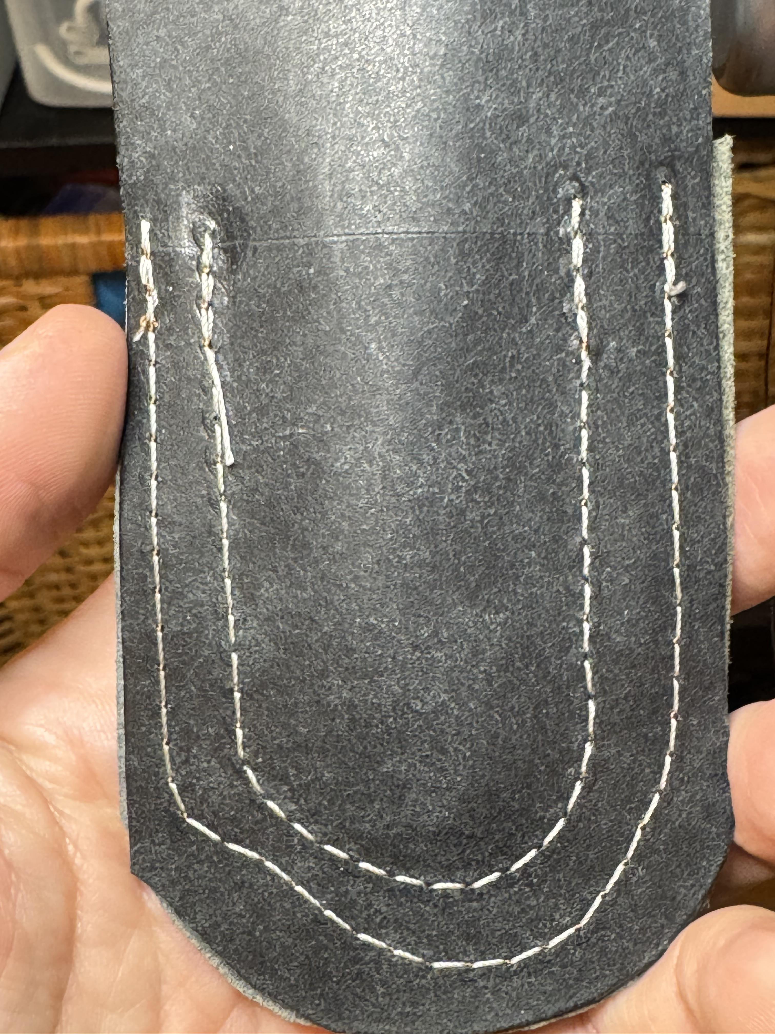

The outer line is done with the #16 and a thread a bit larger than the v92. The inner line is the same thread with a #19 needle -

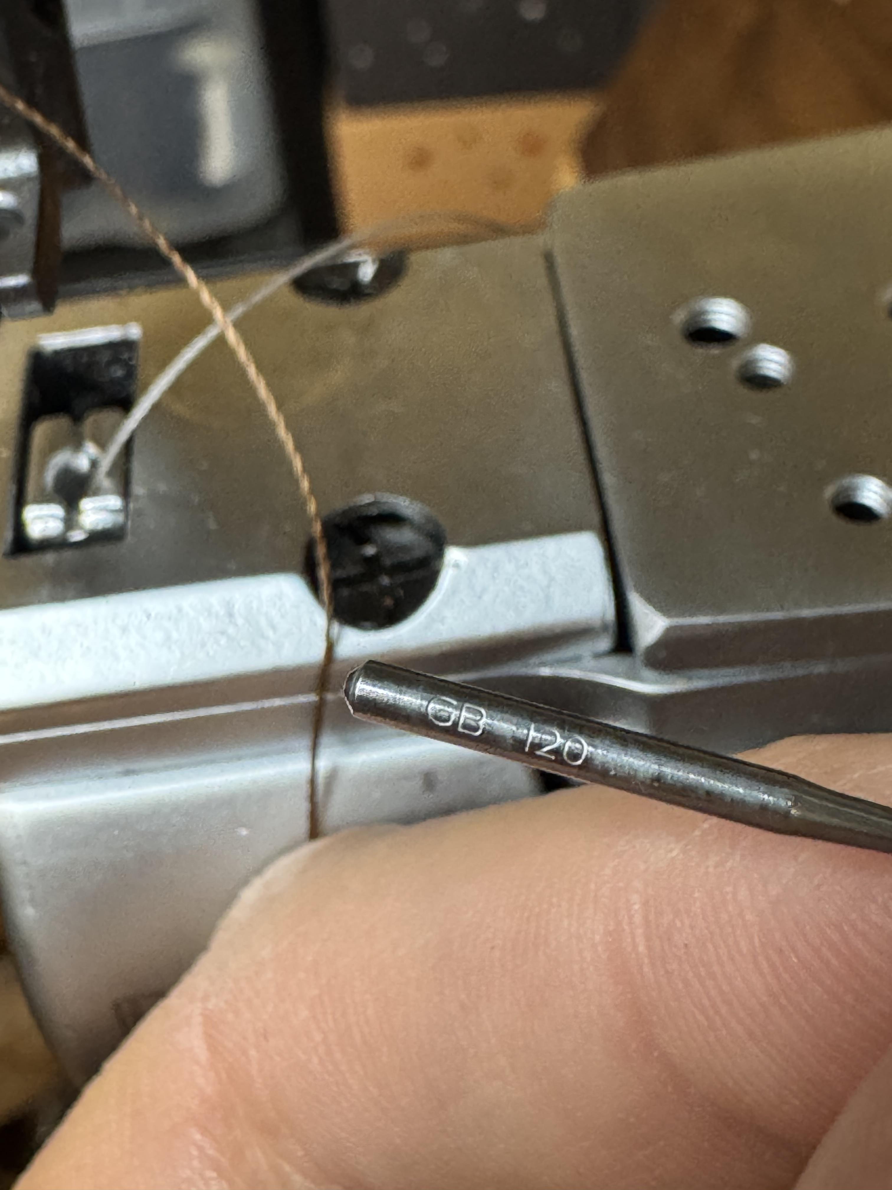

I already changed it and, as you said, it made no difference with the size of the hole in the leather. Could you show me a photo of the hole in the feed dog of your 246? It is strange because I leather purses out there sewn with very thin thread, must be v92, and the hole left by the needle is unnoticeable. Mine is always very visible. -
I got the replacement doggy thingy for my Artisan 246. The problem I am having is that the hole in leather is very large even with smaller needles. Someone said the hole in my dog feet thingy was too big so i bought another one. Looking at it, it does not look much different. What do you think, should I change the part on the machine? Would it be worth it?

Ok so, I have used the trick shown by one of the members of this forum (thank you again) to backstitch into the same holes and it’s turning out great. What I don't understand is why the hole left by the needle is so big. I am Using Vinymo #8 for top and bottom which is supposed to be close to a v92. The outermost line was made by the #16 needle while the inner line was done with a #19 needle. I can barely tell any difference in the hole size and it still looks huge compared to the thread which looks very thin. The brown is the top stitch and the gray is the bottom. the leather is very thin Badalassi Pueblo which is very easily indented thats why there is the marks from the bottom hole on the feeding dog even though I greately reduced the top feet pressure. Anyhow, about the hole/thread comparison, please any suggestion? I don’t think I can fit a v138 through the eye of the #16 but I would like the hole to be smaller compared to the thread. Thank you.
That sounds like great advice. I didn't think I could change that hole. I have read elsewhere on this forum, which btw is amazing, and I have learned that I could change the pressure of the presser foot (of both presser feet actually) so I did and the dimple is much less noticeable. However, I would like to know hot to change the bottom transporter. I am not sure I know exactly what it is and, is it something I can do myself? Do you have any suggestion on where to find parts that work on my machine? I know it is aclone of a juki dsc246 but when I look on Amazon, ebay or jus tgoogle it nothing really comes up in terms of parts that I could be sure would be compatible. Thanks for your help.

I already bought them from Sailrite but thanks for the website, I’ll save it for next time. So, I understand the thread recommendation about the #16 needle but, I also read that I should not put a v138 on an #18 and, to be honest, i think that combination works great on my machines. No skipped stitches and no tension problems that I can tell but I am no professional. The only problem I am having is when I backstitch even if I go in the same hole it messes up the bottom stitch but that happens even if I use larger needles keeping the v138. Also, I do use the vinymo on my Tippman Boss and Sailrite Ultrafeed. Since the not recommended v138 on the #18 needle works for me I am hoping it would be the same with the #16 and the v92 (Vinymo #8). I wont be able to tell until I receive the needles though What should I be looking for to see if the match is not a good one? Skipped stitches or anything else? Thank you for all of your help.
