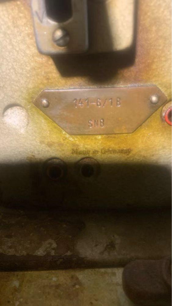

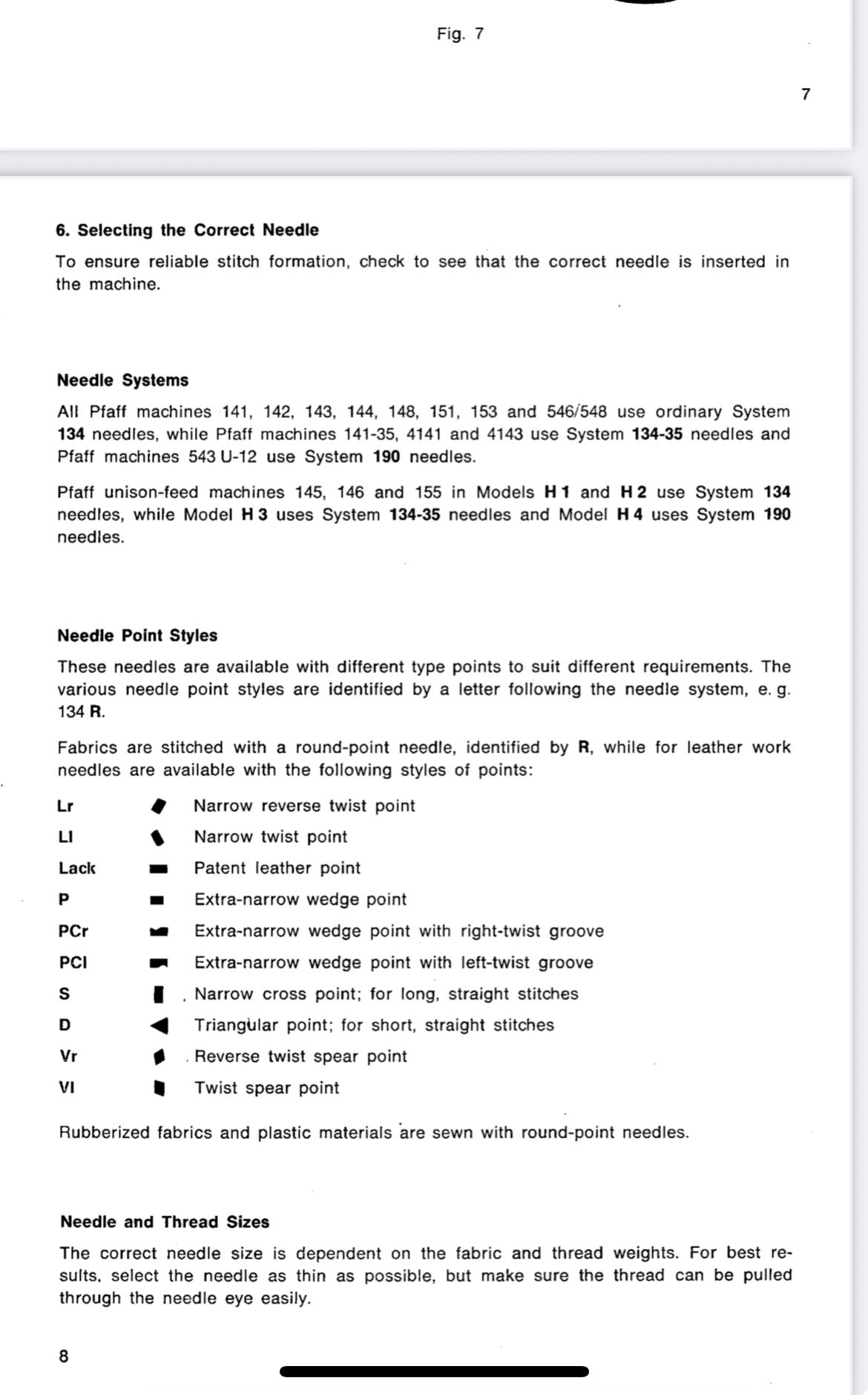

Hi i I am trying to understand what needle system I need for Pfaff 141-61B i don’t see this subclass in the manual
I got it it from Dürkopp Adler if someone needs
