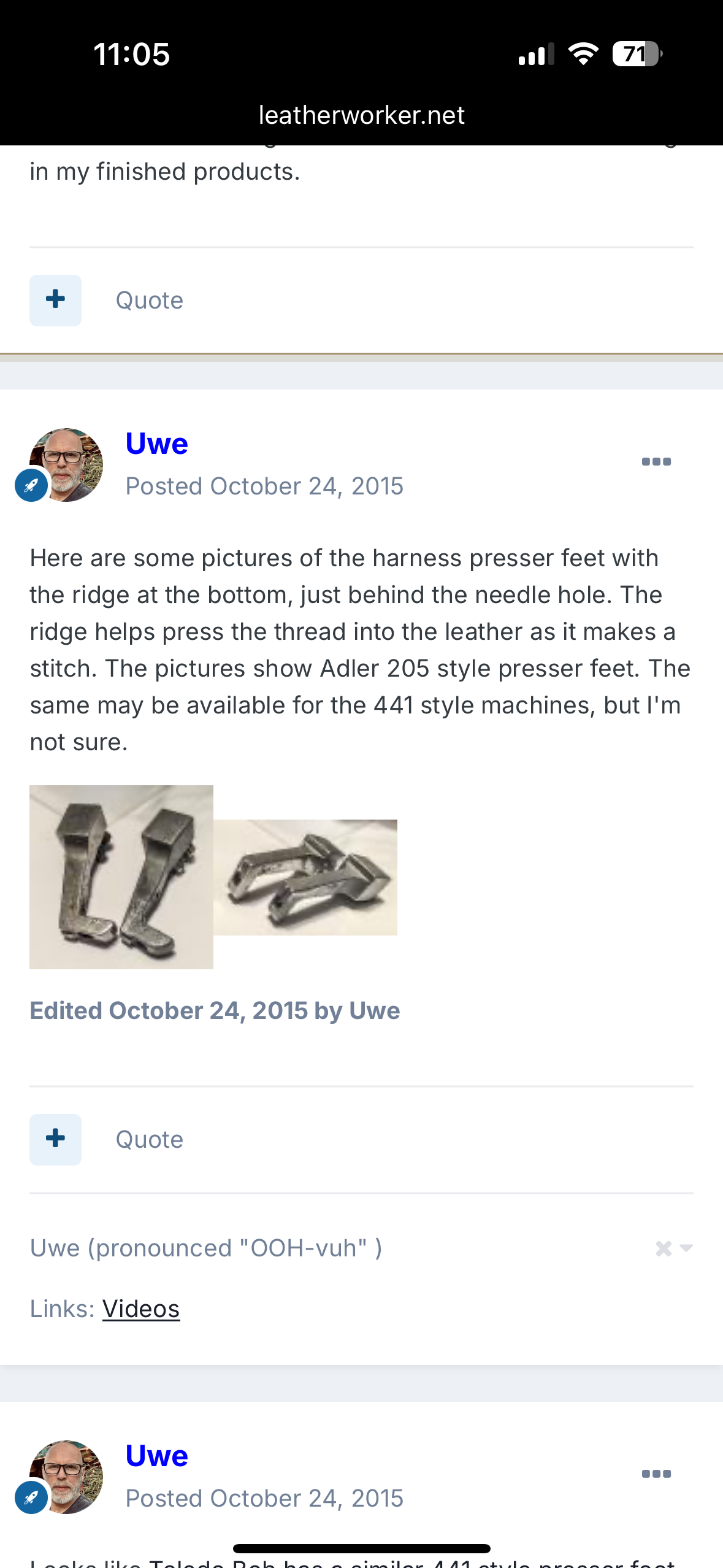

  2. I found a topic posted by user @Uwe that discussed the harness inner pressor foot for the Adler, 205–370 and the ridge on the bottom, see screen shot. It seems it is in fact for “setting” the previously made stitch, by pushing it into the leather. My discovery has been it is not useful on light leather as it leaves unsightly marks. ordered some new presser feet from HPPrecision.

  6. All I can think of is it pushes the previously formed stitch down into the leather to help protect it from abrasion. I see it labeled as a harness presser foot. I notice on thicker projects like a gun belt where I use heavier a heavy needle and thread, and a wider stitch length, it seems to “set” the stitch into a groove.
  7. Hello folks, amateur sewing machine operator here I believe the Adler 205 I picked up has the harness presser foot (inner and outer). The inner foot has a groove fin on the bottom that leaves unsightly marks on the lighter leather projects I have been sewing. Seems great on the heavy belts I sew with 346 poly thread, but lighter wallets with 135 poly no so much. is there a member advertiser here on this site that carry’s presser feet for this machine I can purchase. I’m having a hard time finding info online to point me in the right direction. i found a page on a Cowboy site that lists different feet, but I can’t find where I would order? See 2nd pic thank you
