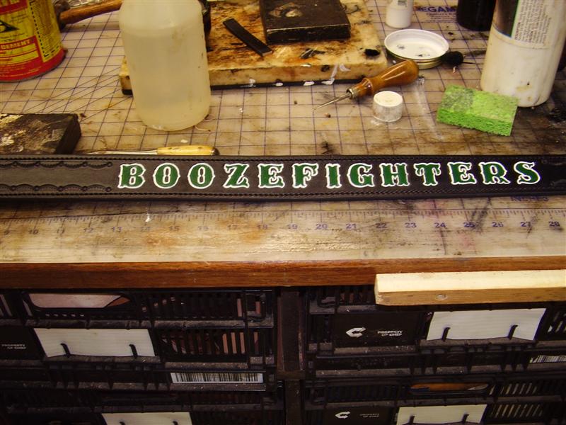

Ambassador Luke Hatley Posted February 14, 2008 Author Ambassador Report Posted February 14, 2008 (edited) Sorry Freak, but I'm photographicly challenged at the moment. This stuff works just like antique or highlighter, except you can make it any color you want. Pretty cool stuff for cheap. Freak this is one of 3 black Belts that i outlined the lettering with a dulited white cova acrlic,I had a hard time getting the white off the black dye. and I dont want go thru that again. Edited March 2, 2008 by Johanna Quote Luke
Contributing Member Jordan Posted February 15, 2008 Contributing Member Report Posted February 15, 2008 Luke, That is a real cool effect and great colors. Are those 1" letter stamps, or carved? Quote
