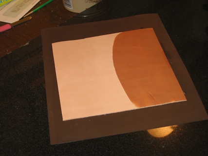

2. Like Mike says, moisture content makes a lot of difference. Too much and it's like working a sponge. Too little and it's like working cardboard. I've attached a couple photos below. The first one shows the difference in color between dry and quick-cased leather. The second shows the approximate color of the leather when the moisture content is at working level. The color variation around the image is largely due to burnishing. If you look at the top of the piece, the color variation is the result of the leather drying (the uneven drying is a natural consequence of quick-casing). That not-quite-dark and not-quite-light color is what I look for as an indication the moisture content is where I like it.
Dale
