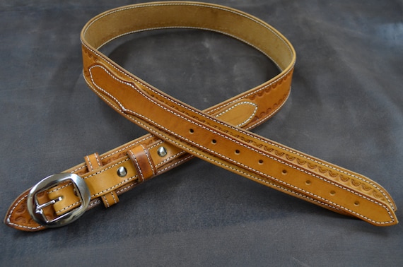

Contributing Member fredk Posted August 7, 2024 Contributing Member Report Posted August 7, 2024 This is what I think of when I think of a 3 piece belt Quote
Members Herbie Posted August 7, 2024 Author Members Report Posted August 7, 2024 1 hour ago, fredk said: This is what I think of when I think of a 3 piece belt Very nice! Quote
Members Herbie Posted August 7, 2024 Author Members Report Posted August 7, 2024 The chat lady suggested it might be a nice buckle, loop and nice tip. KInd of close. Quote
Contributing Member fredk Posted August 7, 2024 Contributing Member Report Posted August 7, 2024 24 minutes ago, Herbie said: Very nice! Not mine - I stole the picture off the internetty just as an example I wish I could make a belt as nice as that Quote
Members Cattleman Posted August 7, 2024 Members Report Posted August 7, 2024 Ranger Belt... Usually made with a fancy buckle, loop, and tip set. The pictures above are a ranger belt minus the fancy hardware. Quote
