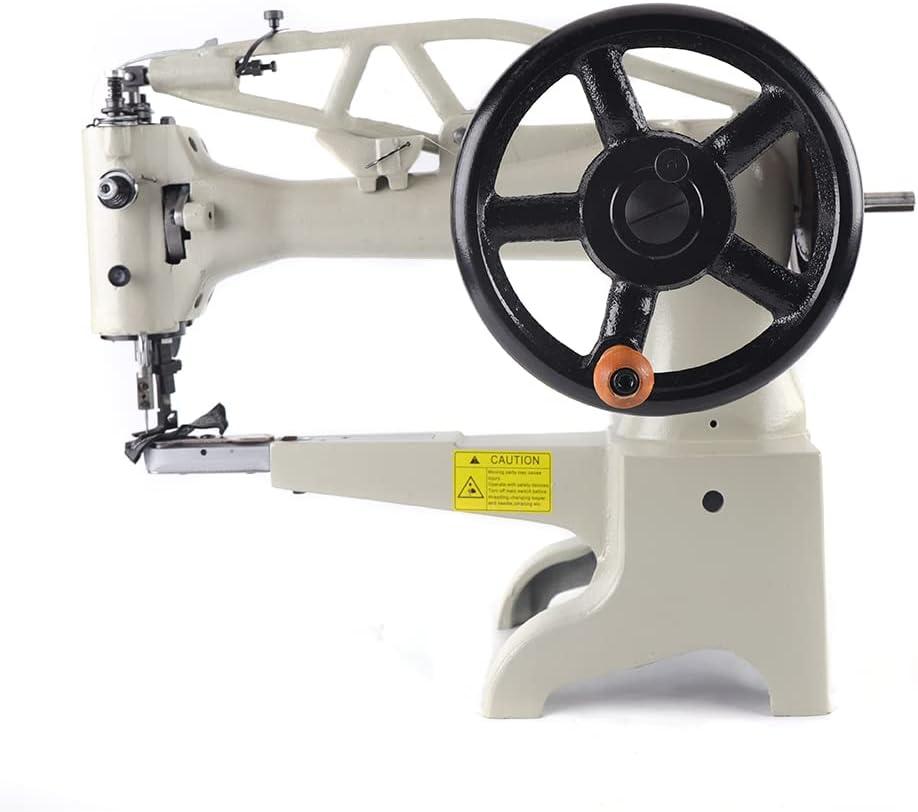

Does anyone have instructions/input on how to thread and use this machine?
It's a copy of an original one I think.
Has the hand crank but I also have the electric motor kit.
I want to learn how to set it up and use it, but can't find instructions.
Thank you!
Expand
Download the Singer 29k-72 manual. Here is a pdf version:
kgg
Singer 29K71, 72, 73-1.pdfFetching info...
kgg
Expand
Oh wow!
Thank you!
So it's a copy of that Singer.
Thanks!
Expand
How good a copy, clone or whatever you want to call them depends on the quality of the casing and internal parts.
kgg
Expand
I also read saying it is a copy oif a "Consew".
I can't find the wire used for running the thread down to the needle, or the bobbin holder to refill the bobbin.
I also am trying to figure out what thread the bottom holes have to attach to a table, but I figure that may be trial and error.
Any suggestions on alternatives/hacks?
Expand
The Consew is just another clone variation of the Singer.
Expand
Some of the clones use a small needle like thing that you tie the thread to and drop it down the threading hole.
Expand
If they copied the thread from the Singer, Singer had their own thread pitch and finding them is going to be difficult / impossible. So you can either re-drill / re-tap the holes or use a smaller bolt that will fit through the hole.

Threading wire:
https://www.ebay.de/itm/162385533414
Screws could be metric too - you never know. I´d re-tap a new and more common thread.

Thank you everyone.
I will try and figure it out.
I got some of those thin green wires used for floral crap and will see if that will work.
I have some spare bobbins and that threader wire in storage somewhere, so maybe it will pop up next time I go.
