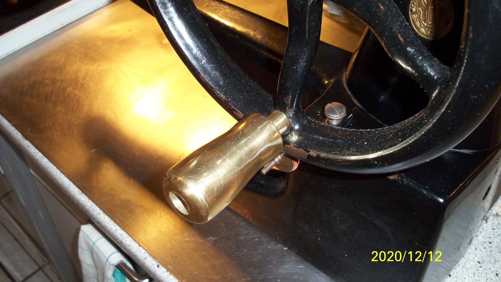

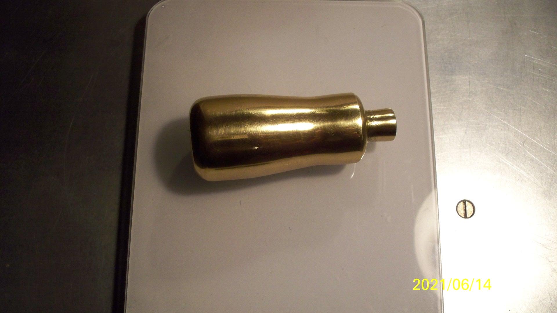

Take a look at the handle on your handwheel - I made one out of brass to replace the wooden one - I now have the same problem as you have.
The handle will - when the 29K33 is not under belt tension - sink to the bottom
As soon as I switch back to the very light wooden handle - the wheel stays in place where ever you leave it.
Naturally the handwheel also stays in place when the machine is under belt tension (to treadle or motor)
