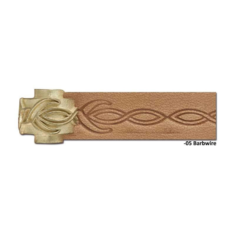

When the OP said 'small' I assumed he meant these;
https://tandyleather.eu/en-gb/collections/tools?filter.p.m.filter.category=Embossing+Wheels
8092-05_798x798.jpg?v=1582318646
yes, those, the ones made for the stitching wheel handle. Rolled back and forth with firm pressure makes a good deep impression, if the leather is cased properly. I ordered a couple of the wheels, and i have that stitching wheel handle somewhere...

as @fredk said, Tandy (and others) make small and large embossing wheels for manual application with a handle. Rolling the wheel back and forth in short quick strokes with firm pressure on cased leather gives a good impression. It's laborious, but work is something I enjoy.
