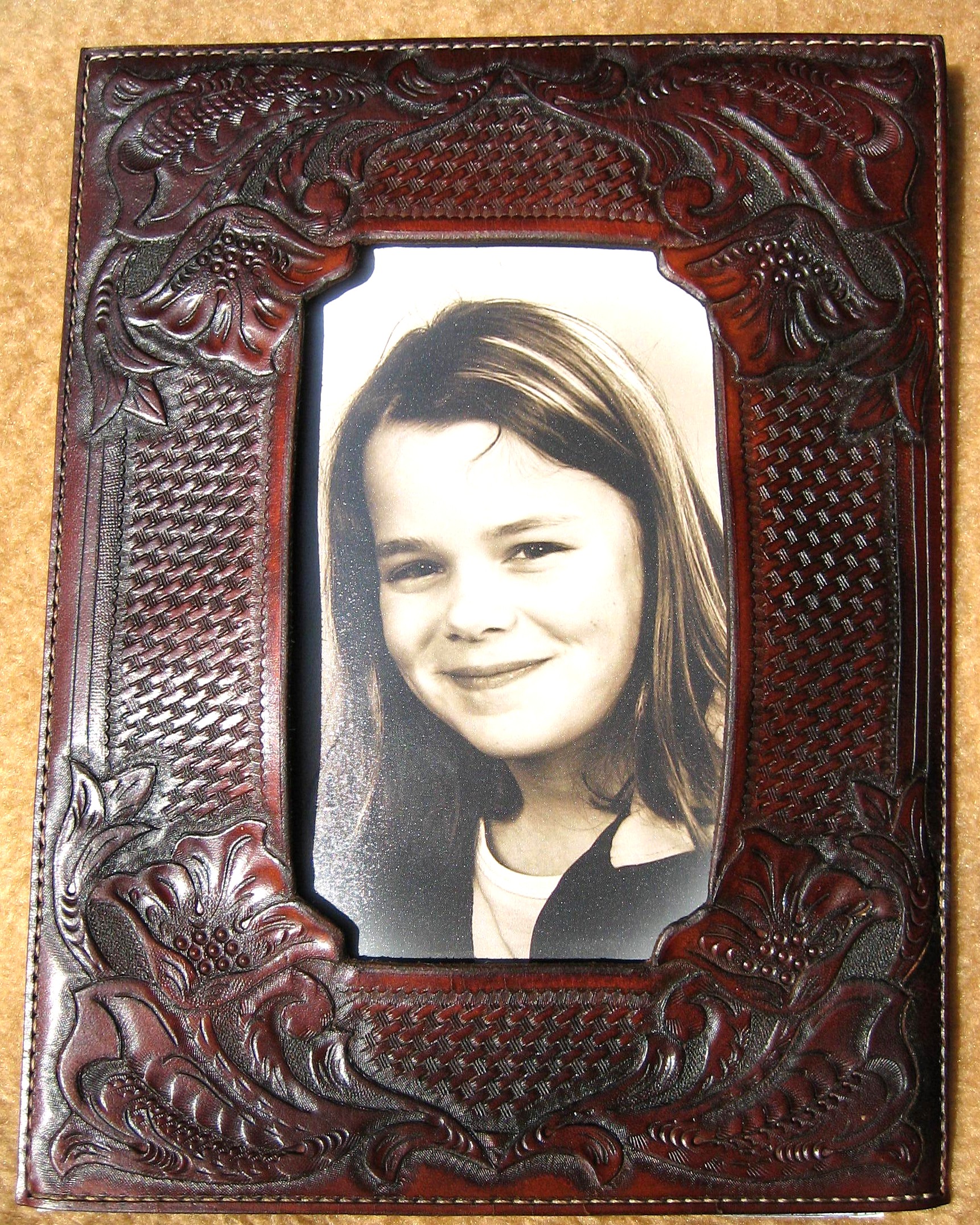

Ambassador Don101 Posted April 21, 2007 Ambassador Report Posted April 21, 2007 I don’t know if anyone has seen or done this before but I haven’t found it any where in the forum so I thought I would post it as it is a simple thing to do and looks unique as you cant buy them in the stores and also makes a nice presents and so on, the stitching at the base is only done on the top layer for deco as you insert the picture from the bottom. Quote

pepin1948 Posted April 22, 2007 Report Posted April 22, 2007 Do you have trouble (as I do) with the inside edging/finishing? I've done a similar frame, and I found that to be the hardest part. Would appreciate all tips on how to do that part. Quote
Moderator bruce johnson Posted April 22, 2007 Moderator Report Posted April 22, 2007 Holly, I try to avoid exact 90 degree corners or points in the design, and will use small radius corners cut with punches. I apply my edge burnishing agent of choice. Then I use a combination of things. A stick with notches cut out, a bone folder, rubrag on the straight sections. dowels to burnish the inside corners, whatever the section calls for. Bruce Johnson Quote Bruce Johnson Malachi 4:2 "the windshield's bigger than the mirror, somewhere west of Laramie" - Dave Stamey Vintage Refurbished And Selected New Leather Tools For Sale - www.brucejohnsonleather.com
Ambassador Don101 Posted April 22, 2007 Author Ambassador Report Posted April 22, 2007 As bruce has covered it basically i did it a good few years a go and didnt really have the right tools i was using a tandy edger which doesnt really make the edges round now i use the round edger from Osborne nr 1 which works alot better and saves half of the work, i also have a variety of round dowels with different size notches in them, just put the dowel in the drill and use a round file and cut to depth and size you need. Don Quote
pepin1948 Posted April 22, 2007 Report Posted April 22, 2007 Thanks Mine did have 90 degree angles, and getting into the corners was not very do-able. Quote
Members mulefool Posted June 14, 2007 Members Report Posted June 14, 2007 I really like how you put the flowers in the corners. Makes it more interesting than just a 90 degree. Quote www.horseandmulegear.com
