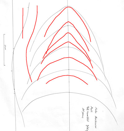

Members David Genadek Posted May 1, 2007 Members Report Posted May 1, 2007 Ashley, I make my own trees. I work with a 3d designer on creating the shapes. Our bar profiles are created by modeling a sampling of backs in the computer. We pull the profiles from real backs and then add the space we need for movement. We cut our parts on a five Axis router. I do not consider myself a horseman but I try to learn what I need to know from the best people I can find. My Anatomy and biomechanics back ground come primarly from Deb Bennett PHDEquinestudies.org My primary influance in regard to rider position has come from Peggy Cummings Peggycummings.com I have been influenced by many horseman Harry Whitney HarryWhitney.com, Mark Rashid MarkRashid.com but my heaviest influence in regard to horseman ship has been my better half Liz Graves LizGraves.com My opinions are hard won and very defendable so I don't mind challanges in he least . David Genadek
