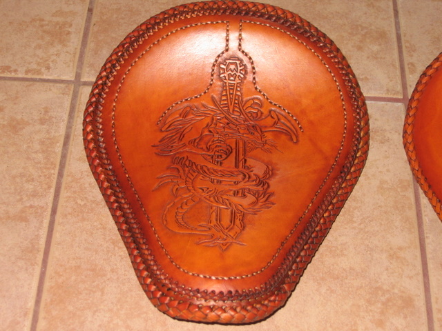

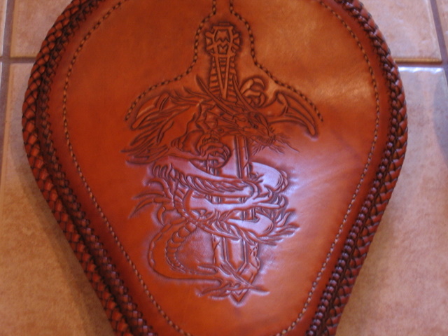

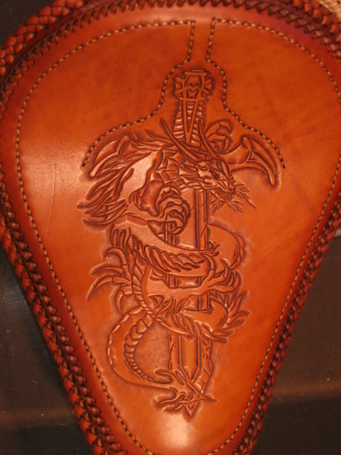

I finally did my new art work seats and I submit them for your inspection...... :)

Hi Ken,
The top and bottom of the seat are totally different shapes. The holes are equally spaced (100 of them) around the outside. Let me see if I have pic of the top and bottom leathers. The lacing style is either double cordovan or basketweave.

Hi Ken,
I'm not sure if it is easier....the large basketweave lace around the edge required 11 hours just to lace it. Beeze says he does an entire seat in 15 hours from beginning to end. So you be the judge....I don't have to wrestle the leather to get it tight but it does require more time.

Thanks Ken and I'm glad you like the seat; but I doubt that you'll be lacing a 36" seat with 1/4" roo lacing at that speed .... the lace has to be pulled very tight to make things lie correctly. My speed on the basketweave is about 3.5" per hour. and the double cordovan about 9" per hour. Things slow a bit when pulling heavy lace through two layers of 9 oz leather.

Johanna,
The holes don't line up perfectly due to the hole size and the difference in size and shape of the top and bottom leathers. The holes (100 of them) are equally spaced around the circumference of the top and bottom as you can see in the pictures. If you want the lace to cover the raw leather edges the holes can't be much more than a hole's diameter apart on the top. This means they are a bit further apart on the bottom. Also the lace is 1/4" kangaroo and there isn't a needle around that would hold it. The 1/4" lace is nearly twice as thick as the 3/16" lace so there is a lot of drag on the lace going through the two 5/32" holes. Not sure what you mean by using both hands. It would be difficult to handle a near 6 pound seat with one hand....I lace in 3-4 foot lengths. Each hole must be enlarged a bit with an awl as I lace around the pan. This is probably the most time consuming thing....but punching a larger hole would be unsightly. Using an awl the hole enlarges while I lace and then contracts a bit when I'm finished. Perhaps I take more time than needed but I think the results are worth it and I haven't found a short cut that works.
