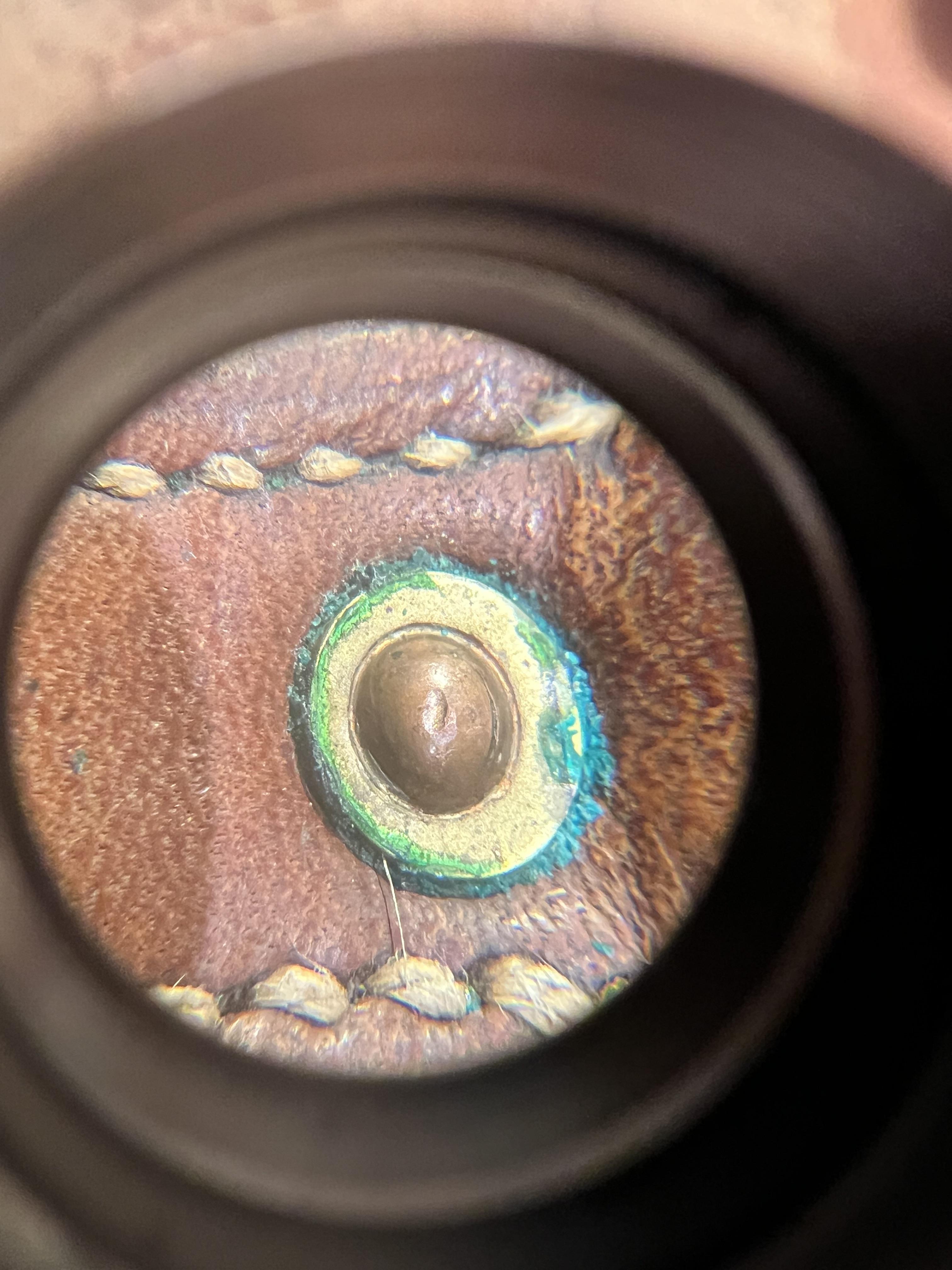

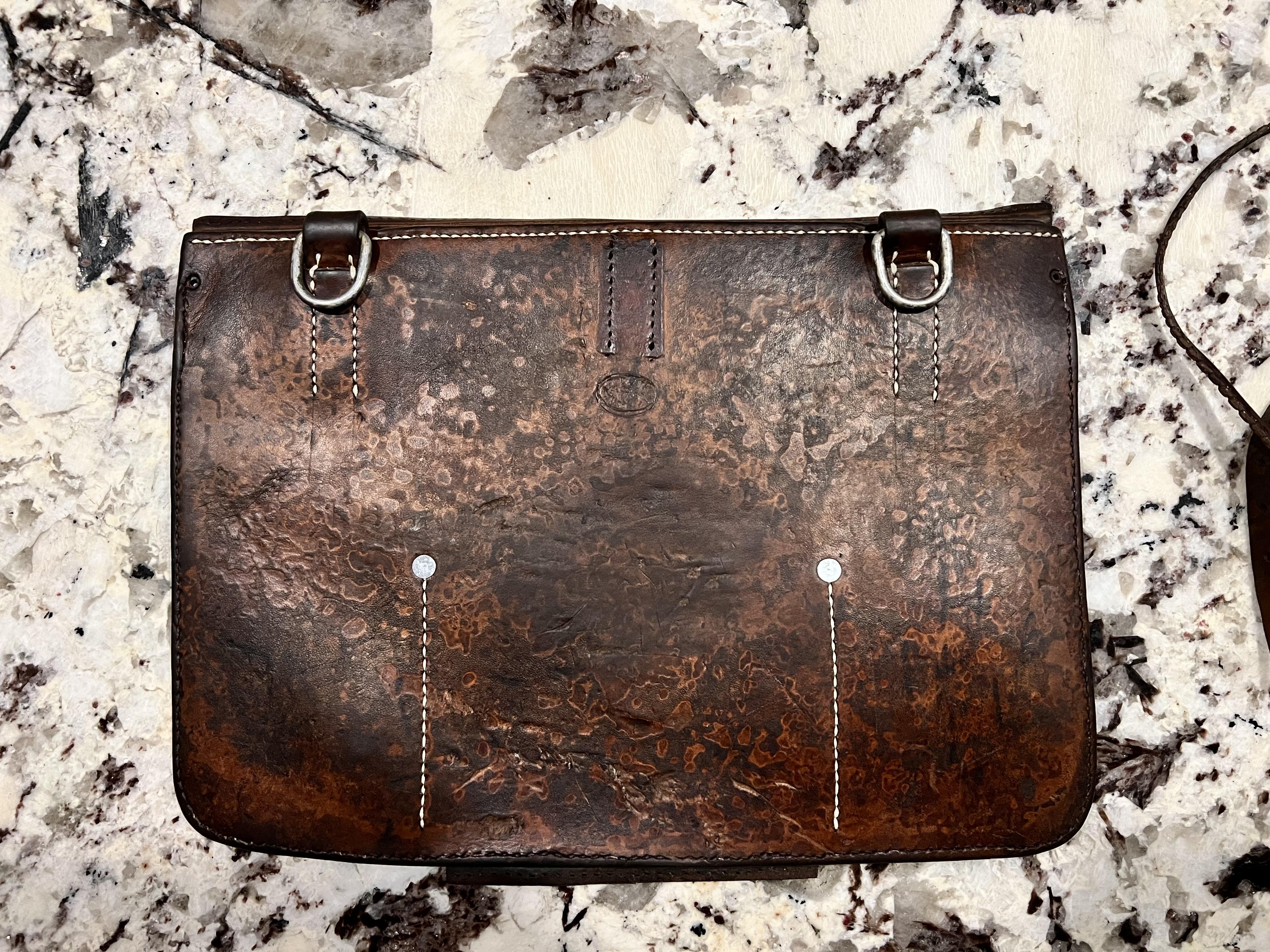

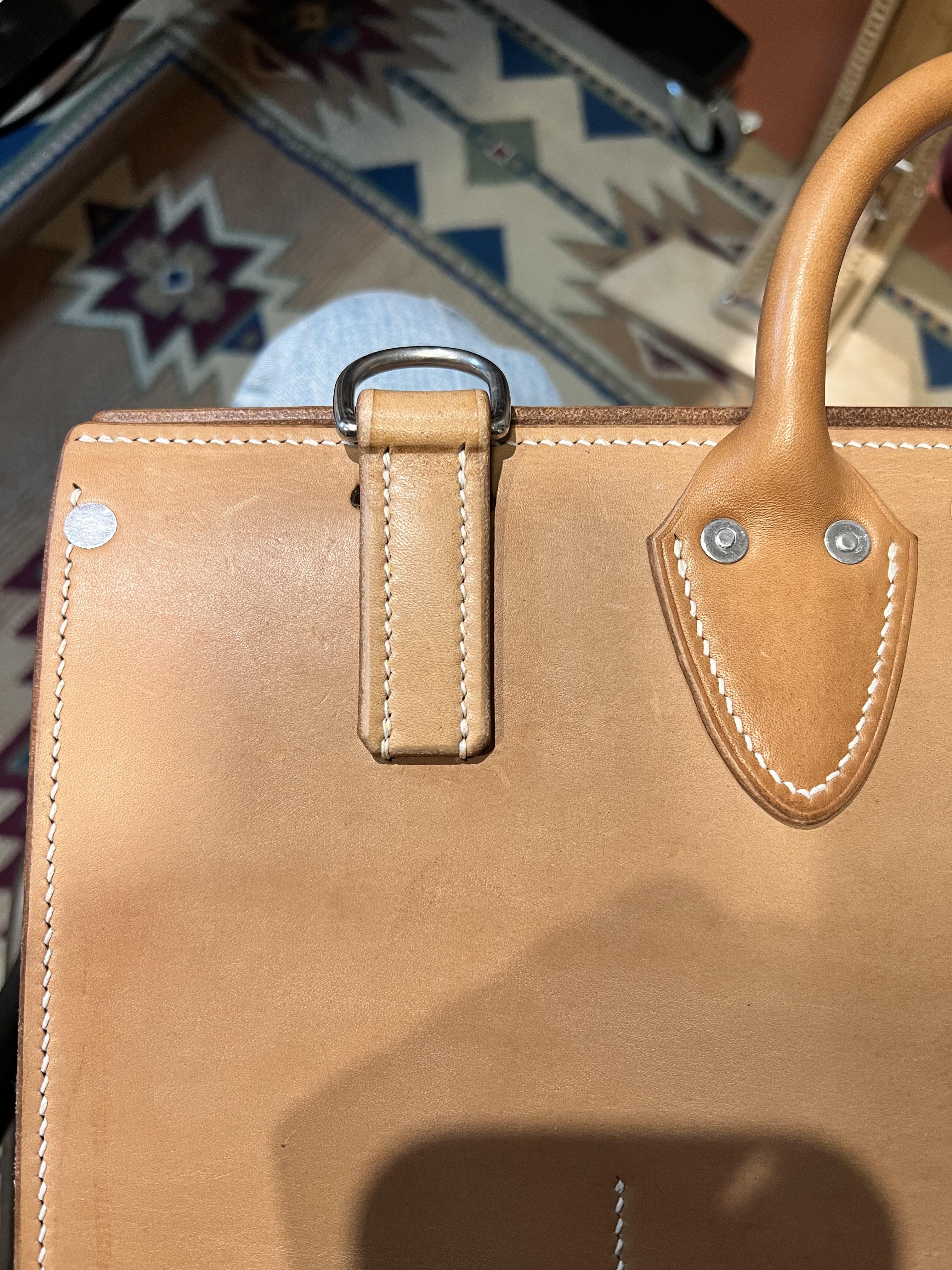

Hello everyone. I’m a bit late to this conversation, but wanted to give some insight on alum rivets.
Ive used the Tandy “decorative” rivets with great success. They are annealed and have no temper which is good when swaging them. I’ve used them in restoration of many Swiss saddle packs, as they all originally came with alum rivets and often buckles, etc.
Speaking of Swiss gear, take a look at Swiss army leathers such as saddle packs and ammo pouches. They all used aluminum rivets and studs. The oldest one I’ve restored was from 1917, and the aluminum rivets or studs were the last concern of mine. Zero corrosion, no breakage. They hold up remarkably well, and the packs from this time are all fairly hard used.
Since the Tandy alum rivets are annealed, this puts them in the 1100 category of aluminum with no alloying agents. This is good because it reduces the amount of corrosion potential. If they were say 7075 series aluminum, you would have a greater corrosion risk. And mixing metal parts will give you mixed results depending on how dissimilar they are (steel vs aluminum for example).
When it comes to brass, followed by copper, verdigris will be an issue especially if the item isn’t used for some time, and an electrolyte (water) is present in the air in high amounts. The verdigris is a reaction with the tannins against the metal, and aluminum does not react to the tannins. The only staining you will have is greying from the aluminum essentially being polished from abrasion by the leather.
I hope this is helpful! I’ve been in aviation for over a decade, working with aluminum extensively. I’ve also attached two example pictures of aluminum fasteners from Tandy, along with a verdigris issue on a pack I’m restoring currently.

Thanks for the info.  I never thought about different alloys reacting in different ways, stuff like that is always good to know.  It would seem that their service life is pretty good if they hold up for over a hundred years.
Posted (edited)
@JDFred
Certainly! Aluminum is pretty remarkable. It only becomes problematic with contact to dissimilar metals, prolonged water contact, and salts. Or a combination of those.
If you ever give them a go and need different head sizes, i would stick with the annealed versions. If they are tempered, they will toenail bad inside the leather since the walls of the hole do not have support against the compression of the rivet. Ive tried mil spec aircraft rivets, and its always a disaster in my applications. I would think if you have enough support around the whole, you could reasonably work with tempered alum rivets on leather.
If you are in need of using different metals for the application, check the galvanic corrosion charts to see if they are compatible, too. Stainless and alum should be okay for a good bit, but ill say that depending on the size difference of the parts, and how far apart on the chart they are, the alum rivets would fail over time.
