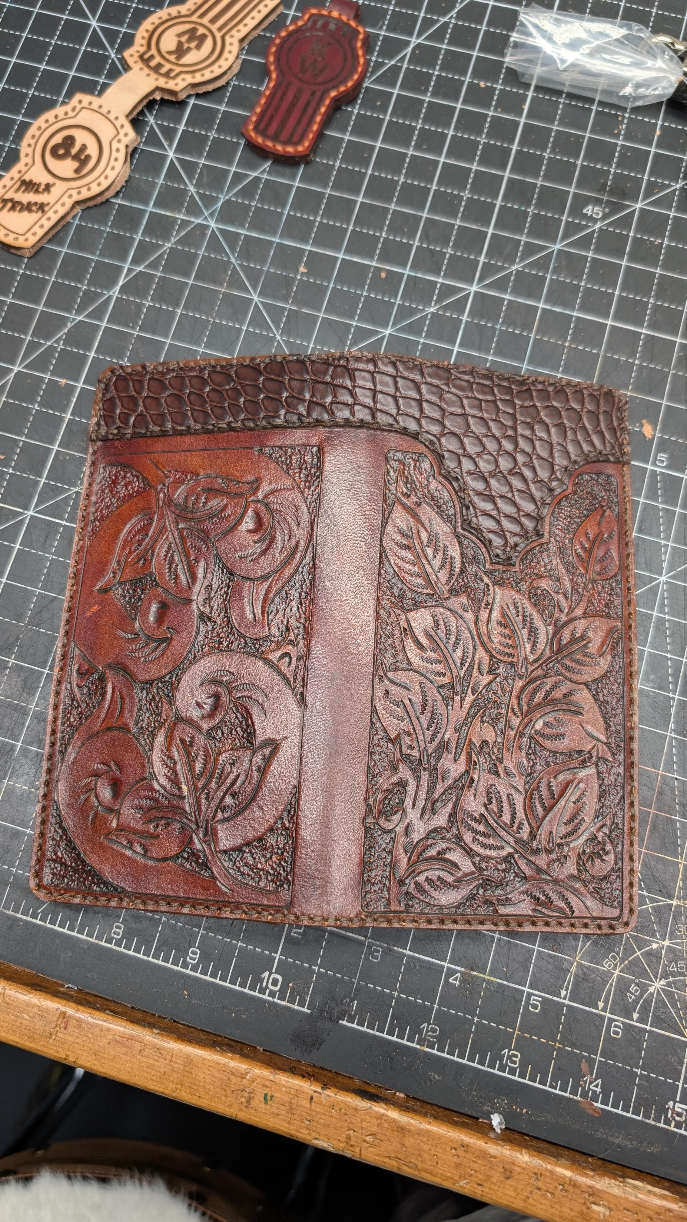

Latest project, long wallet. Hybrid version of my Billy Bada$$ wallet. My customer tweaked Billy to his own liking. Haven't named this one yet! Lmao
Outside is 4/5oz tooled vegtan, dyed English Tan with Bismark antique. Chocolate alligator. First time I've used gator, won't be the last.

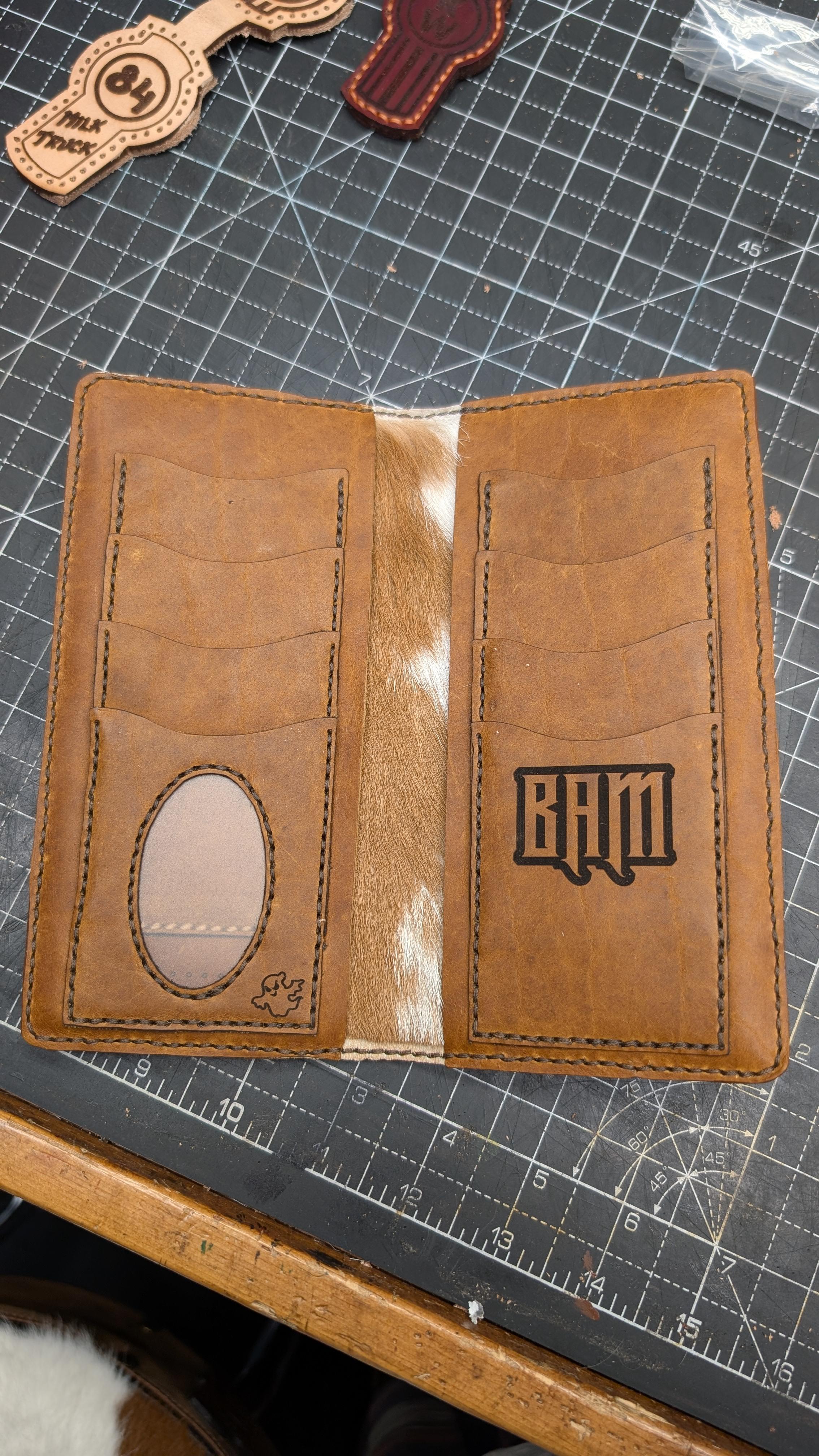

Inside is 2/3oz Bison dyed Peanut. Lined with hair on calf skin.
It absolutely pained me to use edge paint. Bison and calf skin were not cooperating with burnishing. I could have gotten the inside stitch line quite a bit better.
Let me know what you think!PXL_20251009_074128140_MP.jpg.447437737ae9682a367e3e829f508374.jpgPXL_20251009_074135663_MP.jpg.7476329d5c86e06edcf927fd2bc5de02.jpg
