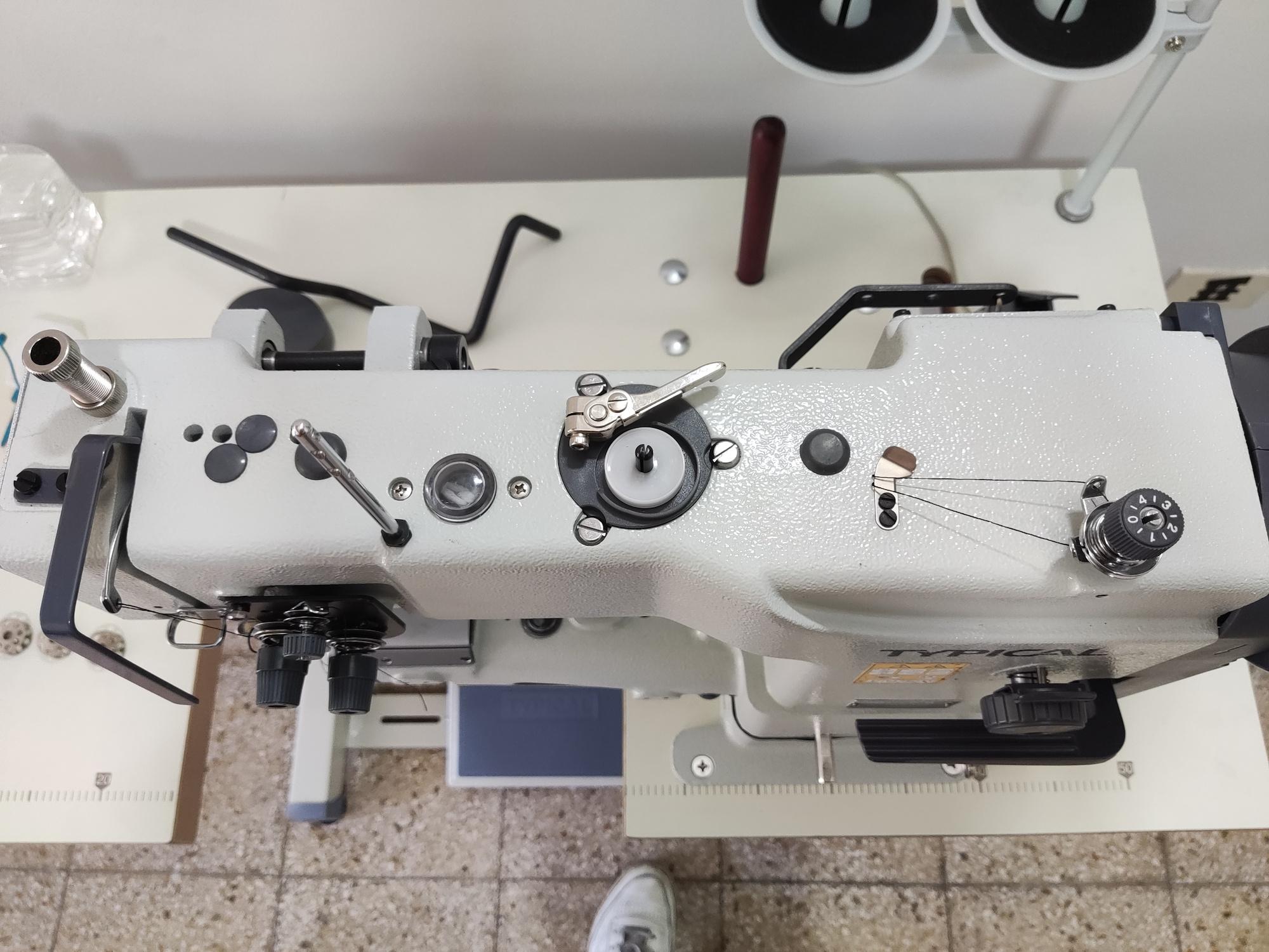

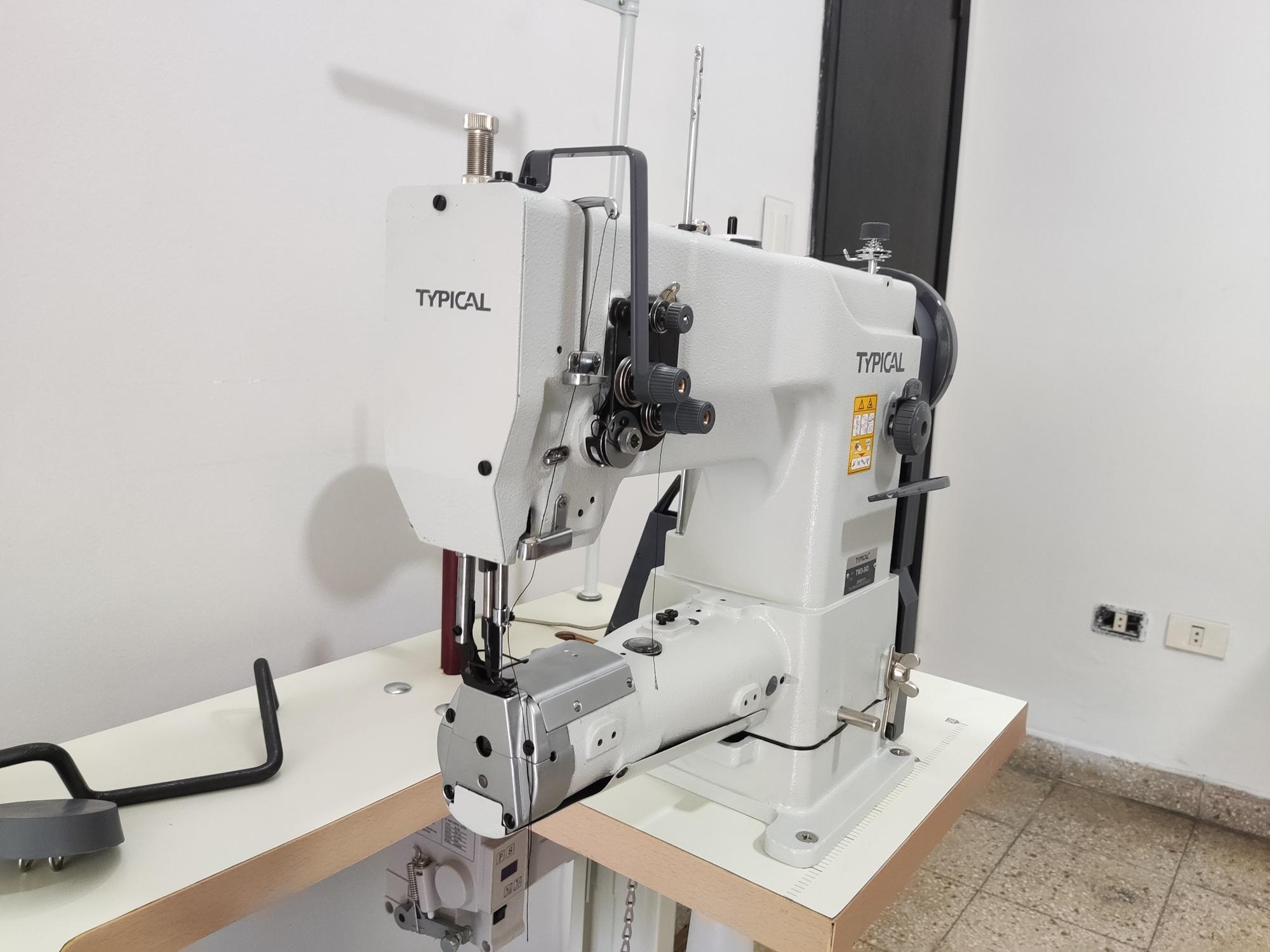

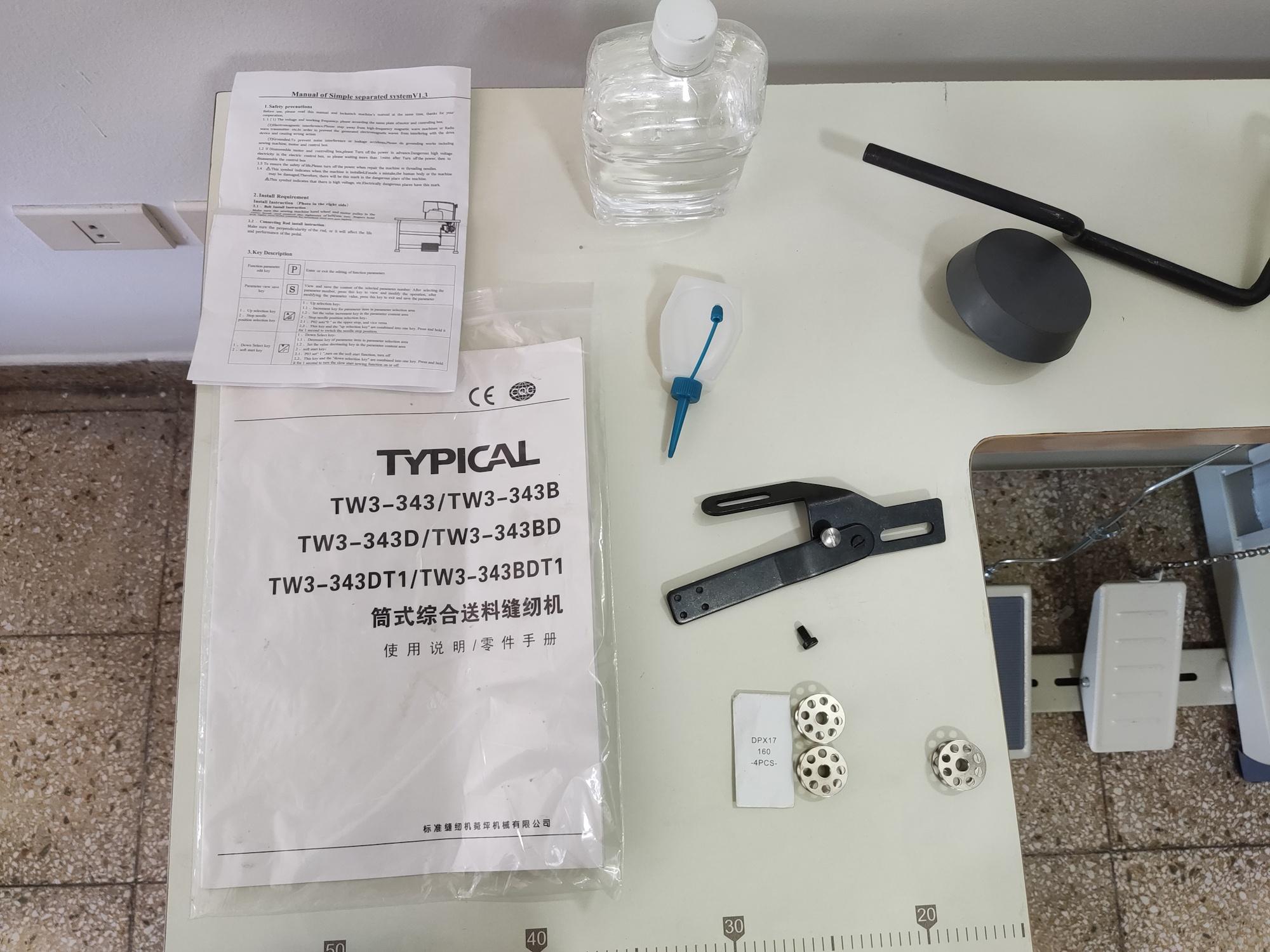

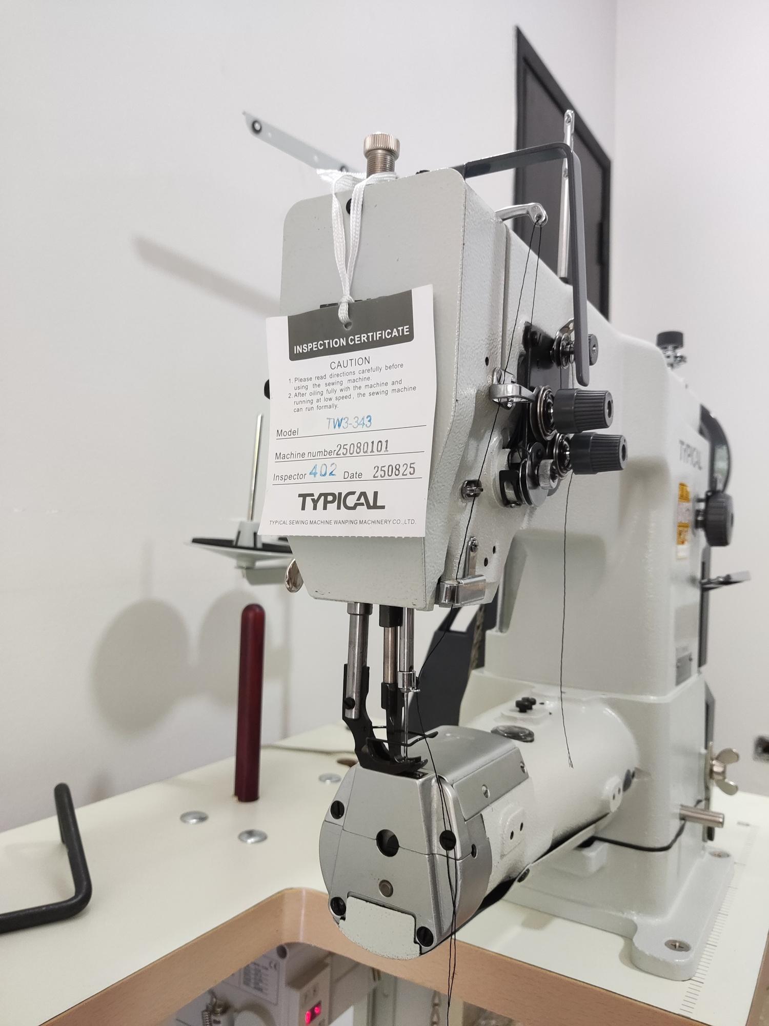

Hello. my machine just arrived! I promised I'd post some pics so here they are. thank you so much for your advice! it ended up costing 2,016 US$
Sadly the smaller table you guys recommended to me has to be imported and it's gonna be prohibitively expensive so I'll pass on that one.

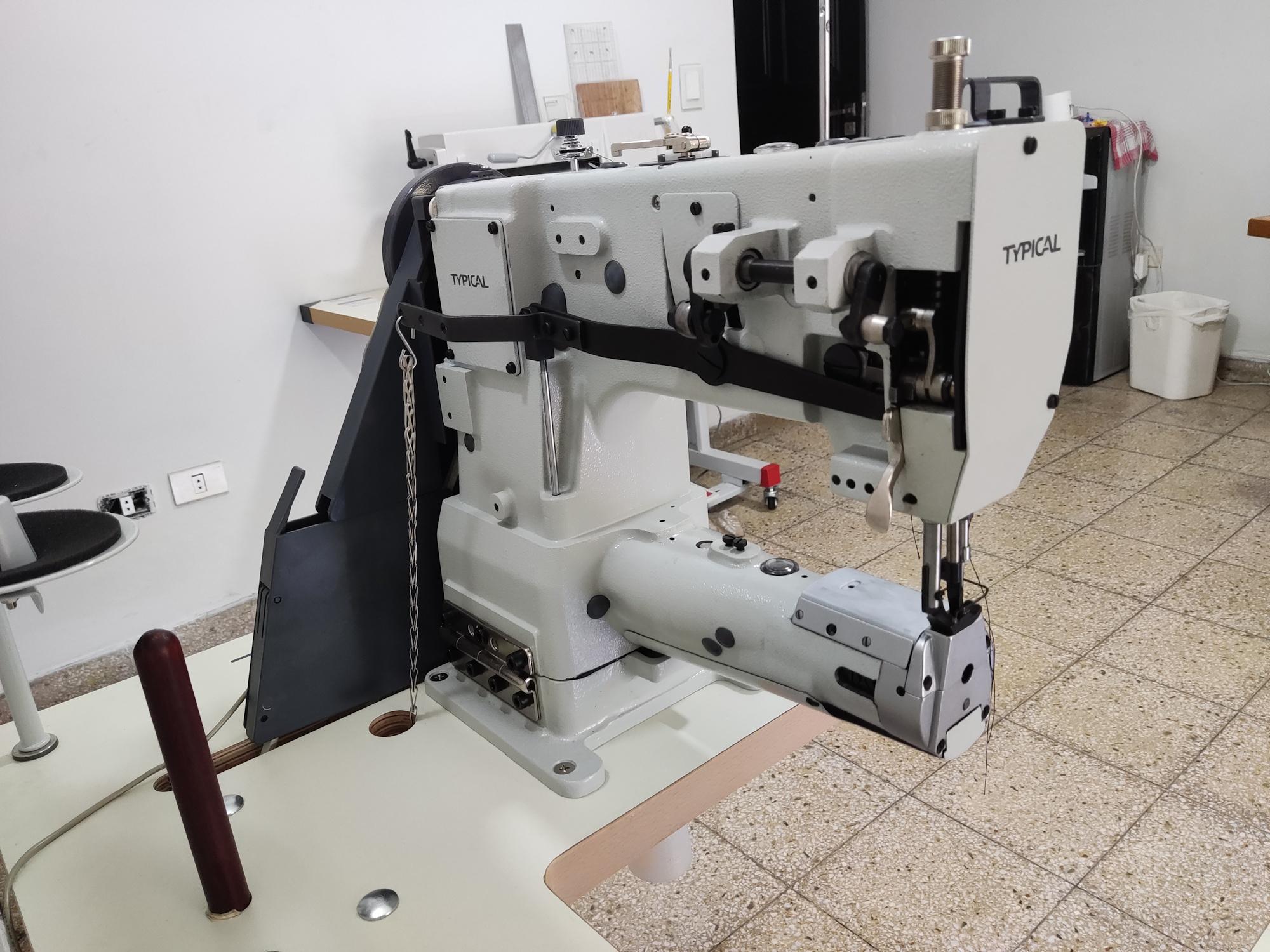

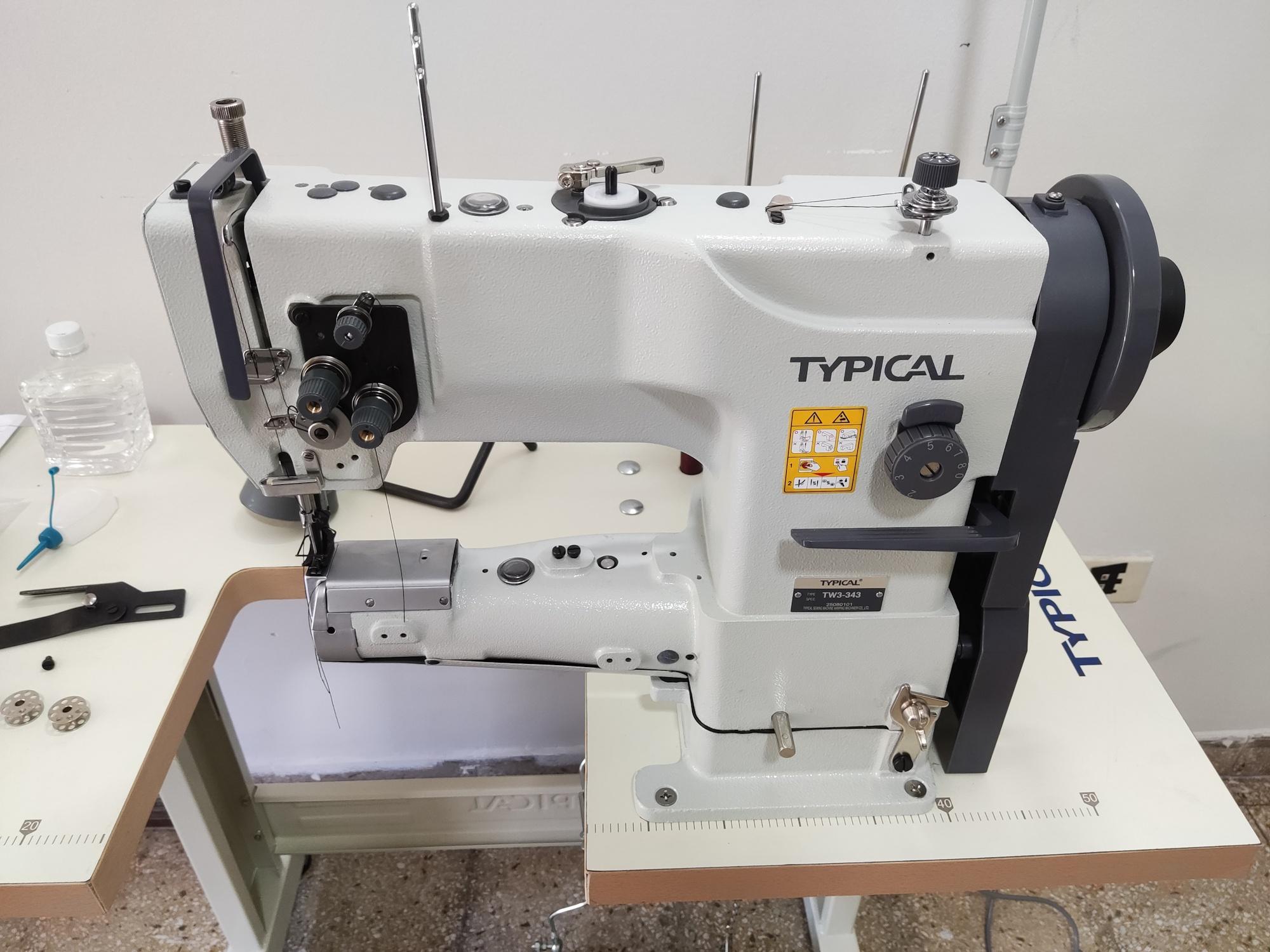

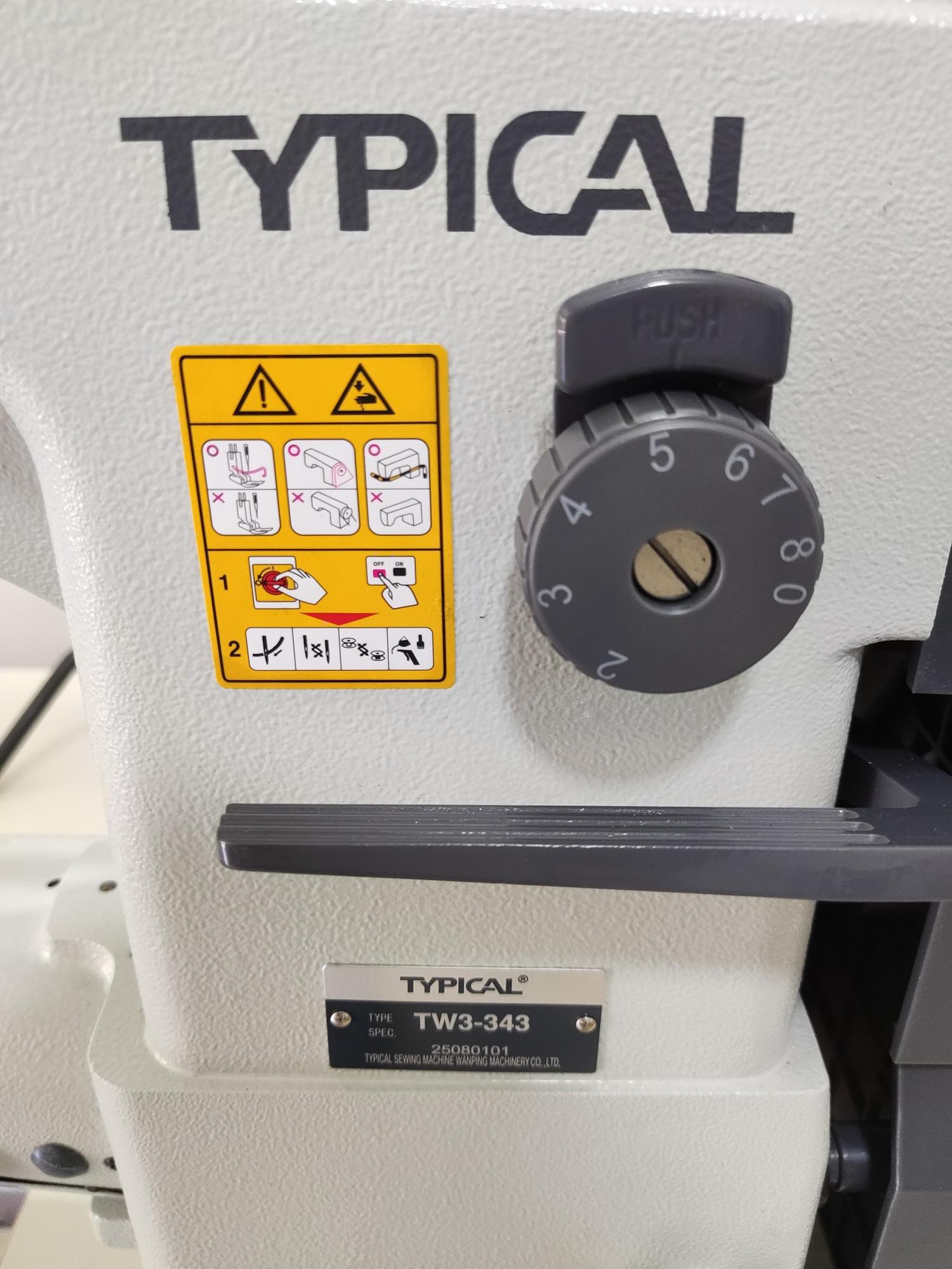

This is a typical TW3-343. I was planning on buying a typical 341 which is a direct clone of the Juki 341 but the seller told me there's a new version, that's why I went with this. It resembles a Juki 1341 but the bobbin winder is in a different place and it has full self lubrication, not only at the bottom like the 1341 AFAIK. it came with a 550w brushless servo motor. if you guys know which clone this machine is from I'd love to know. I have also want to know if this flat bed attachment will fit.

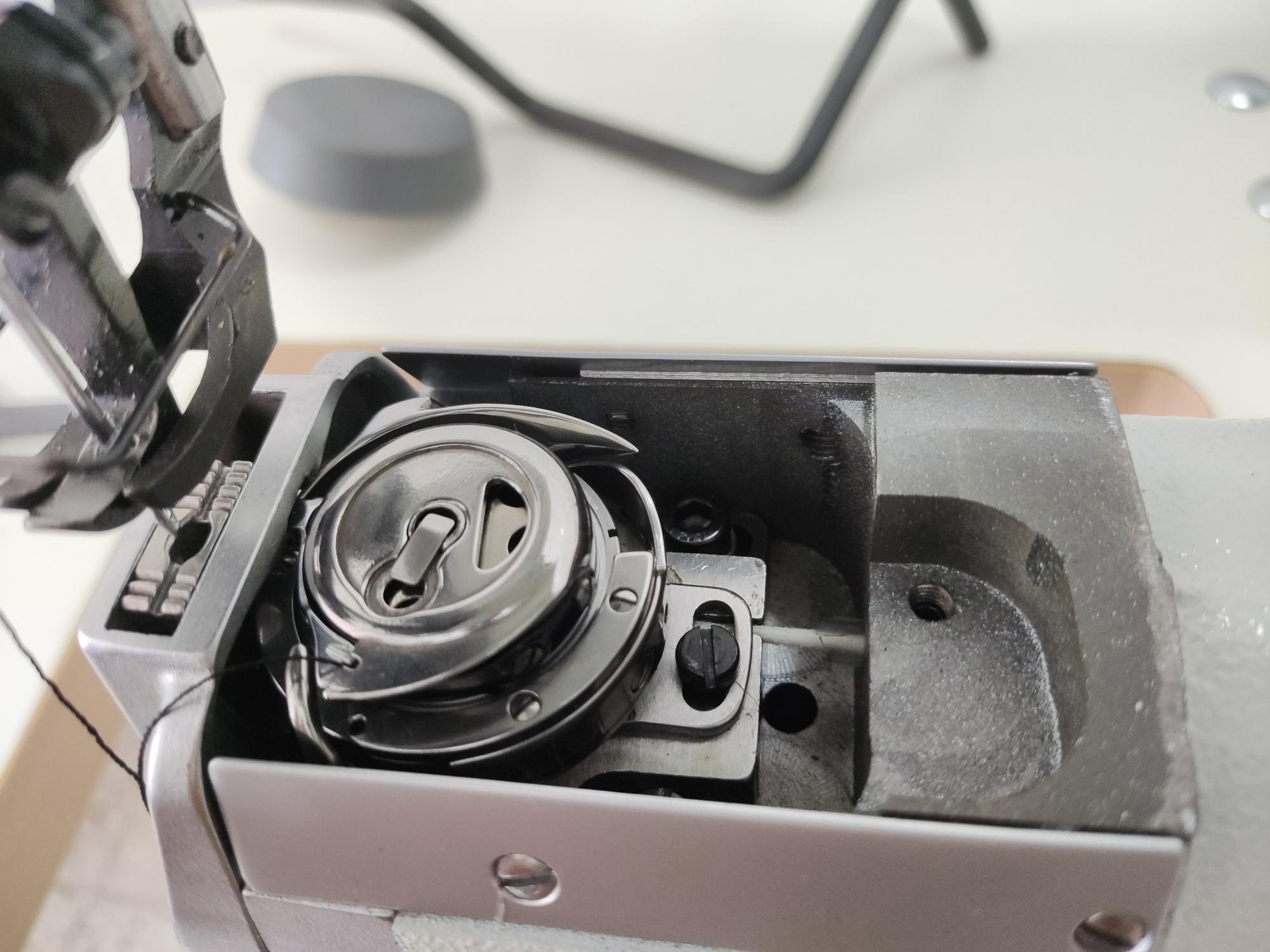

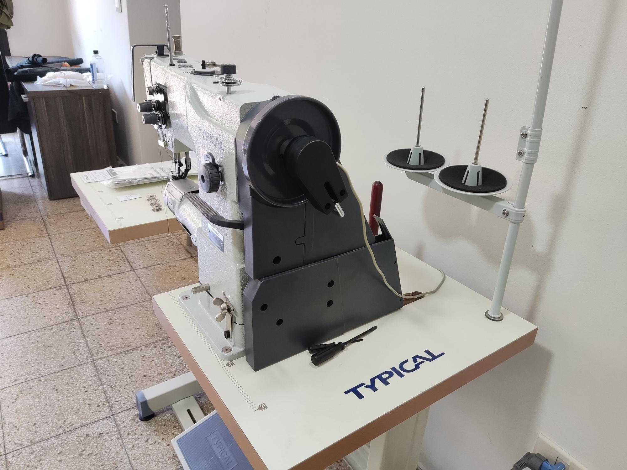

the bobbins are HUGE, bigger than bobbins on my Seiko tf-5/6 and post bed. It also came with a binding attachment which I appreciate.

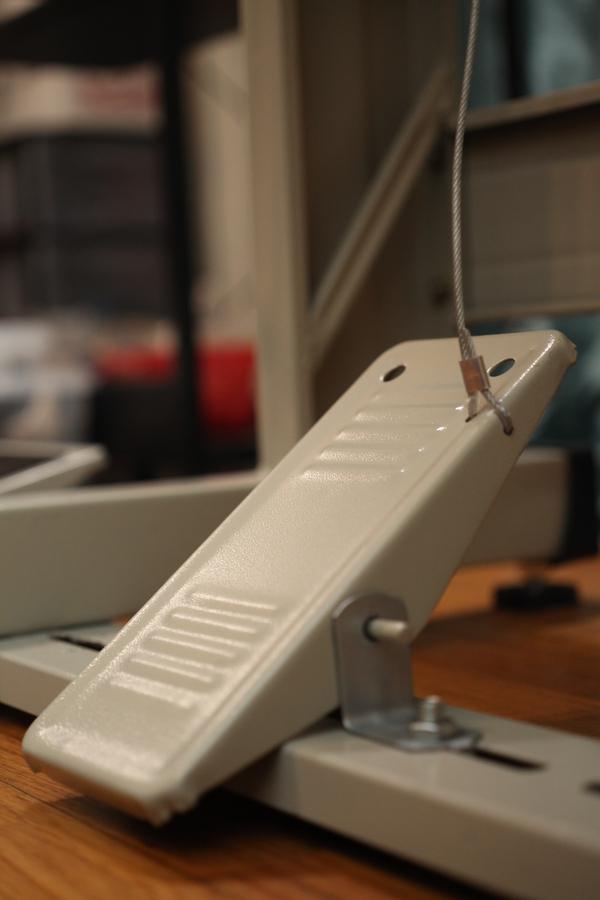

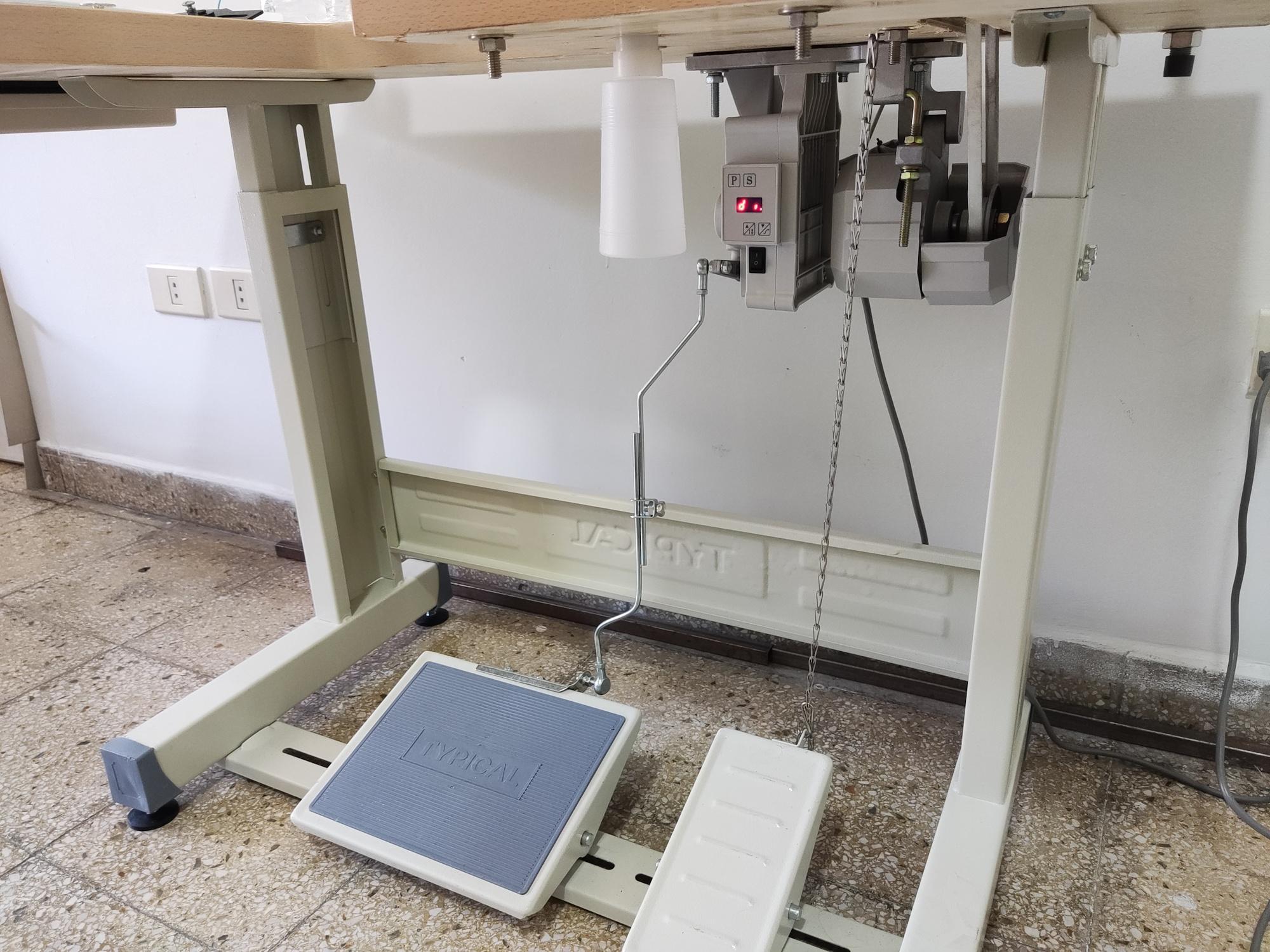

I don't know if this is normal but the pedal that lifts the presser foot is not smooth at all and I have to press significantly harder than the motor pedal, it's uncomfortable to use with an office chair with casters, is this normal? I'm asking because I've never used anything other than a knee lift so I don't know if this is something I have to get used to or if it's something that needs to be addressed.
I have a small speed reducer I bought from aliexpress couple years ago that I could Install but I'm hesitating since I've read some threads saying it doesn't work well with needle positioners.

Looks very sturdy.
What is the diameter of the bobbins?
Your chain is rubbing on the table. If willing, you can drill a hole closer to the machine that will be a straighter shot to the pedal. Also, if the chain still rubs, replace it with a cable, and make a slide for the cable out of some vinyl and grease the vinyl.
Also at the foot pedal end, the chain is installed in the default (but unfortunate) position of out at the tip of the pedal. You probably don't need that much lift. Mine I drilled a new hole a couple inches down from the tip and it gives me enough travel will less force.
Another help is to reduce your presser foot pressure. For very low pressure, I remove the presser foot spring, but on very thin fabrics I need to keep the spring installed.
