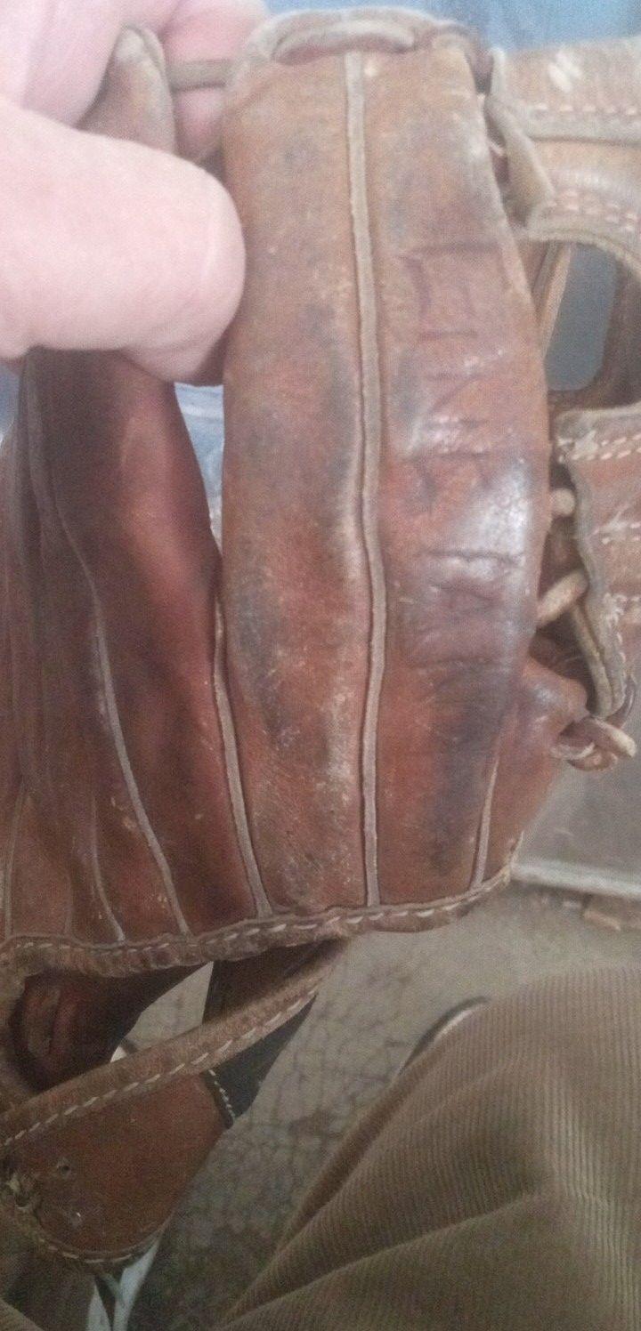

Members joetroba Posted December 22, 2025 Author Members Report Posted December 22, 2025 (edited) I am working on sewing the finger stalls on a baseball glove. Two pieces make up the back of a finger so there is a welted seam directly down the middle of the back of the finger. The two pieces that make up that seam are sometimes not equal length to create a "3d" curve in the back of the finger. I hope that makes sense, kind of hard to explain in words. My initial assumption would be that they would have to be the same length and the actual curve cut into the piece creates that "3d" curve. But I have also been told that it is normal for those pieces to be different lengths to create that "3d" curve. So maybe I am chasing the answer to an incorrect statement, and they both should be equal lengths. Just looking for any advice or clarity. And if anyone has done this before or something similar with another type of project. Edited December 22, 2025 by joetroba Quote
Contributing Member friquant Posted December 22, 2025 Contributing Member Report Posted December 22, 2025 3 hours ago, joetroba said: I am working on sewing the finger stalls on a baseball glove. Two pieces make up the back of a finger so there is a welted seam directly down the middle of the back of the finger. The two pieces that make up that seam are sometimes not equal length to create a "3d" curve in the back of the finger Interesting...Can you send photos of the pieces of leather that comprise a single finger stall? Quote friquant. Like a frequent, piquant flyer. Check out my blog: Choosing a Motor for your Industrial Sewing Machine

Members joetroba Posted December 22, 2025 Author Members Report Posted December 22, 2025 So I am attempting to make a new glove and have been using several older gloves as templates/patterns. I dont have any leather cut at the moment but here is what the piece look like in 2D and then my first attempt at sewing them together. Learning to keep the pieces together and against the guide. No way to glue them so it gets interesting. These two pieces are pretty close in "seam length" but there are others have more difference in length. Quote
AlZilla Posted December 22, 2025 Report Posted December 22, 2025 Interesting project. I see the difference in the 2 lengths, 219 vs 215.72. I wonder if that difference could be in how the old gloves stretched over the years. I've had similar problems trying to use an old hat I took apart as a template. Pieces just don't seem to like up as if expect. Quote “Those who can make you believe absurdities can make you commit atrocities.” - Voltaire “Republics decline into democracies and democracies degenerate into despotisms.” - Aristotle
Contributing Member friquant Posted December 22, 2025 Contributing Member Report Posted December 22, 2025 Did you account for seam allowance? For a non-eased seam, the the pieces will have the same length along the stitch line. (Not necessarily the same length along the outside edge of the leather) Quote friquant. Like a frequent, piquant flyer. Check out my blog: Choosing a Motor for your Industrial Sewing Machine
