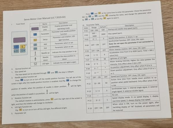

After reading this thread I thought I'd have another go. Another waste of time. Tried every setting with the same results. Everything else works fine except the needle position. No matter what the setting, every time I stop the needle is in a different position,sometimes up - sometimes down and never up/down in the same place either. It goes slow enough that it's more of an irritation than a pain but short of ripping out the speed reducer and replacing the handwheel and motor pulleys, I'll live with it.
What settings did you try for P-15 (Needle Detection Mode)?
Which P-15 did you mean? This one?
Or this one?

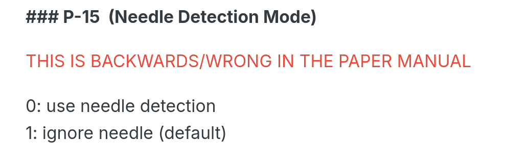

In the Stitchman Servo Motor: The Missing Manual
Specifically this part:
friquant. Like a frequent, piquant flyer.

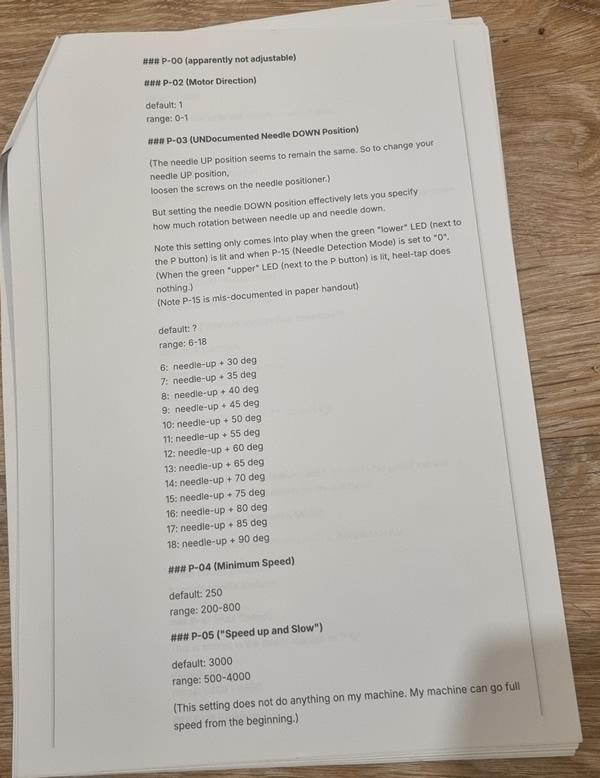

Tried it again with no joy. Then it occurred to me that the braking system must come into this. If I'm stitching slowly the brake is immediate and the needle stops wherever it happens to be in the cycle. If I go fast it wil stop in the down position ( where I want it) most of the time.
