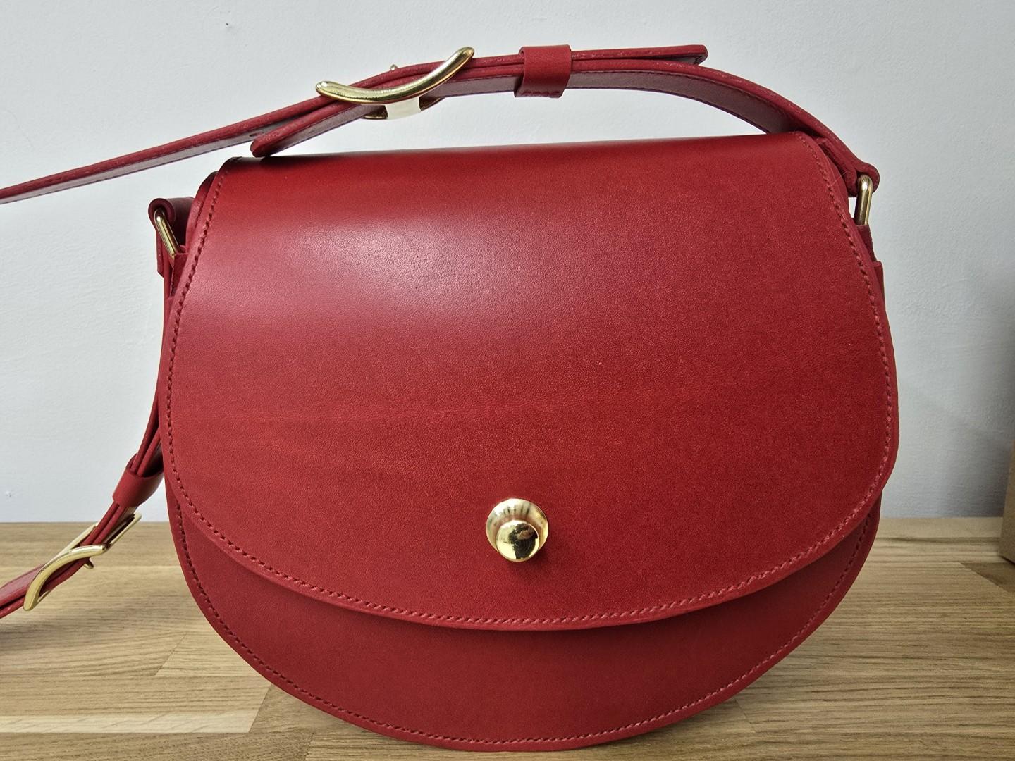

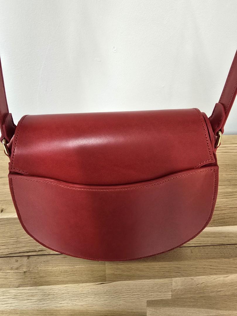

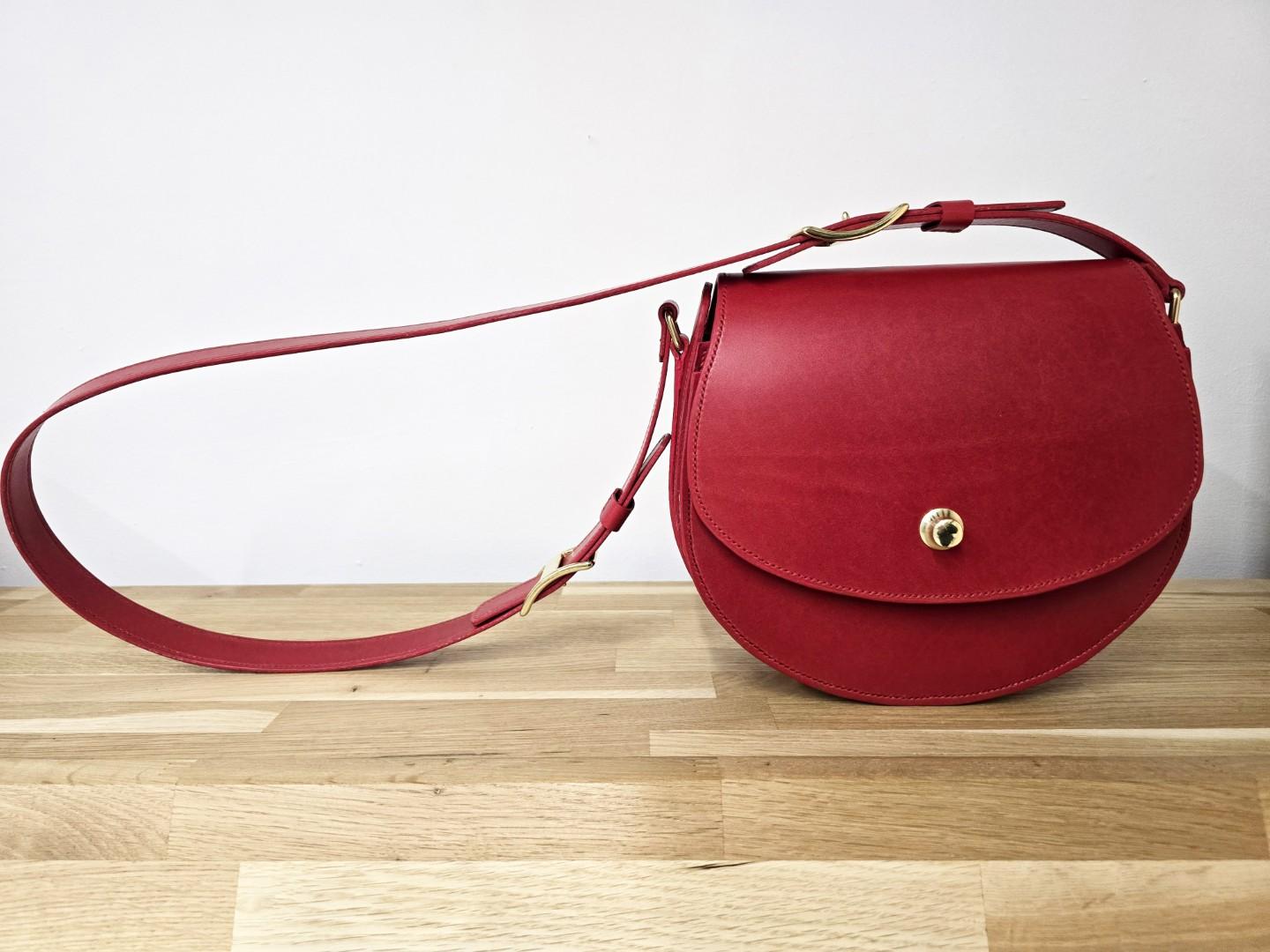

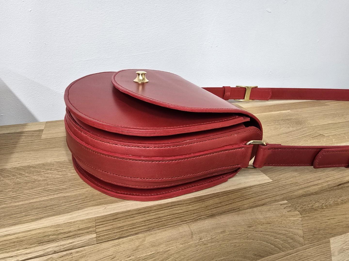

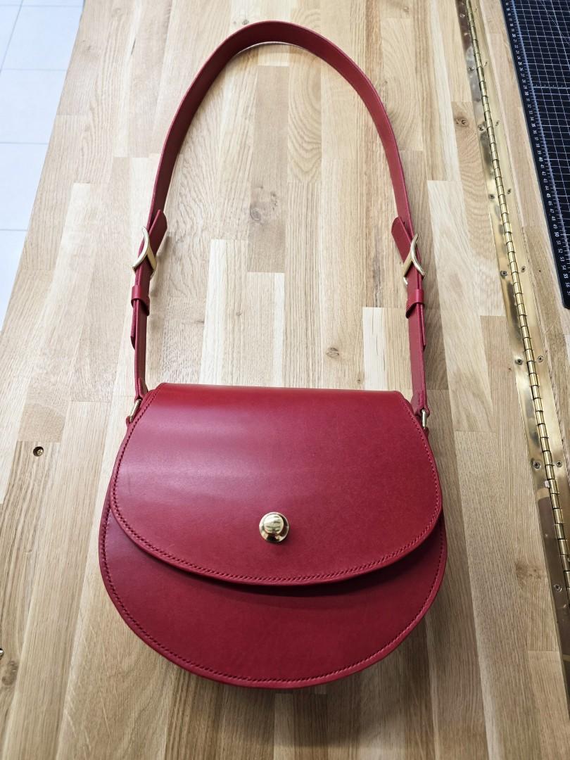

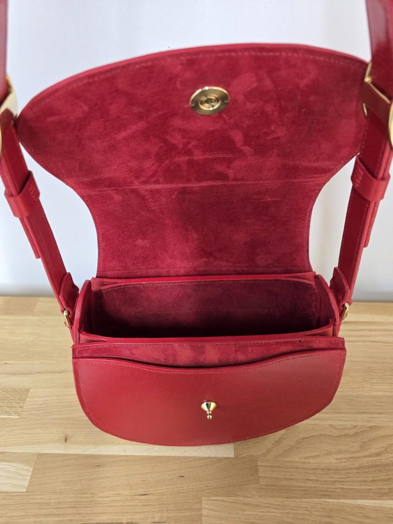

This is a birthday present for my girlfriend. It's made of Sedgwick 1900 collection red leather which is a less glossy finish than their bridle hide. its 2.5 - 3 mm thick. Lining is pig suede, all the hardware is brass and its all held together with about 3000 hand stitches. the bag is about 10 inches across by 8" high. The main compartment is 2".

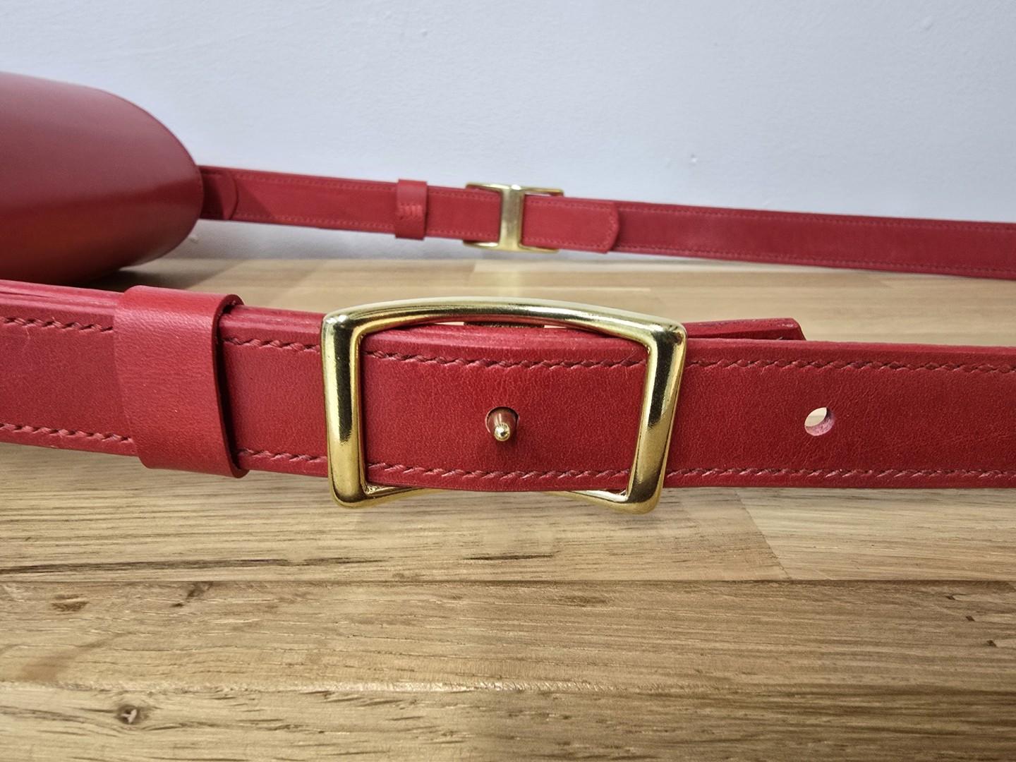

The design is similar to one made by Burberry but horseshoe shaped purses are common enough. There is one main compartment, an internal front slip pocket and an external rear slip pocket, all suede lined. The fastener is a Chinese made alternative to a Loxx fastener and, having used both, I consider these solid brass ones to be far better quality than the German made ones. I like Conway buckles for strap adjustment because they're low profile and don't bite into the strap.

MAN that looks CLEAN.

very good work!
