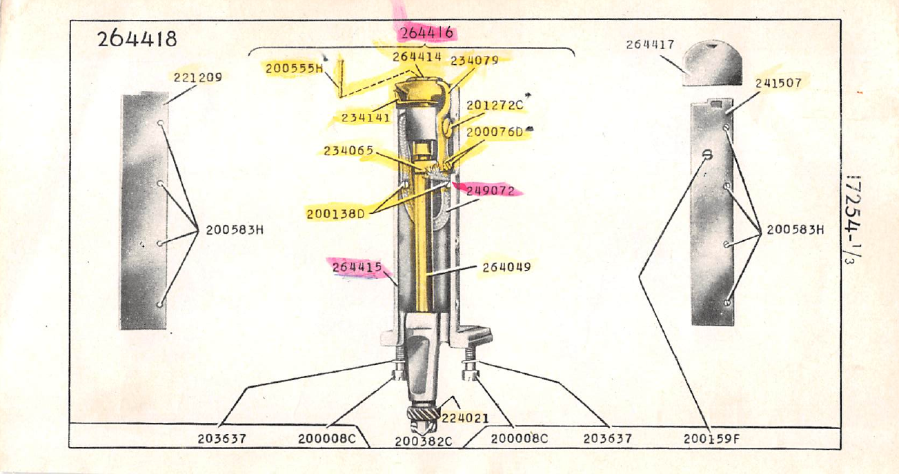

Members Majorpixel Posted 19 hours ago Members Report Posted 19 hours ago I have found and cleaned up a pdf of the manual for the 168w101 post stitch machine. I have attached it for anyone that may want it. Singer168W101.pdf Quote

Members Majorpixel Posted 8 hours ago Author Members Report Posted 8 hours ago Had some trouble getting it to print, so I ran it through a text unblurrer. Might be some typos in this one. Upscaled 168w101 Manual.pdf Quote
