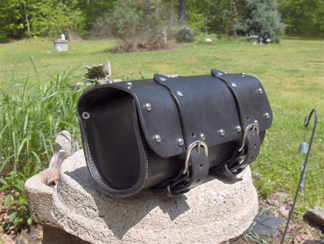

Contributing Member rdb Posted August 16, 2008 Contributing Member Report Posted August 16, 2008 Can anyone post a finished piece that has used this process? here ya go.... Quote
Members BradB Posted August 16, 2008 Members Report Posted August 16, 2008 here ya go.... Thank you! I assume that you submerged all the pieces? Quote
