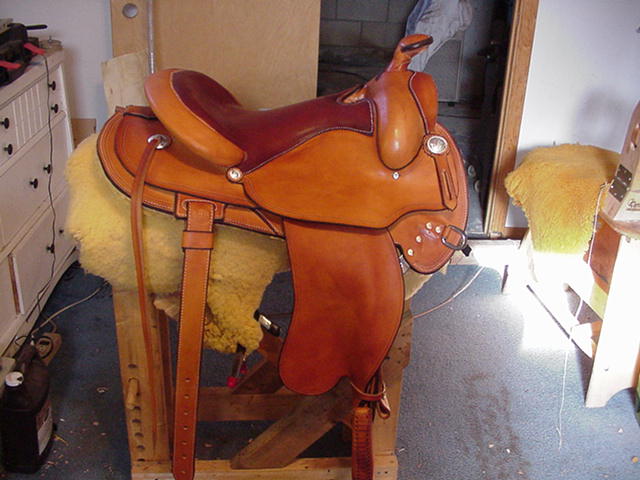

Keith is right. Besure to take your rigging in the rear over the top of the bars behind the cantle. I actually lace both sides together. Here is a picture of one I did that is a slight take off of the sketch that Keith provided.
Happy Trails!
Bondo Bob
